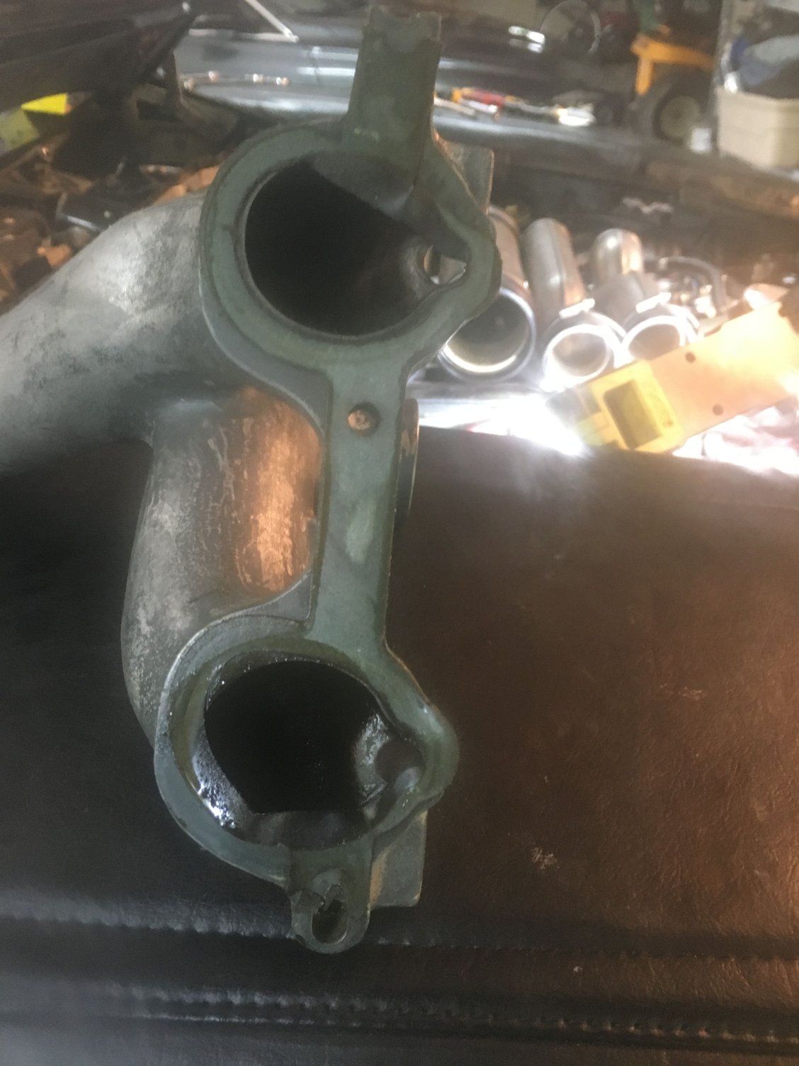

I did did a smoke test today and localized a big vacc leak at the drivers rear intake manifold/head.
When I pulled it apart I found the gasket had shifted, probably during install, and was pushed out of position over seven and eight.
With new gasket on I have steady idle and AFR 14.6.
Should have bought a smoke machine six months ago. They really are quite reasonable now, and I’m not talking paint can conversions.
Anyway, I will update the original lean thread.
I guess I was expecting a higher idle or lower vac readings with a big leak. Go figure.
