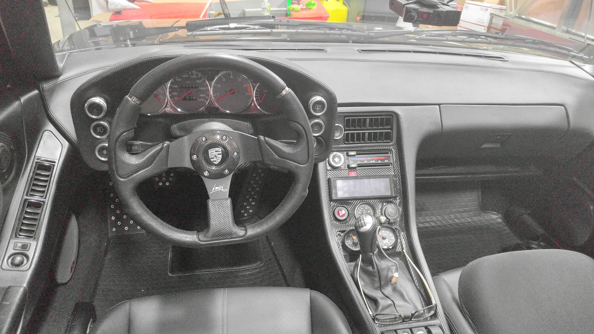

Also, once you have the clear plastic cover off, you can use a headlight polishing kit to make it super clear and clean before putting it back together. That's what I did on mine.
These 2 clusters looked identical before I restored the one that now looks good in the photo. CF background and aluminum gauge bezels are from Jager Engineering.

Wow.
Thanks for the pictures.
