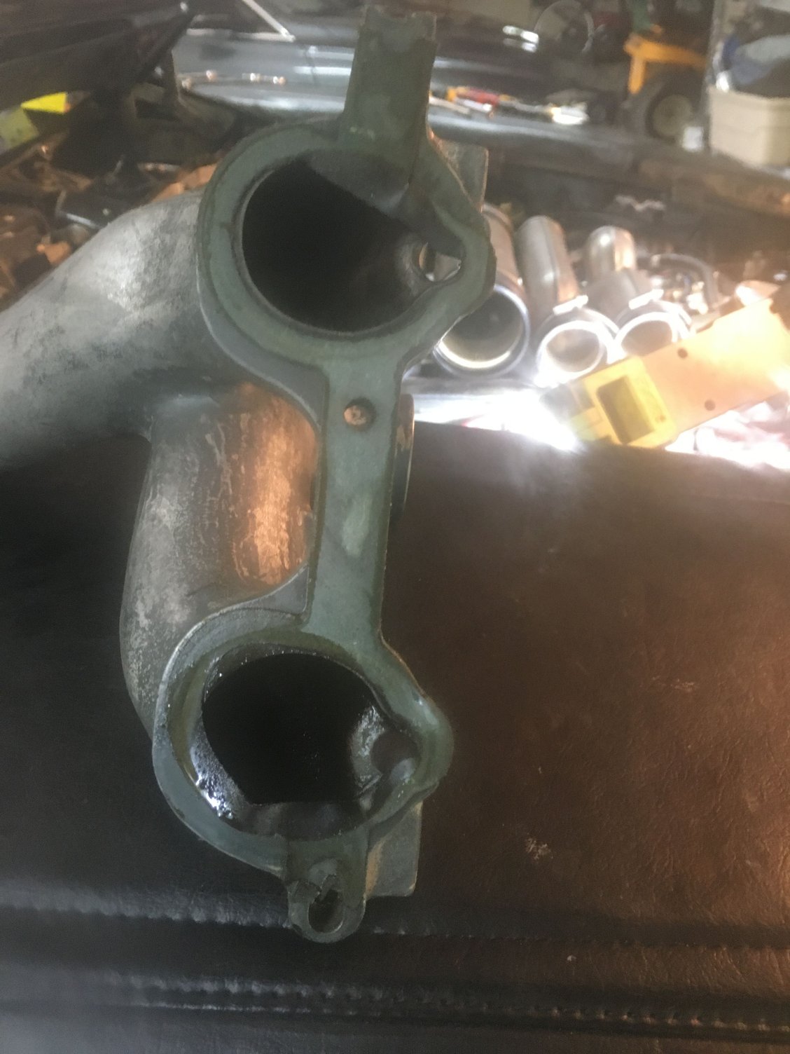

Just for those that may search for lean conditions down the road, thread update.
I ended up wiring a narrowband on the o2 sensor side and got a lot of sweeping but not a consistent lean condition. This seemed inconsistent with the wideband on the other side.
I had done some other parts replacing, ignition modules and temp2, with no luck as well. At that point, I resolved to just systematically check everything, and check one box at a time.
I purchased a smoke machine, they are pretty reasonable now, 150-180 will get you a really good unit. I saw a pretty big leak coming from the driver's rear intake gasket area (also wideband side). Surprised because the idle speed was really not affected, but go figure.
As I pulled off the intake, it was apparent that the rear of the gasket had shifted. I assume during my last installation. Nobody to blame but myself.
With new gasket, AFR was dialed in and no further concerns.

The '85/'86 intake manifolds are very prone to warping, especially the '85 and early '86 models that used the paper gaskets, from the factory. The ears where the bolts are pull down, causing the distortion.
I surface the manifolds and use the later metal gaskets with the integral "O" rings. Yes, the gaskets are a bit pricey, but they are very durable and the manifolds won't warp, because the metal gaskets have no "give".
Those are nice. I should have used those again.
