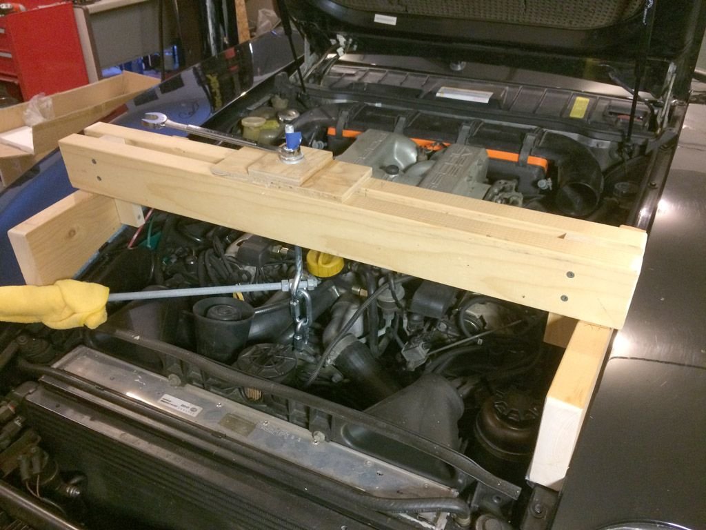

Since I did mine in what was normally my woodworking shop, I decided to make a proper furniture-quality version, with curved and padded fender supports. No nearby HF at the time.
Someone gave me an important warning: lifting the engine too far can mangle unseen stuff in the rear, including the O2 sensor, if I recall.

Nice job Curt. I did something similar. Two support bars and not nearly as pretty.
Good luck,
Dave
