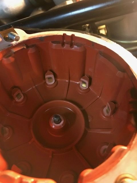

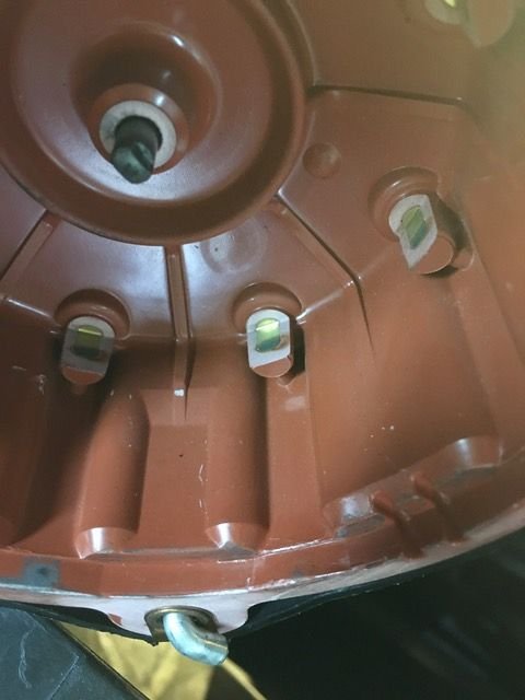

OP in the picture Alex posted you will see that orange dust on the fingers of his distributor,
what has been happening is the fingers are slightly bent and will rub on each other,
this could be from worn bushing in the dizzy body or from someone bending the fingers ,
the Roll pin is in the shaft cutout and its only visible when the C clip is removed ,
but you will be able to tell if its missing if you can spin the fingers on the shaft .

Something else I noticed was the contact point in the cap seems to be right at the end of the brass. Is this normal.

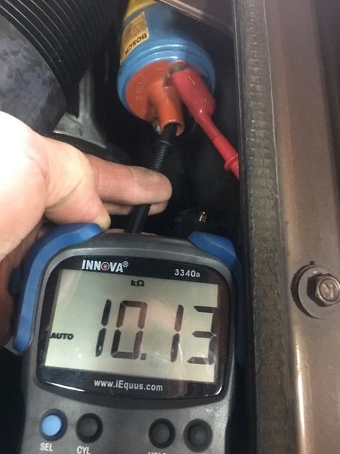

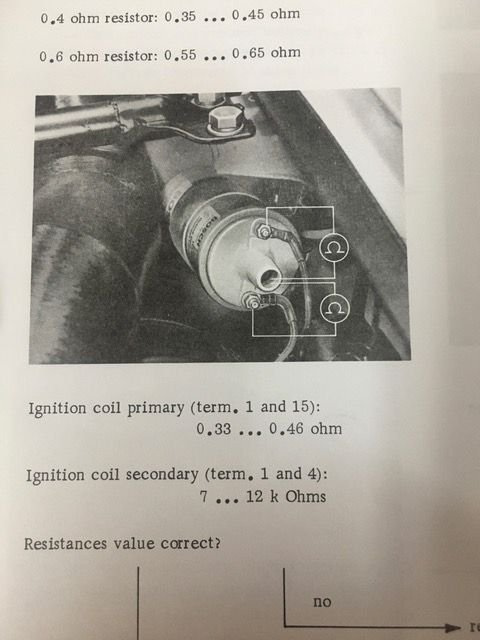

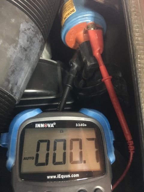

Well Im still trying to track this down. I have taken the distributor apart and cleaned and lubed everything. I think that the very small amount of play is probably just fine. This past weekend I did some further testing, including using my new Gunsone Color tune to check my A/F mixture. This worked very nicely and was very simple to use. The mixture was defiantly out of spec. The other items I checked were the coil and the 2 resistors, both of which also seemed to be out of spec. Here are a few photos. As you can see the 4ohm resistor is reading 0.8 and it should be between 0.35 & 0.45. Also the Ignition Coil primary reading between term. 1 & 15 is reading 0.7 and it should be between 0.33 & 0.46. Both these items seem to be out of spec and I should replace them, but are they the culprit ? One other thing I noticed with the color tune plug in place, was that every once in a while there was what appeared to be a missed spark - it was very random though.

Check that you have the correct coil in there. That pretty new blue one may be a "hi perf" replacement on a different car.
When testing the resistors, you'll want to remove one connection from each. Then start by touching the two test leads together to verify the resistance in them before testing the resistor. The test leads on my Fluke might give me a 0.2 Ohm reading when shorted together. If I test the resistor and see 0.7 Ohms, I subtract the 0.2 probe resistance number from the measured number to determine the value of the resistor alone. I don't know if you have the option of forcing the range a little lower, so it offers more decimals. At these extremely low resistance numbers, rounding by the meter becomes significant.

Dr. Bob - (thanks as always for you help and advice) although the coil may look "new" in the photo, I'm pretty sure its original. Definitely does not look anything like new in real life. I will verify resistance on the tester and then re check the resistors removing one wire first.
I guess my main questions is, even though both these items tested out of spec, do you think either of them being off - is enough to cause the miss fire ?.

Thanks for putting me straight on this. I checked my tester and it too measured a resistance of between .2 & .3 when shorted together, so after removing the coil and resistors from the car and re testing, I think they are actually all within spec.
