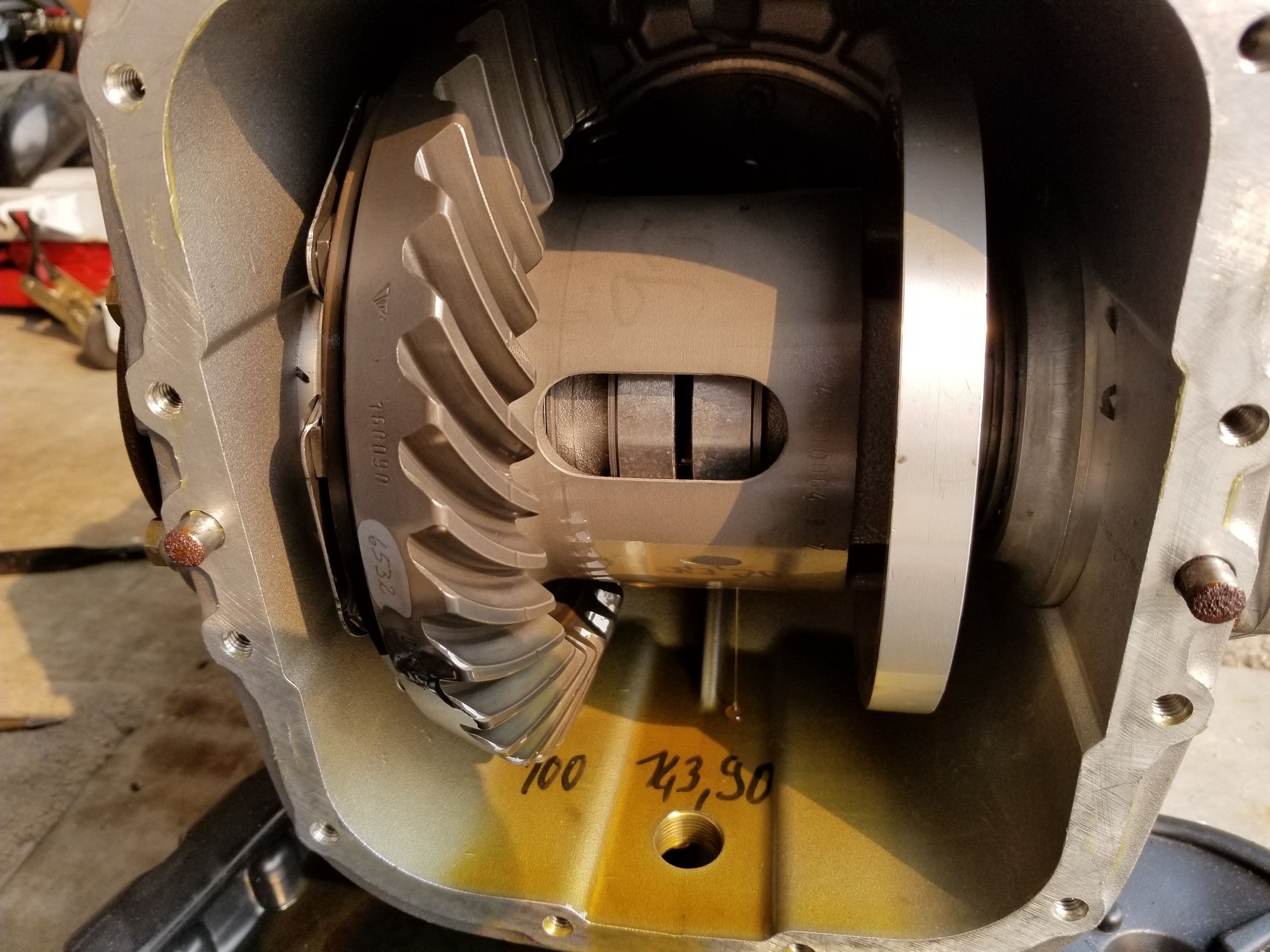

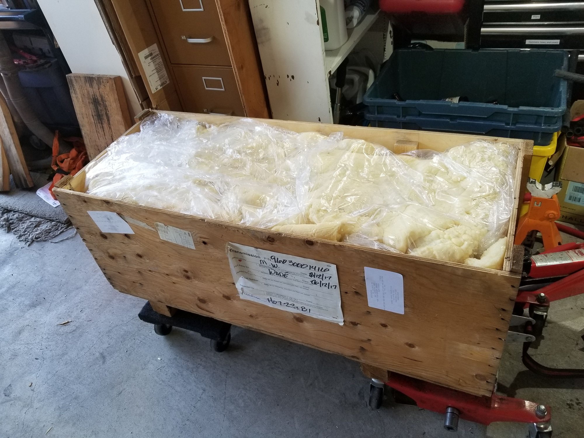

I should have reported this here earlier. My trusty 1989 S4's trans began to fail last year at about 280K miles. A rebuild was certainly long overdue, but in my current living situation I had no way to leave the car on blocks while the trans was out and away being rebuilt. I tried a few repairs on my own, but the ultimate solution came when Roger announced that he had purchased several NOS 1989 auto trans (located by Don Carter). I inquired about them and managed to get one from Roger for a remarkably reasonable price, a small fraction of Porsche's $17K list price. In August, not long after I placed the order with Roger, it showed up. A tag on the trans indicated it was assembled in July 1989. The crate was clearly original and untouched after all these years. My longtime local 928 buddy, George Suennen, stored the trans in his garage until we could do the swap there over 2 days in October, with assistance by another local 928 buddy, Mark Gang. The limited slip diff was full of fluid while the trans had been drained. We removed the diff cover to inspect it (pristine!), filled it with Fresh Mobil 1, replaced the torque converter seal, pan gasket, filter and trans fluid with Dexron VI and completed the swap. After we got the fluid level adjusted, we went for a test ride. FLAWLESS! So, after sitting for many months while I pondered how to deal with my failing trans, the old 89 is back on the road. I'm still chasing a few other niggling problems, but the trans issue is history.
