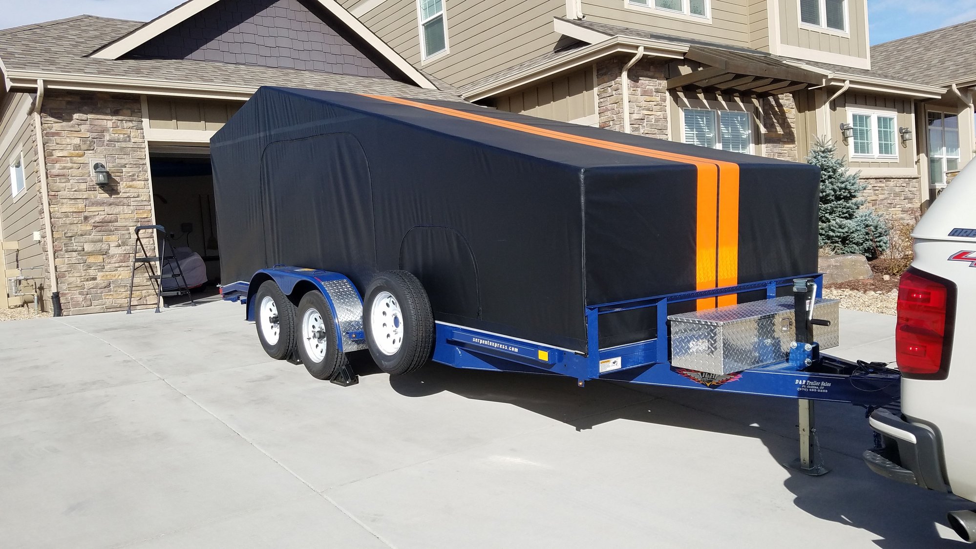

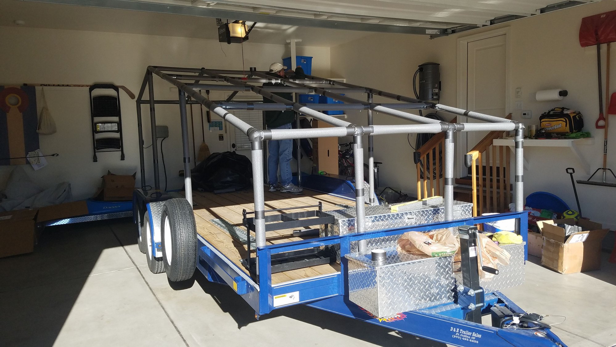

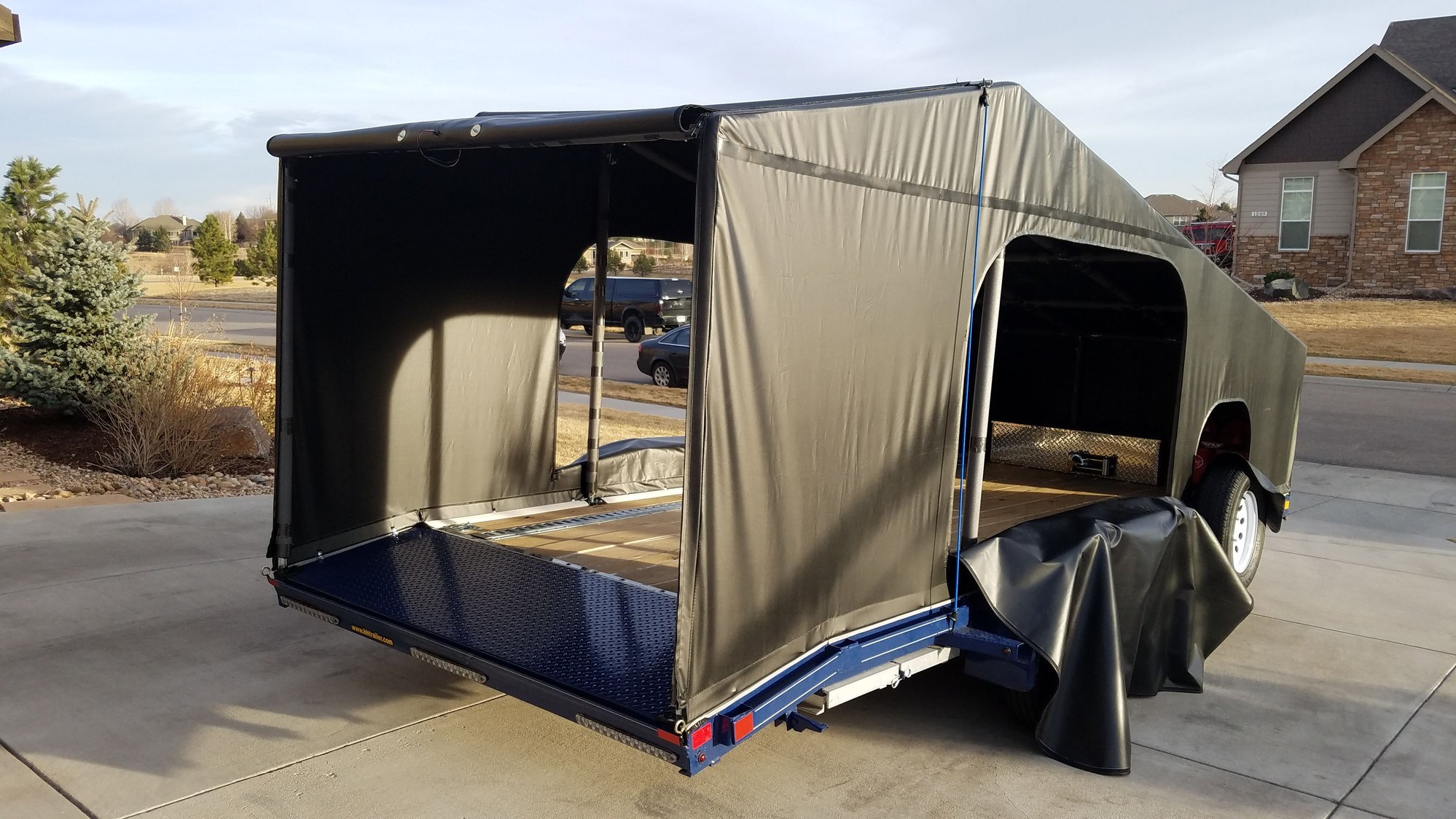

Serpent express will make you a custom soft side cover. I DIY'd one on my old steel trailer. I no longer own this trailer, traded up to a proper enclosed as I progressed in the hobby (DE to racing), but when I had it the setup worked well. Took about a day and a half to install w/ one helper.
https://serpentexpress.com/home
Here are some pics of the one I had:

Serpent express will make you a custom soft side cover. I DIY'd one on my old steel trailer. I no longer own this trailer, traded up to a proper enclosed as I progressed in the hobby (DE to racing), but when I had it the setup worked well. Took about a day and a half to install w/ one helper. https://serpentexpress.com/home
Their web site says they no longer offer the soft side cover, due to severe supply chain issues. But thanks for your reply.
That's a bummer. I was unaware. It was a unique product.
