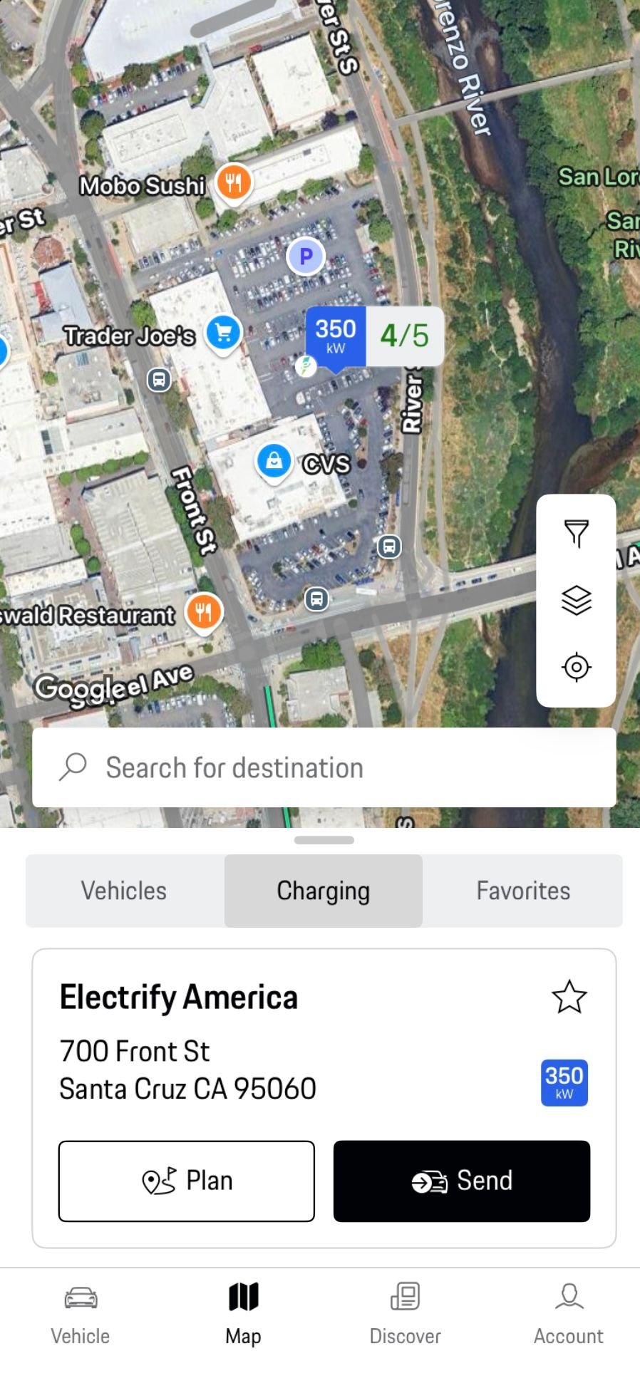

in the photo below I've found/selected the EA station in Downtown Santa Cruz - you can see that 4/5 stalls are available, and if you tap on the EA station listed at the bottom off the screen you can "drill down" and start a charging session - this is typically faster/easier than waiting on hold w/Customer support - of course plug&charge is the ideal way to start a charging session, but not always possible - good luck YMMV!! screen shot is from the myPorsche app on iOS - should be similar/identical on Android!
Are you saying touch the white area of the screen at the bottom where the words "Electrify America" are? I think the "Send" button just sends the selected EA station address to the PCM for navigation.

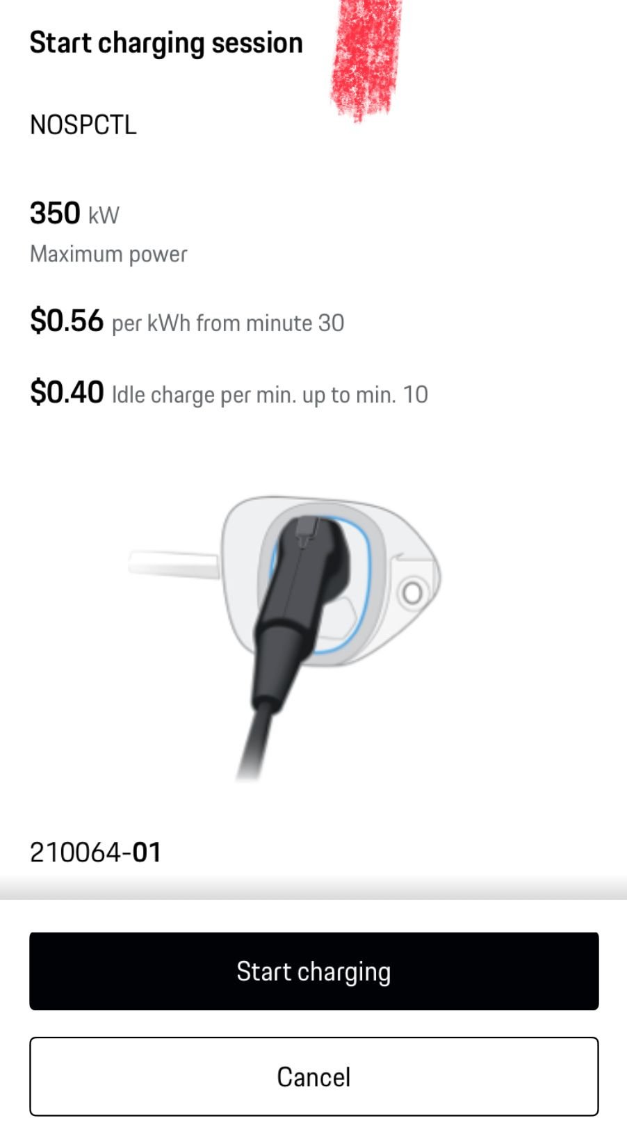

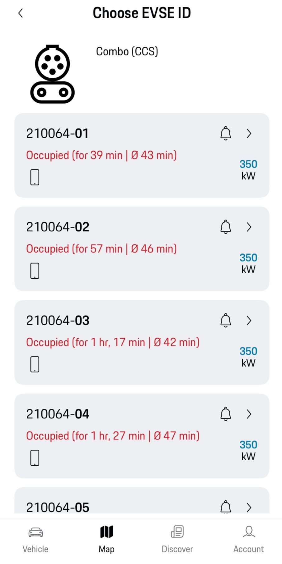

yes the whole bottom in this mode is a button on screen - you simply tap the entire location button at the bottom of the screen and that will get you to the next step…here are the next 3 screens and eventually you get to a 'start charging" button - you can try it for yourself right now in your own app - you don't need to be anywhere near a charger or even driving your car …

"choose" the stall number next…
now you can click the "start charging sessions" button - and grab the cable and plug in…
