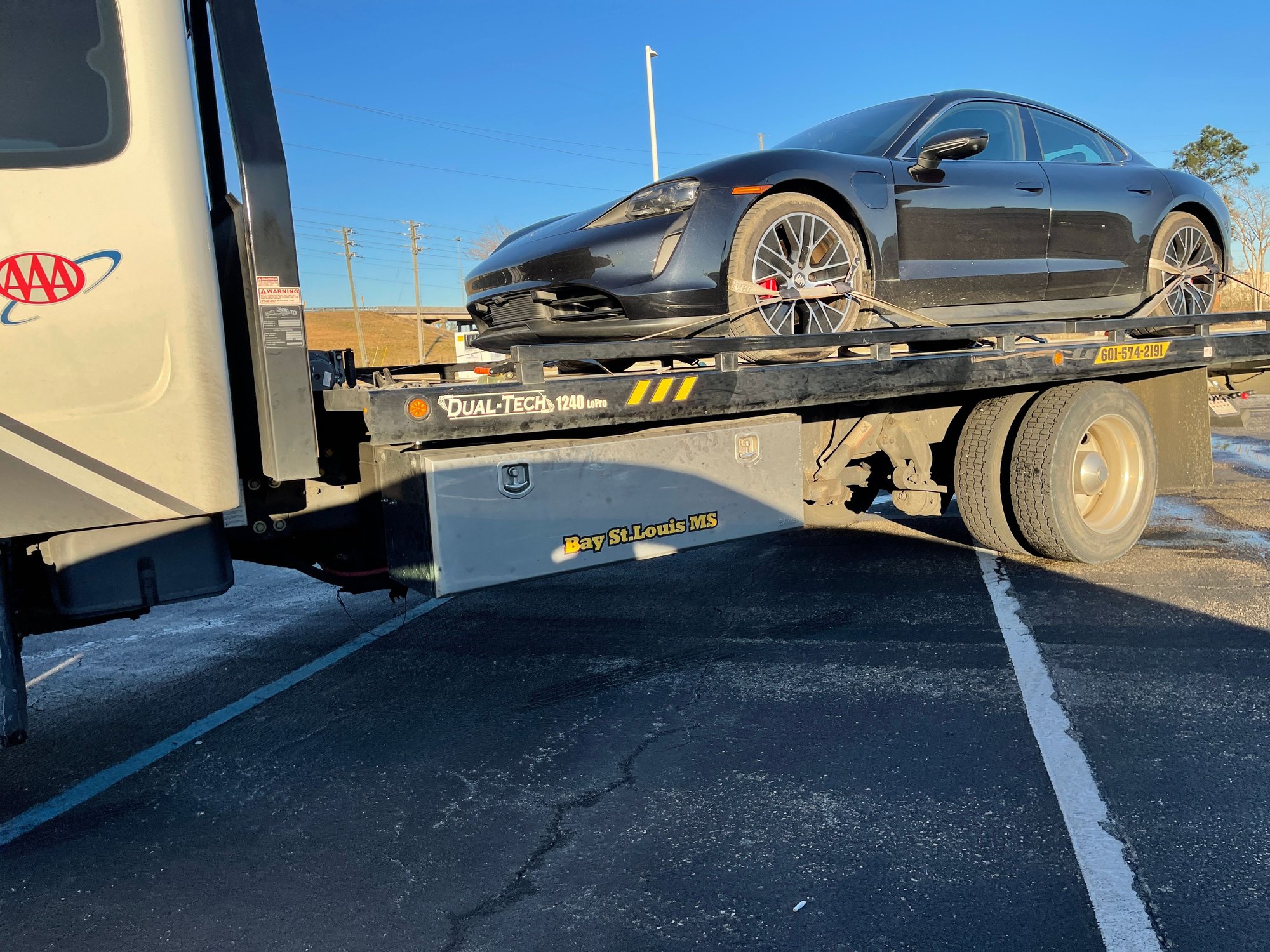

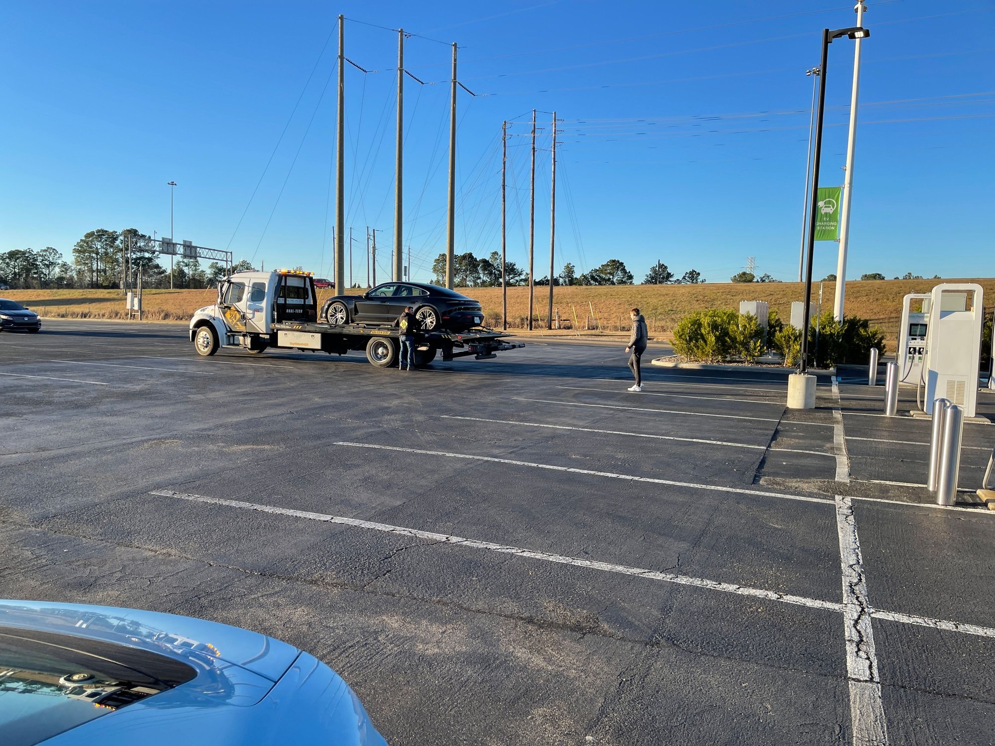

Range anxiety is real. On a road trip (away from interstates) I let the charge drop below 10% and next charger was 40 miles. Cannot assume charge will be working. Interestedly, while I was charging mine, a flat bed delivered a Taycan, battery 0% on the road.
