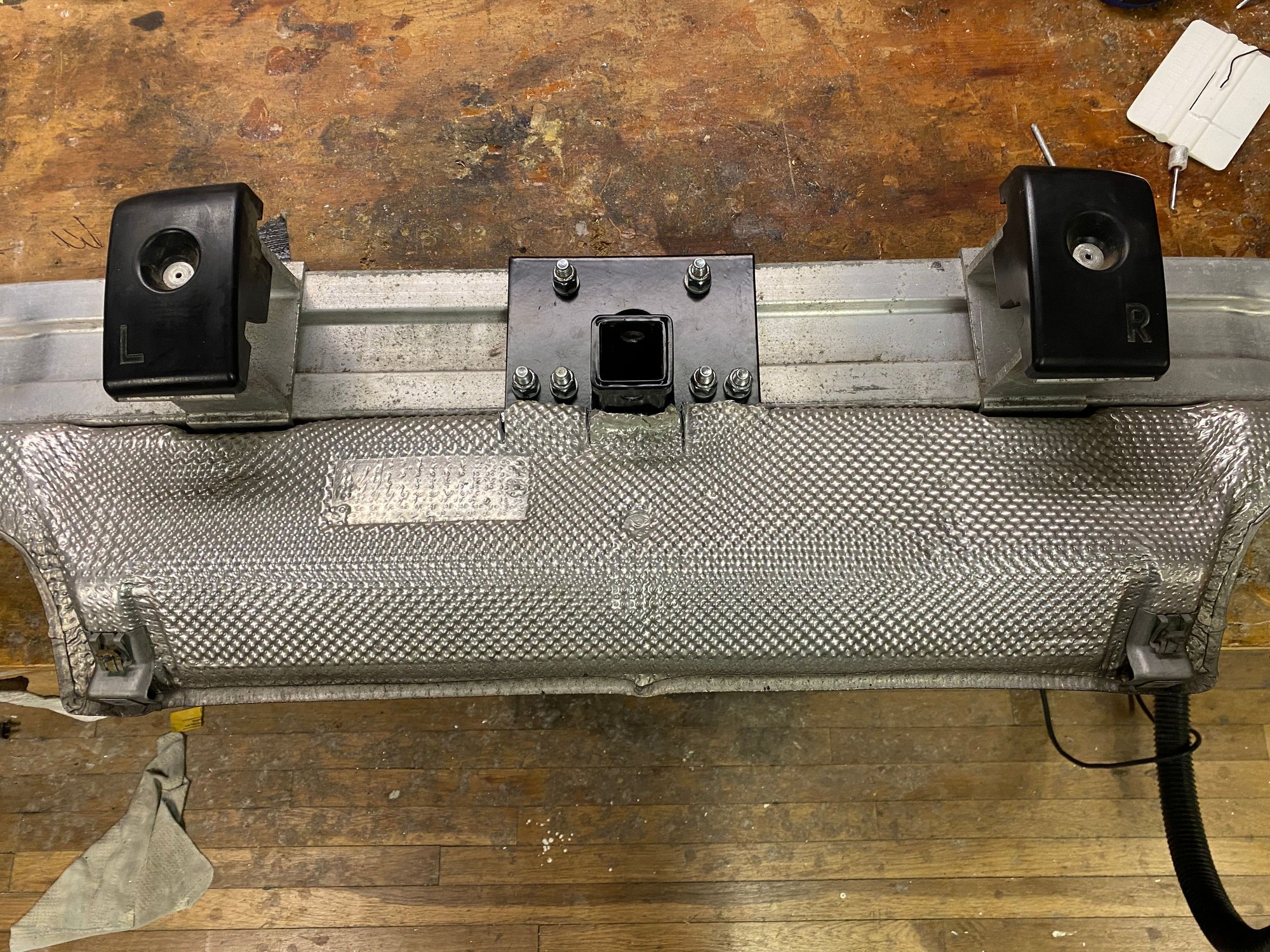

I have just installed the Sporttows version of the receiver
A friend of mine has one installed on his Cayman, it is very nice.
Are you happy with the results?? Look's like bumper lined up nicely when reinstalled. Any PIA items or issues??

Yes, quite happy with the way it turned out. The receiver is invisible when the license plate is installed. I haven’t used it yet - the hitch extension from Sporttows is out of stock, but I anticipate no problems when I use it with a bike rack in the Spring. The install went a lot easier than expected. It probably took 5-6 hours of actual work, but I spread it out over the course of a week. I must have measured and remeasured the locations for the holes that needed to be drilled a couple of dozen times. But that’s just me being obsessive.
Thanks BB. I was hoping you would say that. Also OCD here, so I'm assuming the holes to mount the receiver were the ones you were obsessing about. Agree getting them prefect is a requirement here too. This is exactly what I was looking for. Thinking about a Leroy tire trailer https://leroyengineering.com/collect...oducts/paddock having seen more than a few at my last DE in October. Any others to consider? thanks for your reply and excellent photos!
