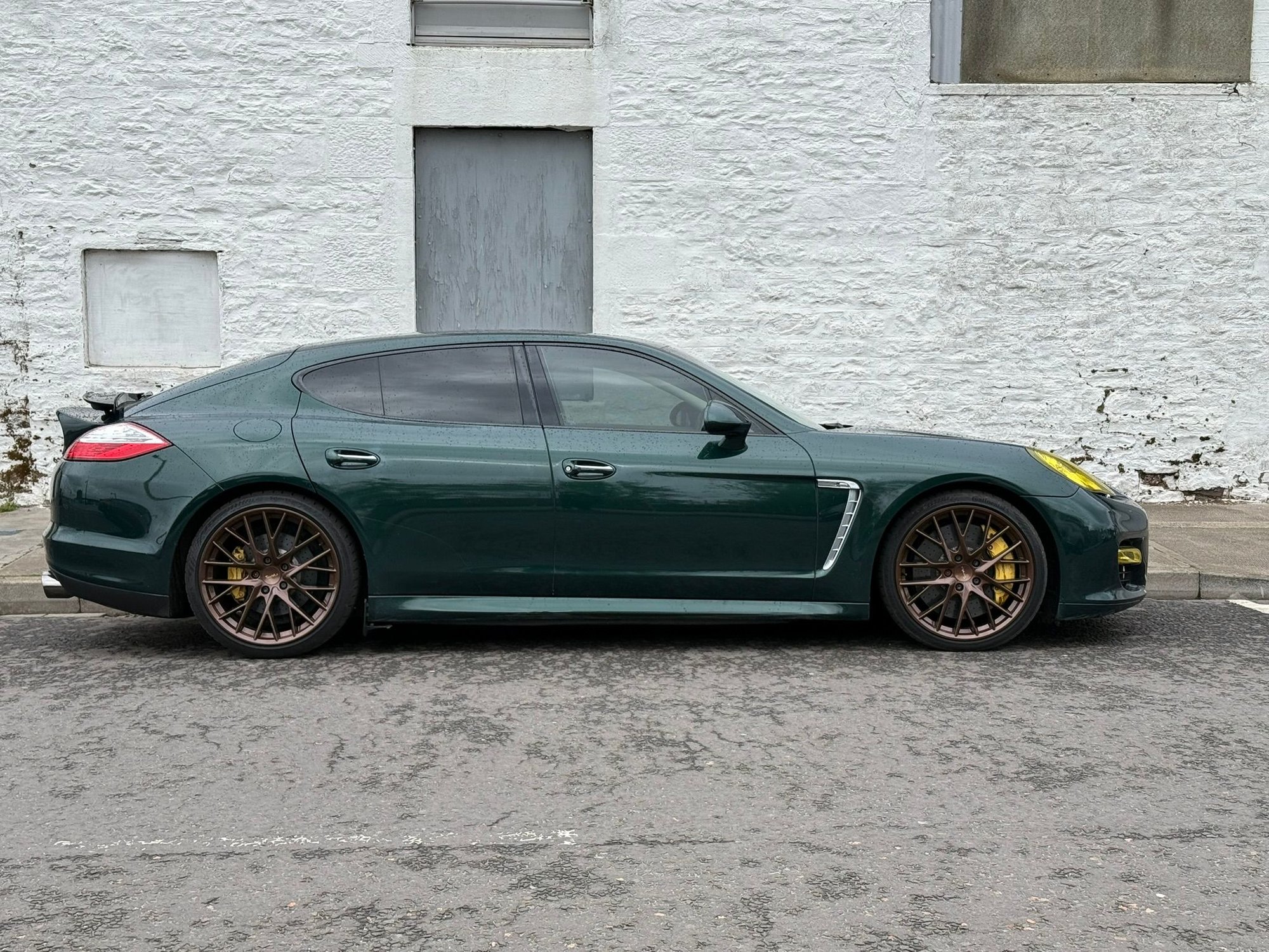

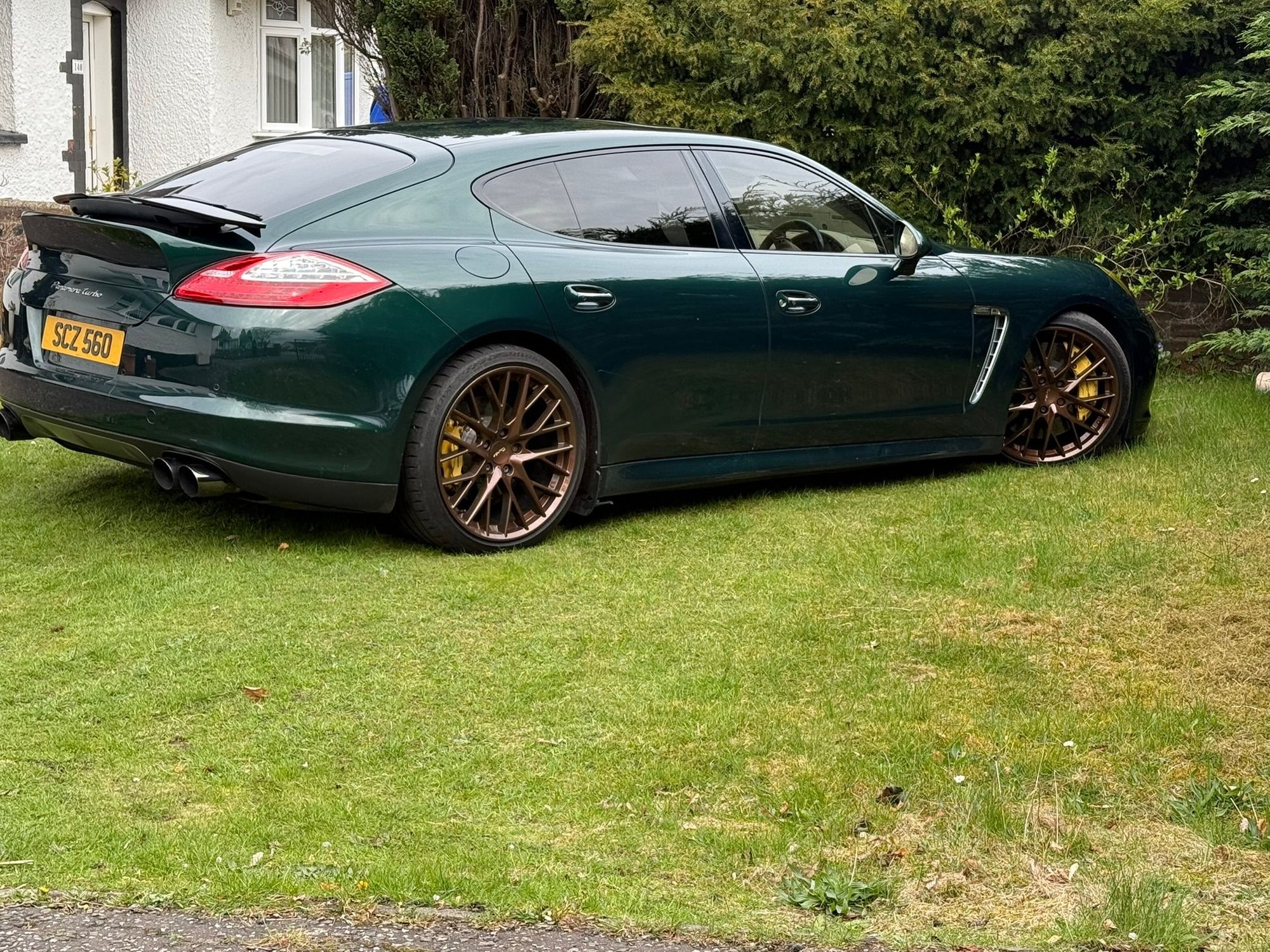

From: North East Scotland
will always throw a bong sadly, unless PIWIS can code it out . I've just fitted an additional spoiler to mine last week, Prior design ducktail, looks mega .
