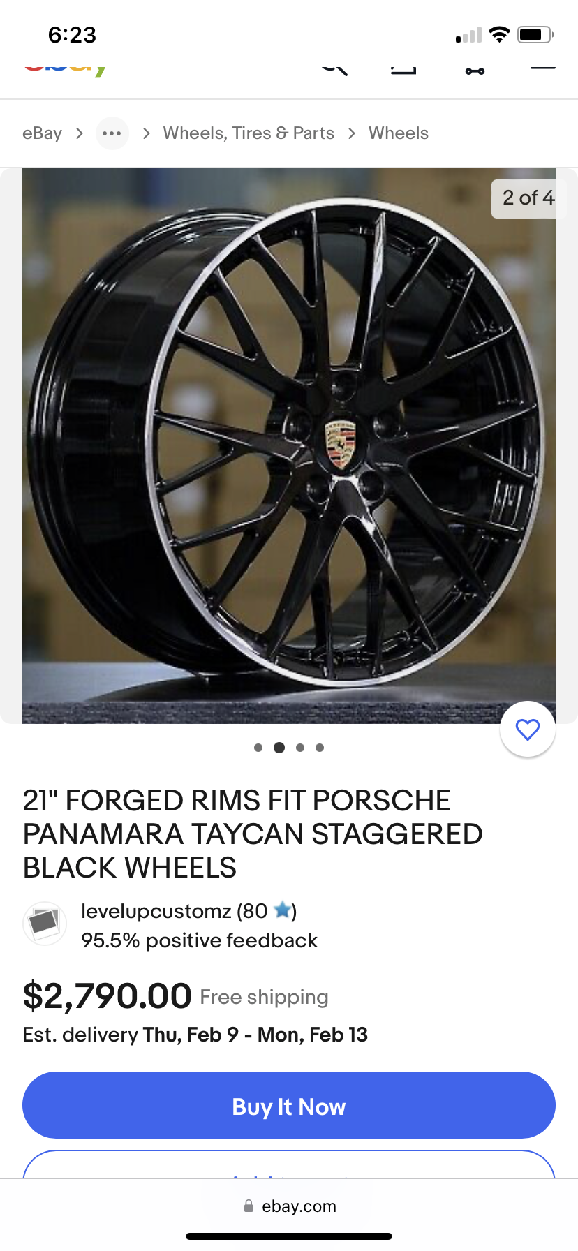

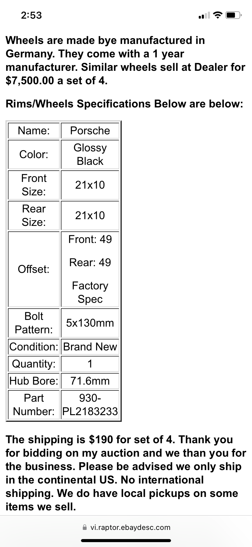

I have a 2013 Panamera base model.
before I purchase these wheels - May I have feedback confirming they will fit?
Currently my front and rear size are not identical like these!
Is anyone else out there riding these on their Panamera?
Any images welcomed!

I don't think I've ever seen a Panamera with a square set up. I know you're not asking this question but there's no way I'd run 21s on a 970. The 49 offset may not clear the brakes on the back.

Default How about these ?
In a prior post others had stated they are running 21s
How about this option?
Ultimately the goal here is to purchase black wheels for my Panamera.
Inout welcomed!

Should fit. Make sure you get the right tire sidewall to keep the rolling diameter equivalent. Something like 255/35/R21 for the front and 295/30/R21 on the back. Personally, I'd get 20s either in black or have them coated black.

Absolutely zero issues running 21s, I have Porsche genuine rims, plenty run 22s with no issues either .

Agree. I run 22’s in summer and no issues. You will find strong opinions here when you ask about wheel sizes with many naysayers saying nothing bigger than 20”! I run 20’s in the spring, fall, and winter so I have experience with both (I have 3 sets of wheels). Don’t let others dissuade you if you find something you like.
