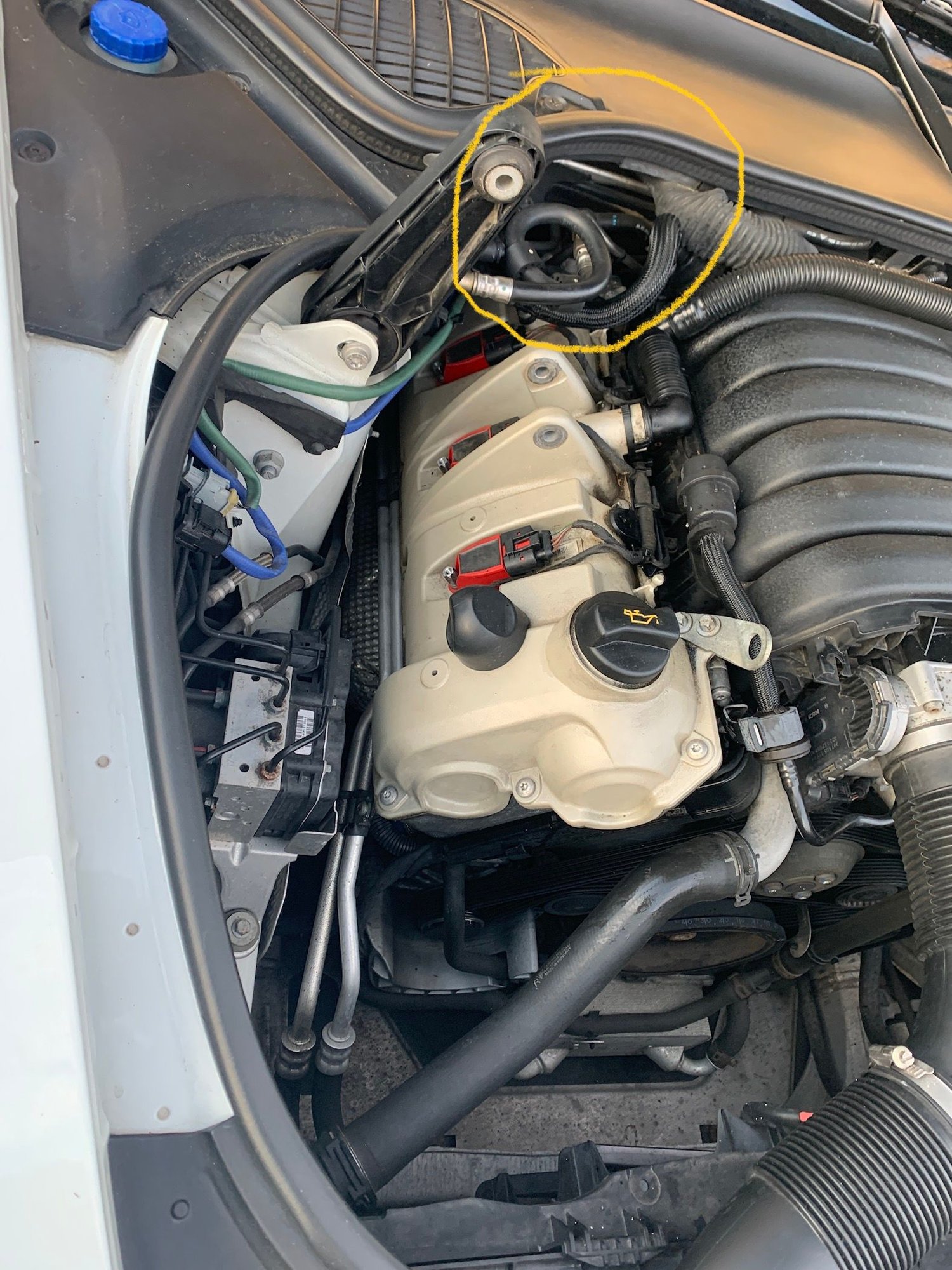

Well there seemingly are no easy projects
While replacing plugs and coils my socket remains secured to a plug head and I can seem to remove it despite bloody knuckles and effort
can any of the lines I’ve circled in yellow be moved out of the way or disconnected to allow better access to that back plug area?

Have you tried loosening and/or removing plug? Then try install again. I’ve had them get stuck but by wiggling socket they’ll come loose. If can get out with plug might follow tip I’ve see before of drilling hole in socket and running wire thru hole so can pull it out if needed. Good luck.

Add a wrap or two of electrical tape to the socket extension to get better purchase on it, and wiggle as you try to pull the extension + socket out.

They make locking socket extensions that are useful for sparkplugs.

Remove your trim piece at the washer reservoir, it will allow more room, only 3 screws hold it in place. I had a similar issue yesterday.
And then use a long pair of needle nose pliers or a magnet of sorts.
