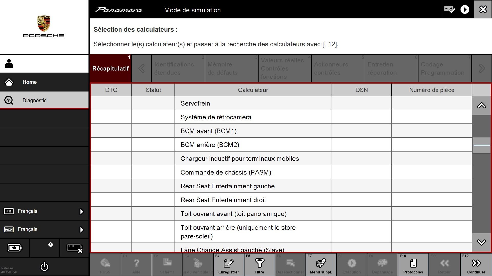

Default Where is the PASM menu located in PIWIS?
Hi all.
I went to use PIWIS today to try and have a play regarding ride height settings, there's a great tutorial and explanation on YouTube for a Macan and I thought the menu setup and method would be similar for the Panamera, however at the first hurdle I cant locate the PASM module in the first diagnostic menu.
And yes, I do have PASM so its definitely not that!!!!
Even in the simulation mode I cant locate it. Im thinking its a sub menu in another heading does anyone have the location of it?
Thanks
Jamie

You can read my DIY HERE
PASM is on the first list
Hi Marcus.
I should have said I have a 971, and I do not have that control unit listed on the first menu

OK sorry.
I look on my piwis for 971 and there is PASM module. Have you PASM on your car ?

Yes definitely.
I also cant see the module when im in simulation mode which is why i think I am not understanding something.
Can you screenshot where it is located?
Thanks
Jamie

Here :

Is this in the 971 menu Marcus?
Thanks

Yes

Don't think mines like that at all.
Ill get into the simulation menu and post up.
Thanks Marcus
