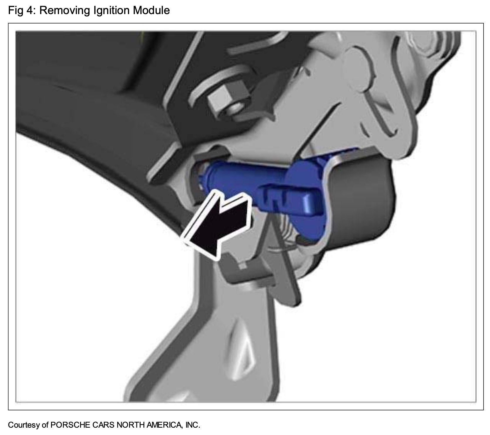

From a historial Stuttcars article. https://www.stuttcars.com/porsche-panamera-970-1-the-story/
"Active Bonnet SystemSafety was further improved with the active bonnet system – when the sensors in the front apron detect a collision with a pedestrian, the rear edge of the bonnet raises thanks to pyrotechnical charges. This system tries to reduce the injury by making the pedestrian to roll over the car instead of landing in the windscreen"
Sounds like you would have to replace the active charge system - not sure about the mechanical part of the system.
An "Ignition Module for Lid" is mentioned in service manual -- fairly detailed procedure to properly remove and replace once triggered.
Regards,
Chuck
2014 4S
Drawing of ignition module at hood hinge area (after cover removed)
