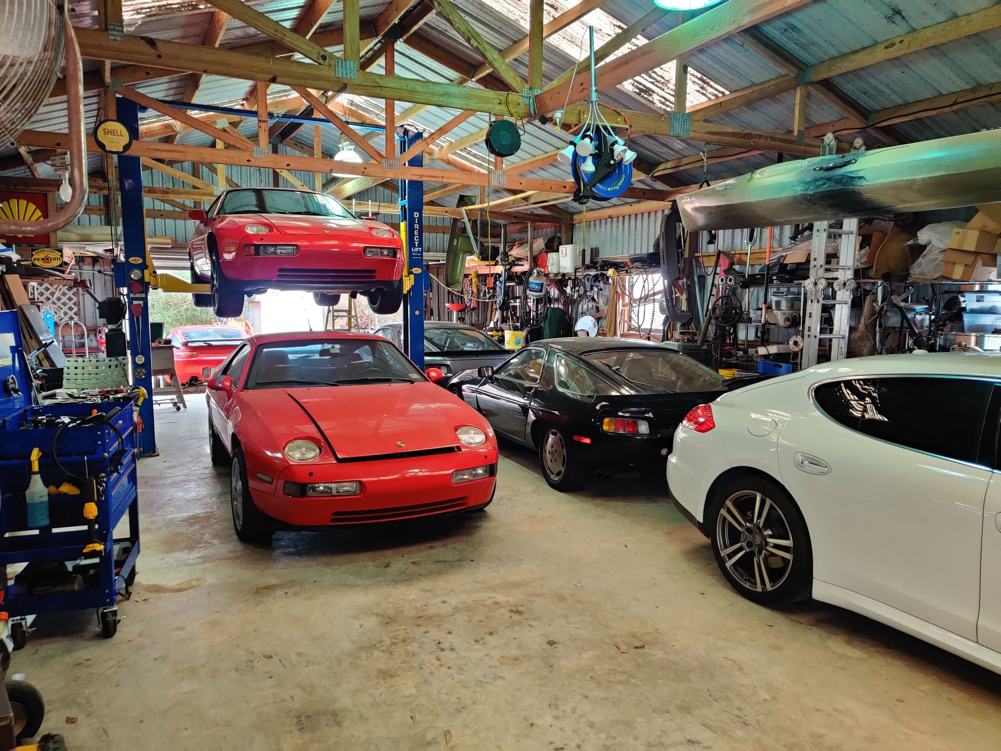

I have had a Direct Lift from a dealer in Ft. Worth, for about 10 years and have been very happy with it. The only issue I've had is that one of the hydraulic hose fittings got lose and leaked some fluid, but that's more of an install problem. I paid about $1600 for the 9k lb lift, and about $300 for the install. A lift is really worth it if you work on your own cars, makes everything so much easier and fun. I think mine paid for itself in the first 6 mths.
The garage is a bit tight right now after buying a 5th 928, but I hope to sell the black '82 before too long. As you can see, the empty spot where I am standing is the VERY important spot for the wife's car. Don't forget that.

Sweet gararge lol. My architect also has 2 post lift, I’m waffling. Advantage of 4 post is can move it if need be, I’ve got several months to decide. I’ll take your advice on wife’s car. I grew up hearing my mother chewing my father out in bad weather and getting rained on cause garage always full with boat and car being worked on. Current house has 2 car attached and 2 car detached for that specific reason. New one will be little more total space, but to have nice work space and storage at back for mower, tractor, couples bikes etc, prefer to get lift for 4th car. But still far smaller than yours it appears!

"The garage is a bit tight right now....."
Are you kidding me? I'd kill for that much space!
