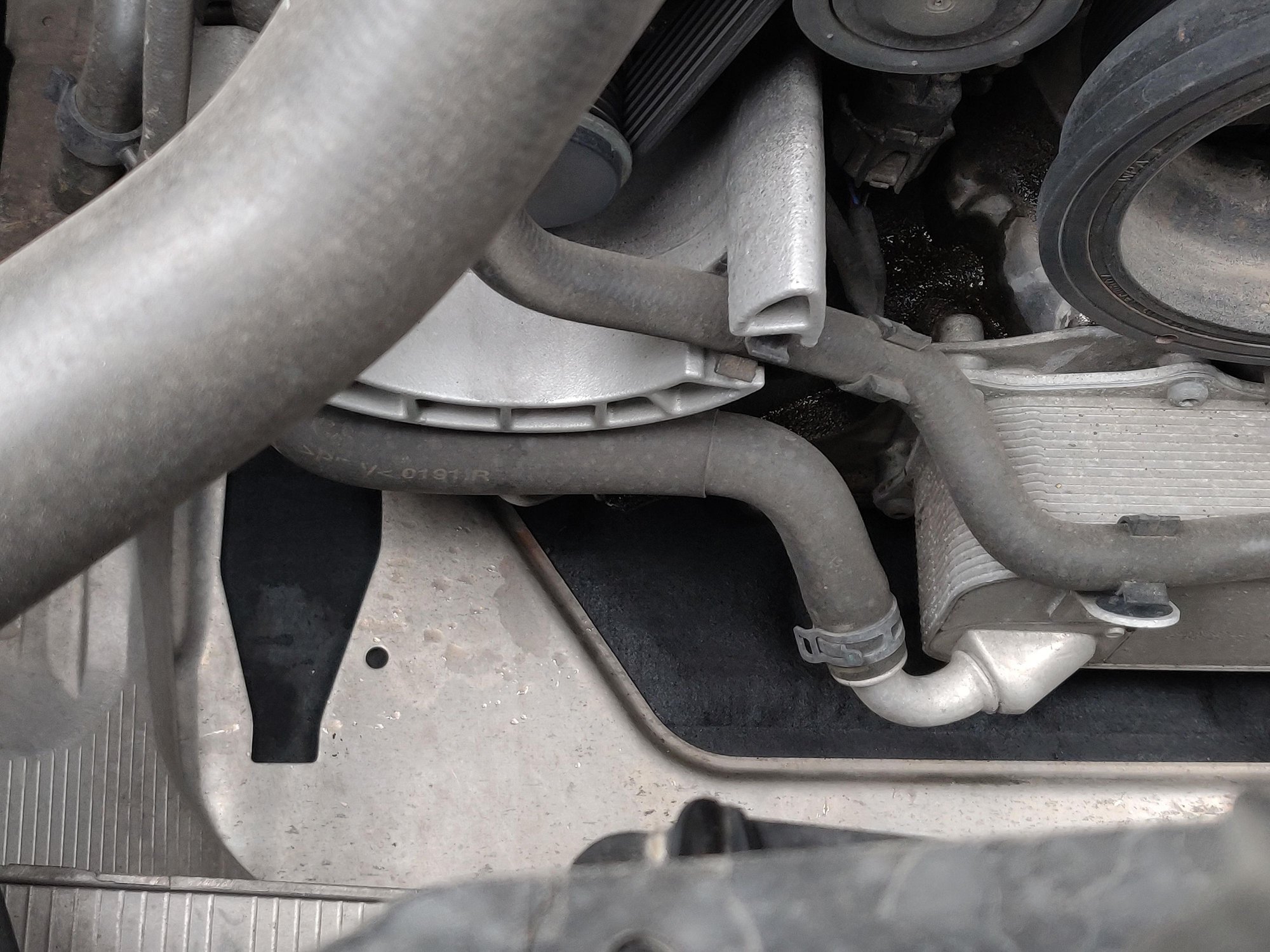

Where's the location of the water pump, presumably front and center? I think I did notice some seepage on the left lower side and then later when I moved the car forward a spot on the driveway which corresponded to about the same place. I'll attached a pic....
Noticed some drops of moisture on the flat pan above

top center, just under the intake. it's pretty easy to get to and service.

Pull the belly-pan to get a good view of what's going on. That pan hides a lot of ills.
