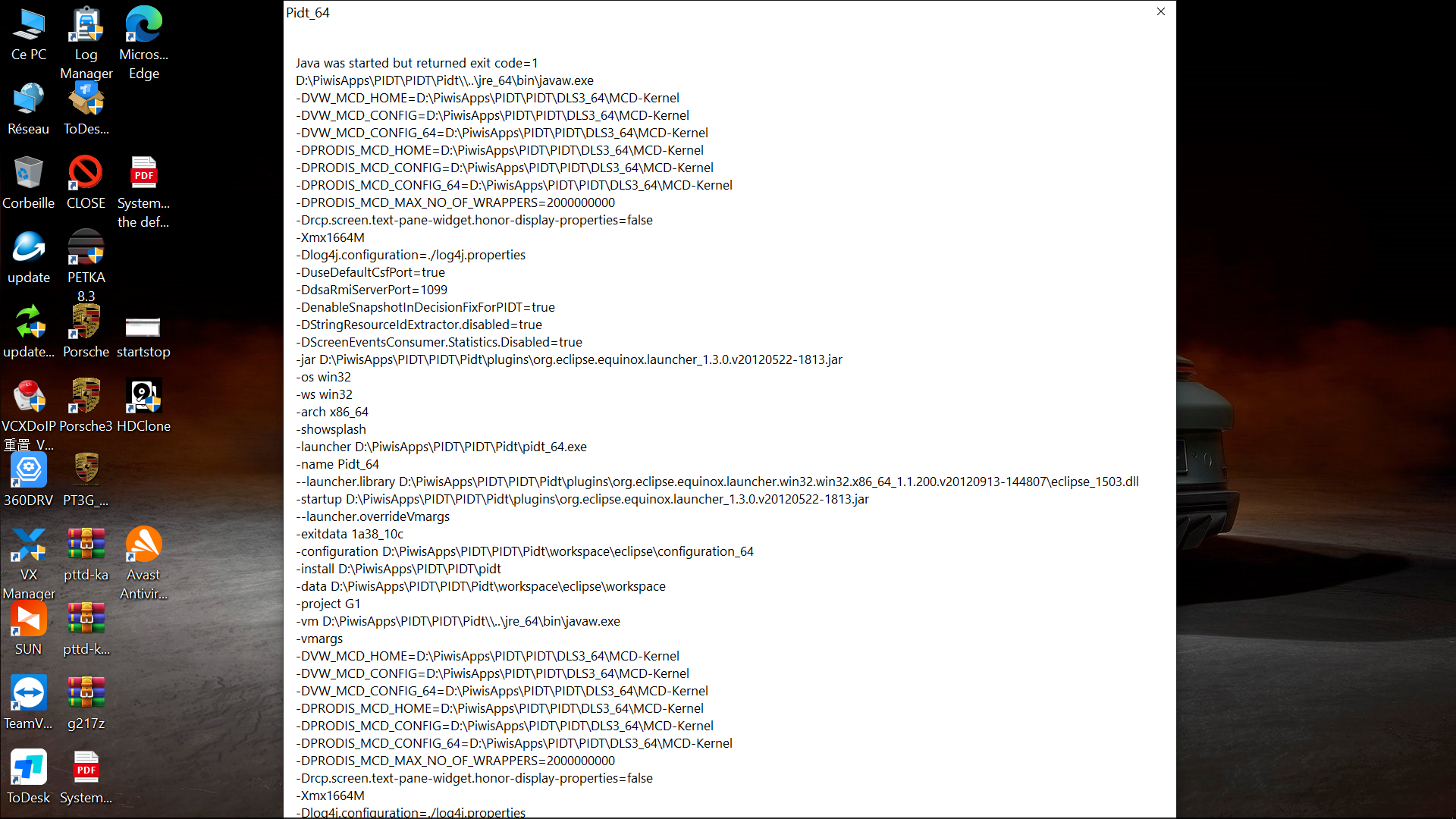

Hi i've problem with lost connection on VCX SE avec piwis 3.
I've had this window :
first i've think that it's vcx SE but this window seem to be java problem.
Have you idea to help me ?
Thanks

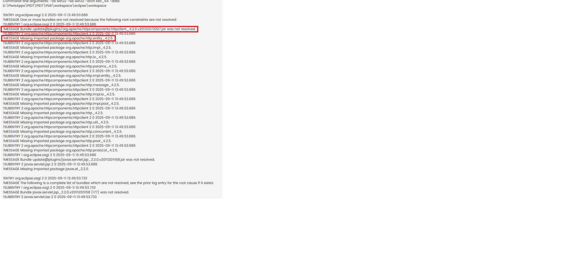

After it's seem problem with log :
Can you help me ? Thanks
