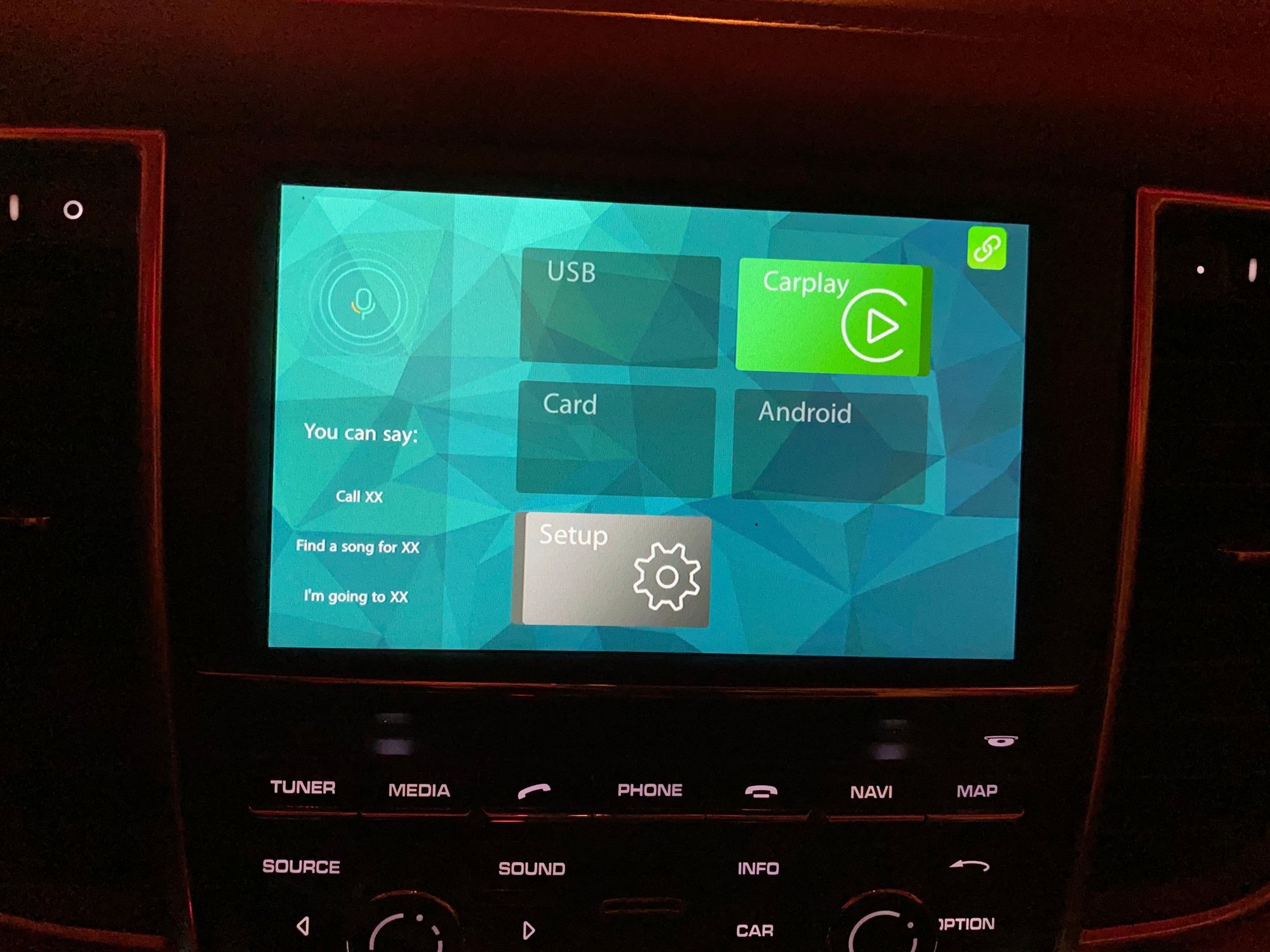

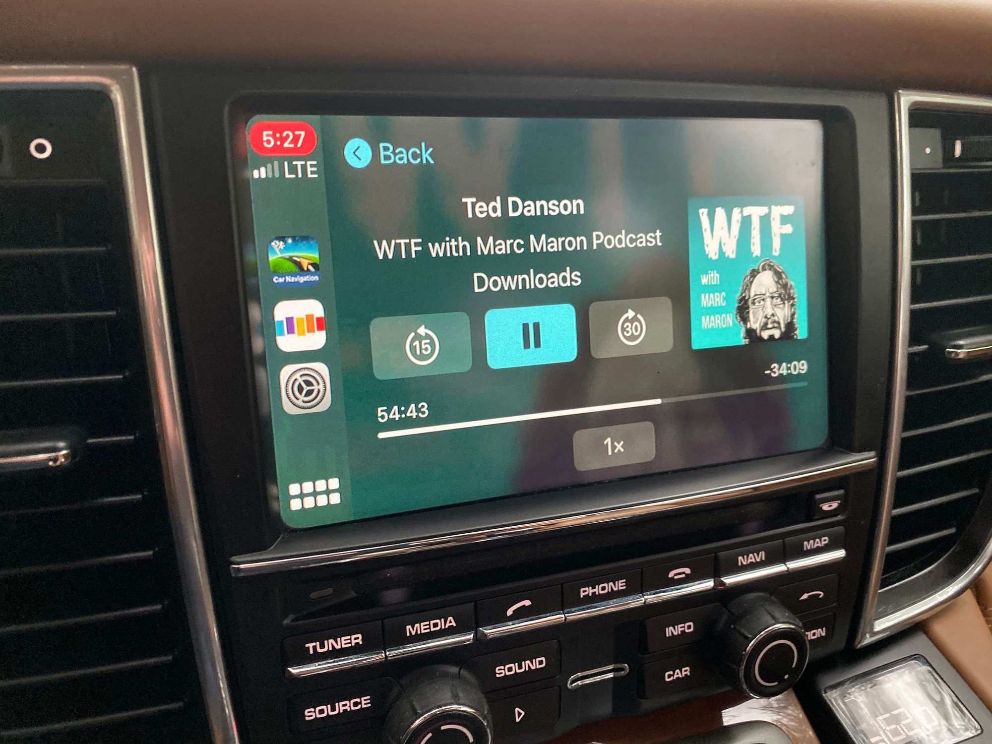

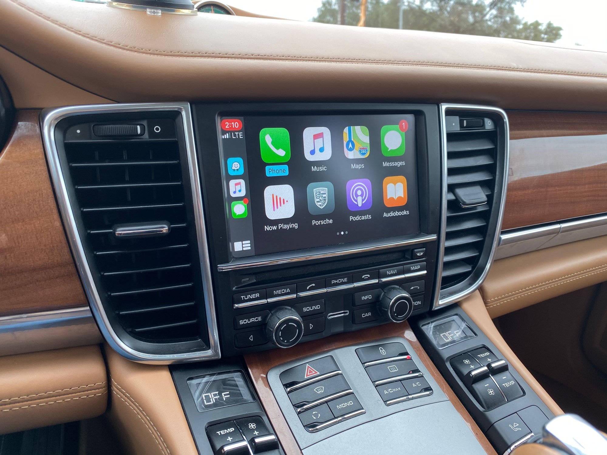

I picked up my Panamera today after having the Joyeauto CarPlay kit installed. All told, the installer took about 4 hours to get the kit completely installed - that includes the time taken to install a new microphone and the second USB input for CarPlay access. I highly recommend that if you choose to install this kit, that you make sure your installer places the microphone in the center / front headliner area near the dome light. I’m getting incredible voice reception due to placing the microphone there. The joyeauto kit’s instructions place the microphone at the top of the A-pillar - not a great location due to noise.
At any rate, I highly recommend the Joyeauto kit - the installer was very impressed with it — this wasn’t his first rodeo installing aftermarket CarPlay in PCM 3.1 equipped Porsches. He said it was easily the highest quality kit he’s seen. Functionality is flawless and the upgrades to the PCM system screen for various touch motions works perfectly - it’s a huge upgrade. The system can be controlled by touch or by using the selector ****. The system is also completely up to date and is fully IOS 13 enabled.
please feel free to ask any questions - I’m happy to answer anything I can and will happily refer any questions I can’t answer to the installer: Bonnie & Clydes in Dallas, TX.

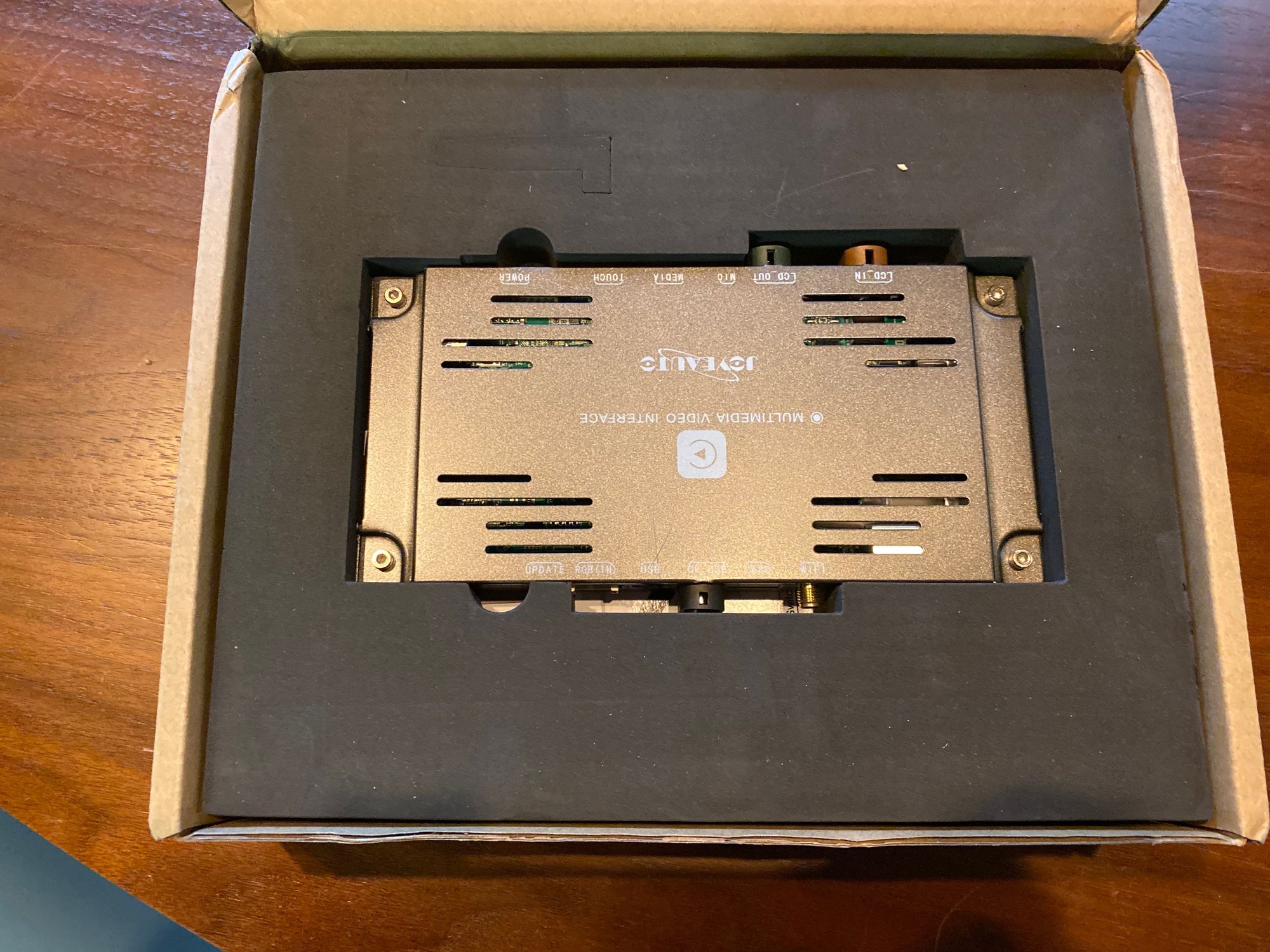

A few more pics of the kit:
unfortunately, I neglected to take pics of the multiple harnesses, circuit boards, the microphone and the USB adapter that’s also supplied with the Joyeauto kit.
I was also extremely impressed with how quickly Joyeauto got the kit to me. I ordered it on Thursday of last week, it shipped on Friday from Hong Kong, and it was delivered to me in Dallas via DHL on Monday morning. That’s pretty damn quick!

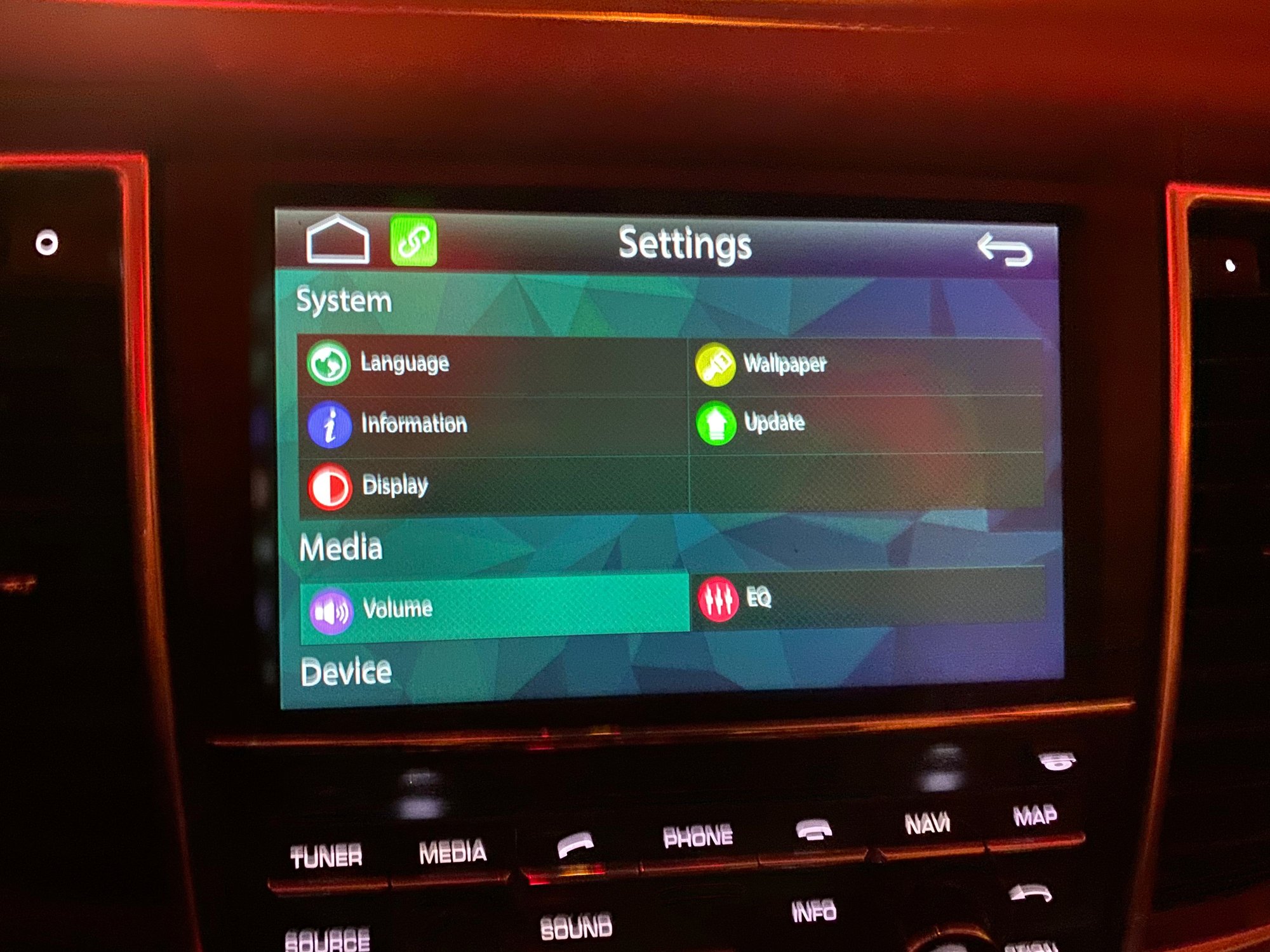

one other big benefit is that this Joyeauto system has its own set of audio tone controls and video control settings. This enables you to sharpen up the picture quality and to dial in slightly better sound. It’s probably confirmation bias on my part, but I swear that the sound quality is improved through this thing!

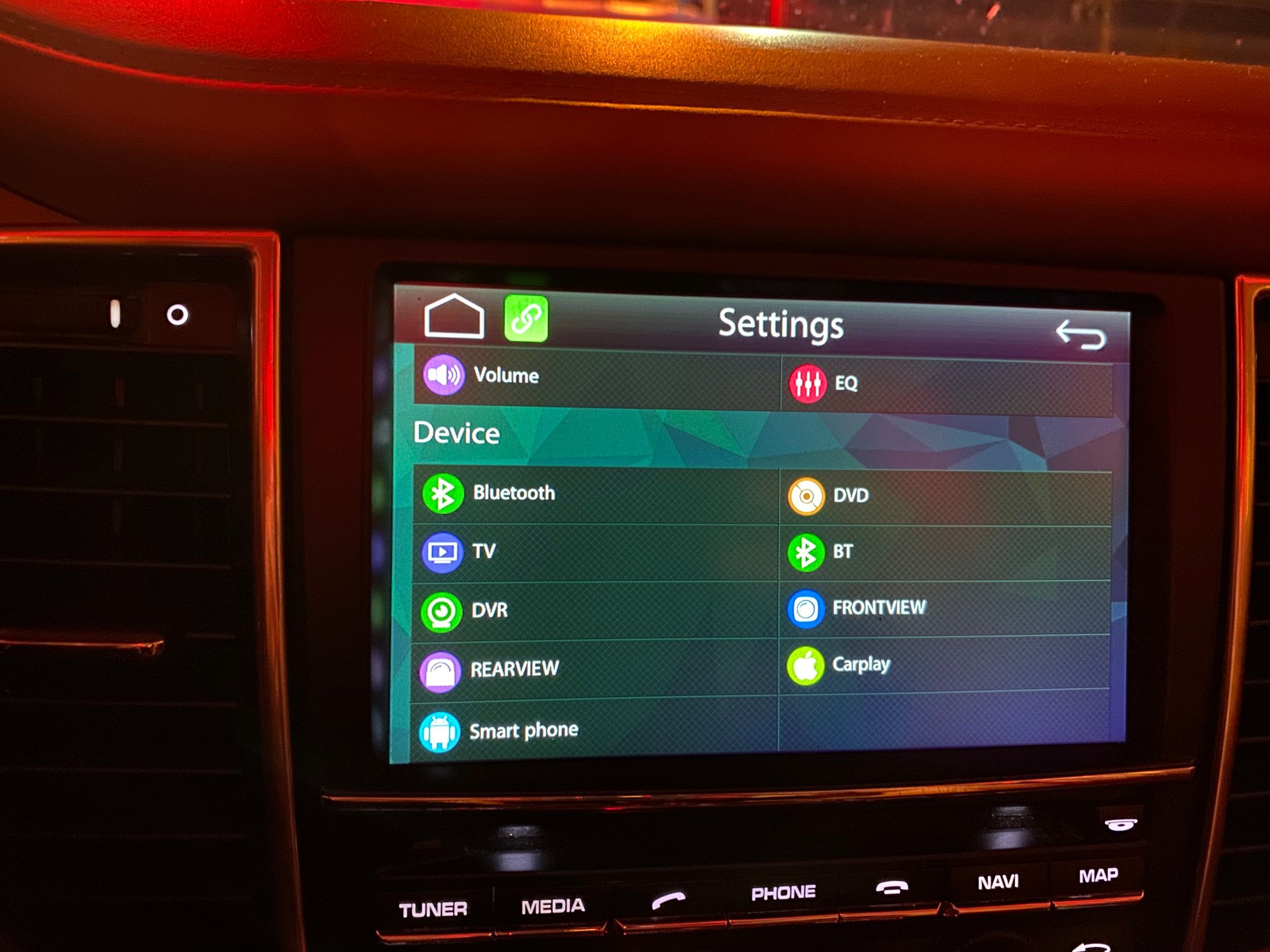

More shots of the Joyeauto control screens - accessible through the Porsche icon in CarPlay...

I wish I could tell you how my installer secured everything, but I can say that there are no rattles or anything like that going on. The large interface box actually goes under the dash on the driver side of the car, so it won’t be just flopping around behind the PCM head unit. The circuit boards that install inside PCM actually attach to the PCM chassis....
