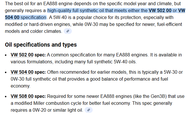

Originally Posted by finpat997
What oil do you guys use/recommend? I have a '21 base.
you will have to decide for yourself what to believe and what to do.
The owner's manual is a better reference than an AI search engine result.
