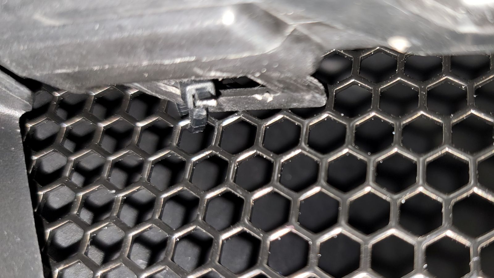

I added my RGS guards to the Macan today. I might still adjust them but the protection is in place for now. I took some close up photos to try and clearly show the routing of the zip ties so they aren't visible from the front. Hopefully this is helpful to anyone else doing this install, whether using grills from a supplier or DIY.
Right side guard installed
View from beneath the horizontal slat
Close up of the clipped zip tie

Thanks, Shifty Wolf. I ordered my RGS radiator grills and they should be here in time for me to install them next weekend. In your installation photos, the zip ties are completely invisible, thanks to the "loops" behind the slats.

@David Berry you might take a quick look at my photos to see the loop locations behind your plastic slat. If you want, you could pretty easily re-run your zip ties and make them far less noticeable. Just a thought but it does tidy up the install.

I just ordered these same ones ($50) and they are both fantastic and a bargain at that price. There's no need to zip tie over the slats and in fact their instructions say to zip tie to the 3 loops on the back of the slat as shown in other posts here, which is what I did. What I also like about these over the others shown in this thread is that these come with a rubber surround that covers the sharp edges thus helping not scratch anything on the way in, and they give it a finished look once installed as they are pretty much out of sight.
