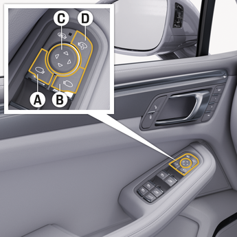

FOUND IT!!!
Through the dashboard controls:
Vehicle > Settings > Light & Visibility > Revers. Opt.
Boom!

Originally Posted by dak911
OK gonna try it, dips one or both?
Just passenger but there might be an option for both.
I’m away from car. Search owners manual “mirror” and scroll down.

I edited my reply to you. Looks like just one dips.

Originally Posted by Sze5003
I have that option on my ‘21. Never checked it out until I read this thread. Went to try it out and when I activate it on the dash, the mirror tilts upwards when I go in reverse. I suppose the programming you mention here is what I need to do to get it to tilt down. I was never a fan of the mirrors tilting because sometimes I also use them to check my sides and behind me before reversing.
Put the car in reverse, then adjust the passenger mirror to the position you want it. When you back into drive it will return to the position it was before. When you go into reverse the next time the mirror will return to the position you last adjusted into.
