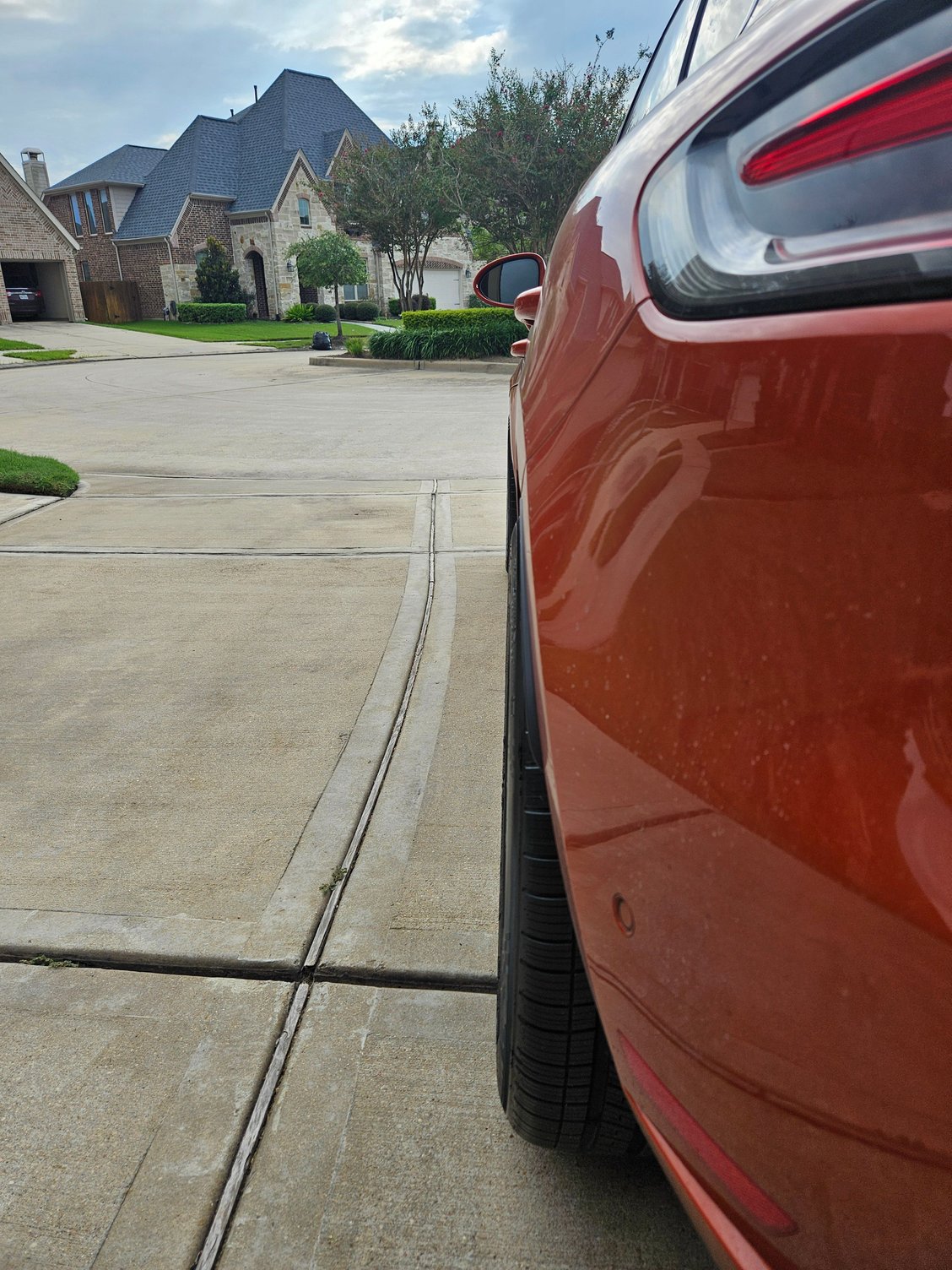

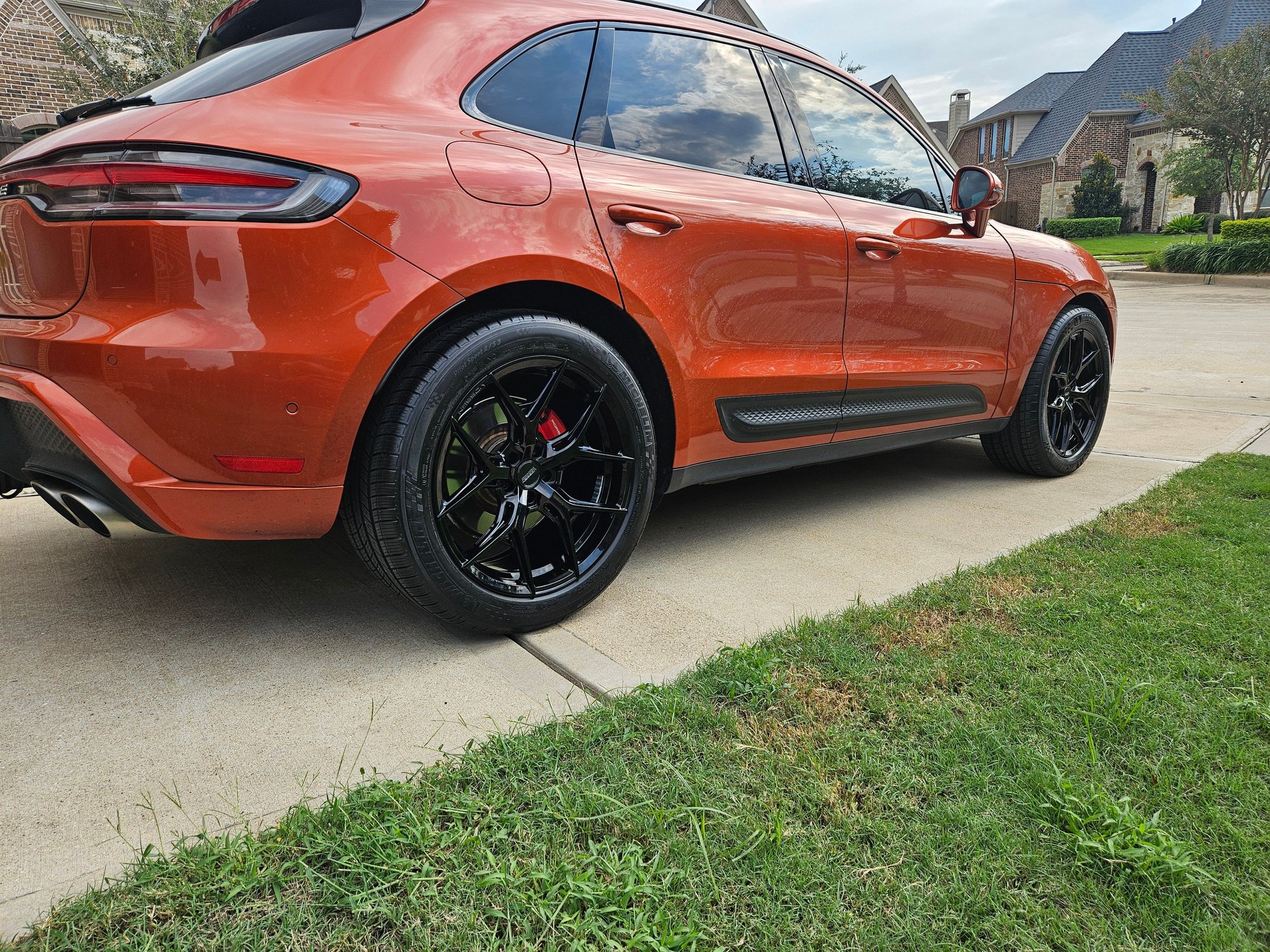

Back to life....finally got everything sorted and this is the result. Wider rear track was my goal and I'm really liking the results. Haven't been out on the appropriate drive yet, but I'm looking forward to it.......Phil
Specs: Vossen HF-5 Wheels - (Front 20X9 et25 / Rear 20x10.5 et25)
Rennline - 10mm spacer up front / 12mm spacer out back
Michelin Pilot Sport AS/3 - 275-45-20 front / 305-40-20 rear
42mm Extended lug bolts / 40mm lug bolt locks

Looking great! I responded more on your MacanForum post.
