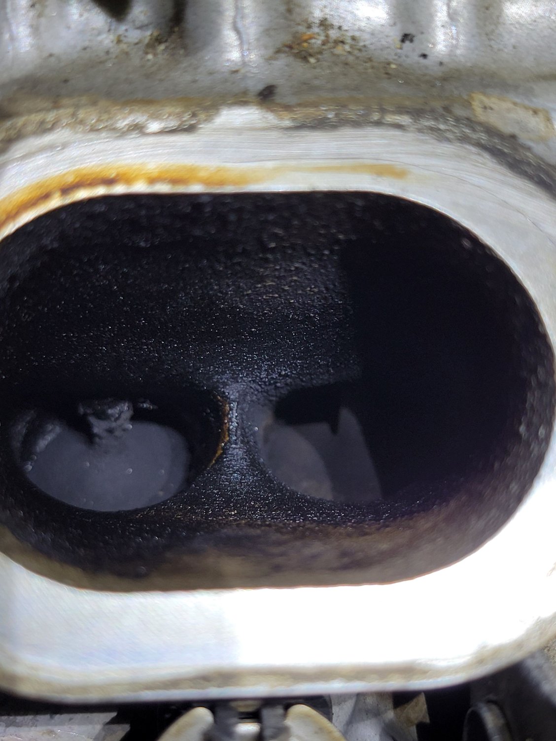

Back of intake valves look like this:

Likes: 526
That's not too bad...how many miles?
About 54k miles on the 2017. Hard to get a good pic down there, but IMO it's pretty bad. Some cylinders had huge globs of carbon buildup on the valve guides.
What you have is not bad at all. I would be happy with that small amount of build up. I can show you much much worse.
What brand of gasoline do you usually use?
