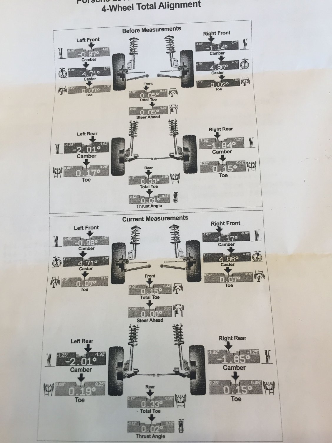

After I bought my Macan Turbo, I noticed it had all season tires on it. About that time, the Rennaisance Festival was in full swing. Drove up north of town and found I could not handle the curves as I remembered in previous years/cars. Swapped them out for Continental Sport 6's and the same damned thing. Could not track well. I'm thinking I bought a crappy car! Then 10K later, I swap the Conti's out for a set of Goodyear tires AND have them check the alignment. BOOM! The chart below shows the numbers as well as the range. Way out! Mind you... it was out from the factory and not from potholes or curbs or off-roading. Next set of tires you get, you might want to have them* check the alignment too.
*-Dealership has been the only one to swap/balance tires on my Macan since new. Damaged wheel, missing valve cap -> One number to call. One throat to choke. Single part responsibility.

Alignment? They hardly did anything...they brought in the front right toe a bit, that's the only adjustment made. The before numbers aren't that terribly off that it would feel like a night and day difference.

X2, my thoughts exactly. They didn't do much, if anything left rear toe is worst then before. Front toe was out before and fixed afterwards. The car will feel more responsive to steering inputs with that fixed, and maybe that's what Bruce is sensing.

I doubt the rear toe is the result of an adjustment, probably just measurement error in the before/after numbers.
The fact that both tires and alignment were adjusted at the same time...I'd still bet the tires made the bigger difference. Having done both tire swaps to like category (e.g. UHP to UHP) and studied every alignment ever done on my vehicles, the tire swaps have more impact than the alignments do, even when the alignments have been far further out of spec than what the OP had.

Guess I need to explain this a little. The pic I posted was after I had paid for a full alignment and had driven home. I never bothered to look at the paperwork I was handed BEFORE my dumbaZZ drove away. Read that last line again everyone. I didn't inspect what I expected and had paid for and drove away. My dad as an automobile state inspection owner in South Philadelphia, he would always tell a customer: 'I will guarantee the alignment as long as it stays in the garage'. This was more in reference to the streets back in the 50's, 60's in Philly. Fortunately, they did right after having to lose several hours out of my life I'll never get back, in correcting the alignment. The ppw is around here somewhere. Tax season. I'll try to post a pic of the finished alignment numbers if I find them.
