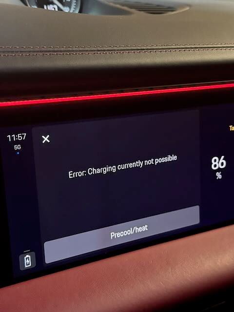

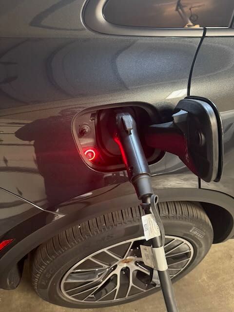

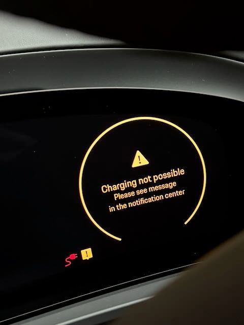

Getting a PCM (dash and Infotainment screen) error "Charging Not Possible". The charging port starts off green then switches to red. Issue is intermittent. Multiple charging stations tried.
Have tried the following:1. In the car’s charging menu, changed to “Direct/Immediate” and deleted any timers or profiles, then plug in again.
2. Temporarily turned off Plug & Charge in both the PCM and the My Porsche app, then started the charge.
3. Put into Compatibility Mode and re‑tried
4. Factory reboot where all settings are lost
It has been to 2 dealers and verified that it is not the physical cable/charger. The dealers have given up and told us to call 1-800-Porsche, who were not helpful.

I too have received the same error message when trying to charge at home since the November VR28.13 software update and can verify that a factory reset does not solve the problem. I have, however, discovered 2 inexplicable and crazy workarounds. I can charge at home if I specify a departure time a few hours in advance and wait for the car to charge. I can also Plug and Charge if I change the user account to GUEST. Prior to the software update, I simply plugged in and walked away and it worked. I can also verify that 1-800 PORSCHE was no help.

What's frustrating is how this started is the driver's screen would go blank when driving and when we called the dealer - they had me tow the car in (not safe to drive). The dealer insisted on updating the software. Fixed the display problem, created a bigger problem.
I may investigate if the software can be downgraded. I'll take a blank screen over an EV that can't charge.
