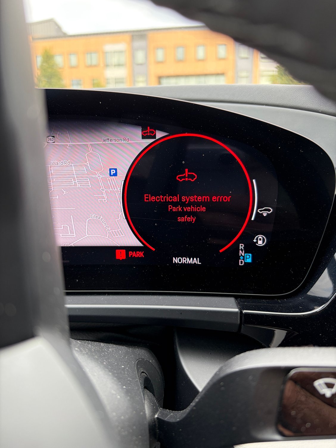

Not in the same league as the issues mentioned here, but I just got this error message on my Macan 4 when trying to drive the car from stationary. And it wouldn’t budge. I turned it off and on, and it was fine right away. But it is still quite concerning. Over the past few months of owning the car, there are so many error messages that have come and gone away quickly, but this one was scary.
