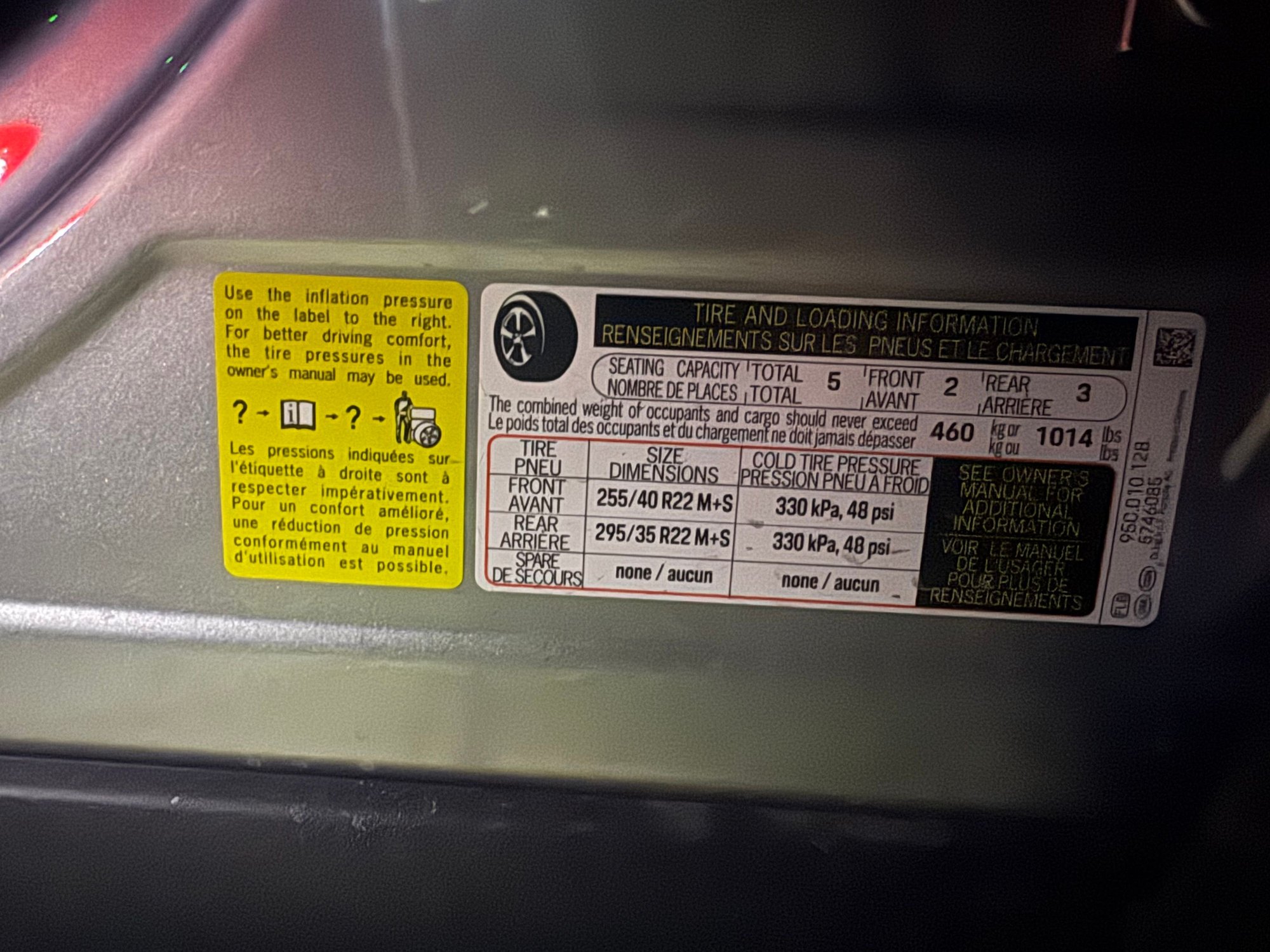

out of curiosity i checked the sticker on the door sill and i was surprised to see it says 48psi all around! that seems crazy high but maybe that’s the right pressure? fwiw its felt totally fine running in mid 30s

The door sticker indicates the full load recommended tire pressure for the wheel size that you have.
For partial load pressures for your wheel size, it is listed in the manual in the car.
This is typical for most German manufacturers. I prefer to use the partial load pressures listed in the manual which is what I use in my Taycan. I am awaiting for my Macan delivery next week and can reference specific numbers at that time.

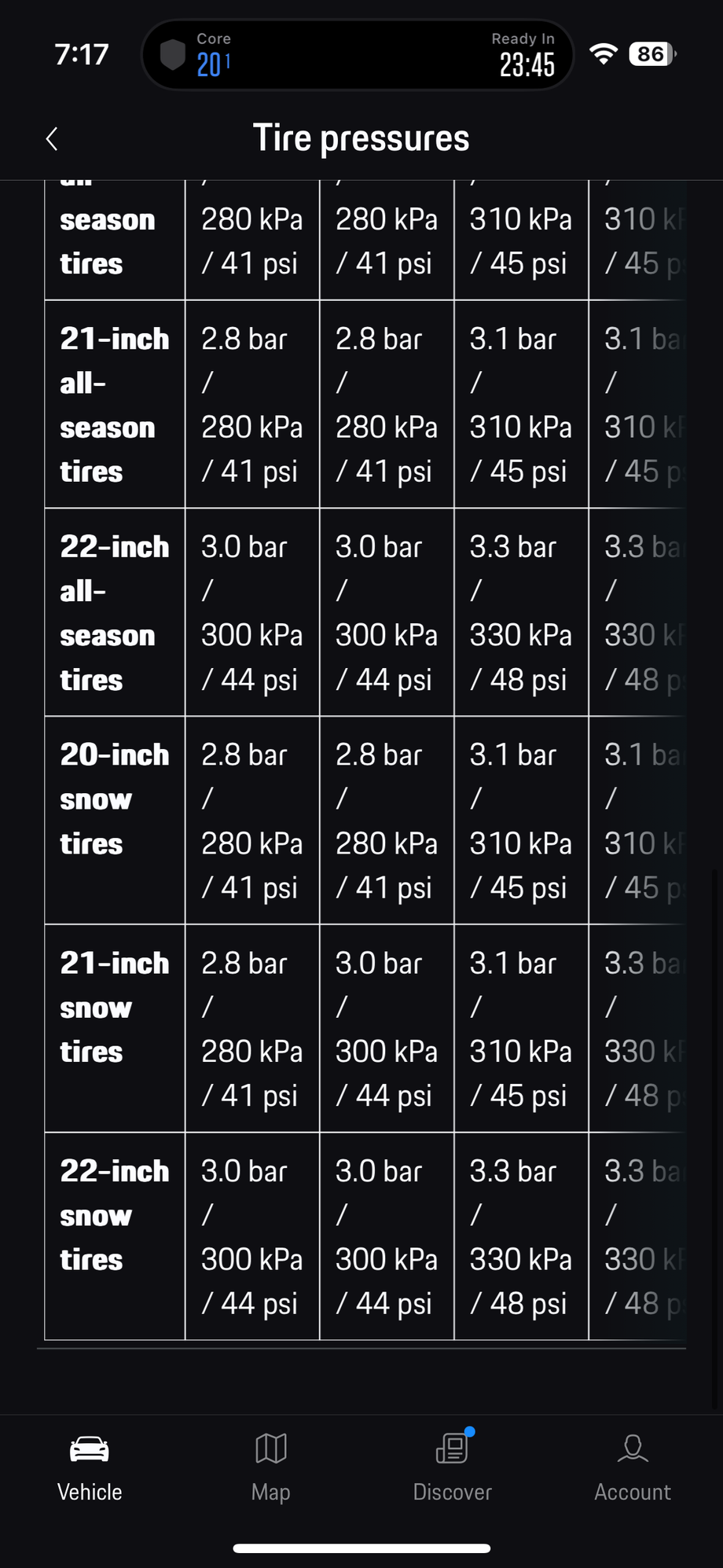

They are in the Porsche App: Chapter Overview -> Technical Data -> Tire Pressures.

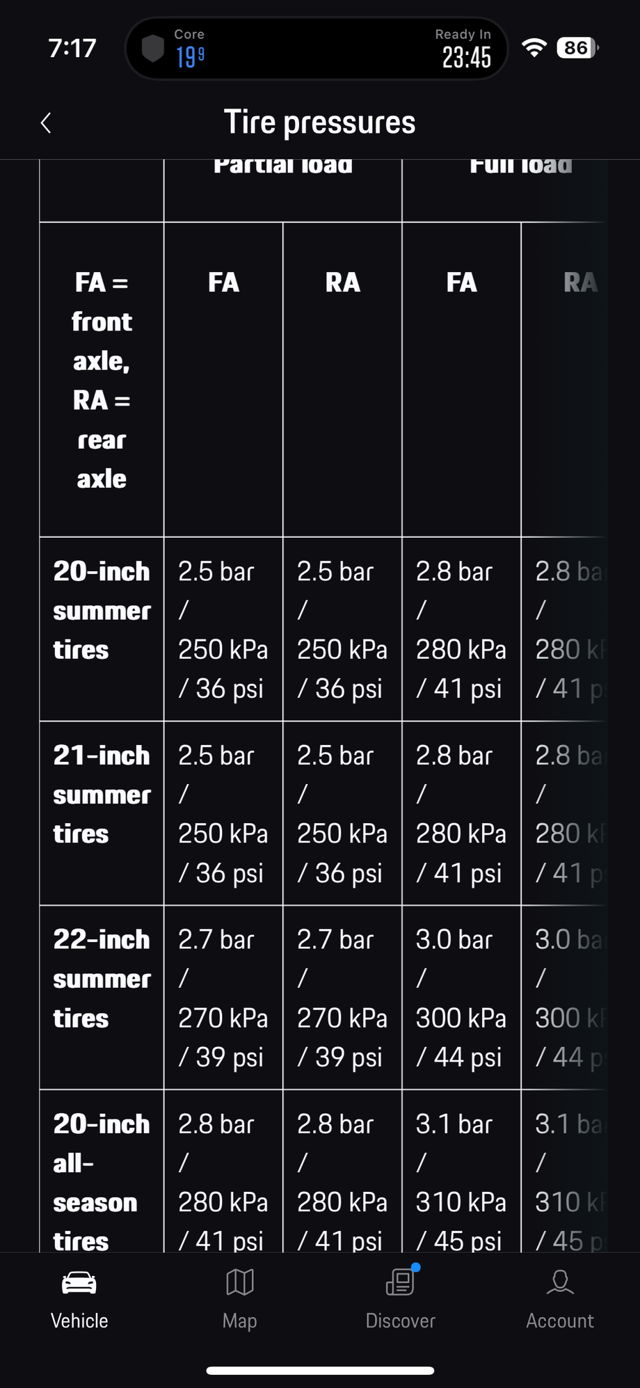

thank you! i used the search bar and it didn’t find it, but you’re right it is there. 22” summer partial load is 39 all around, so i’m a little low but nowhere near the number on the sticker

So just checked the app, which I have access to as my incoming car is currently added and for 22" wheels All season tires, partial load is 44psi front and back and full load is 48 psi front and back. Surprisingly different for , 22" summer tires and are partial load 39 psi and 44psi full load.
