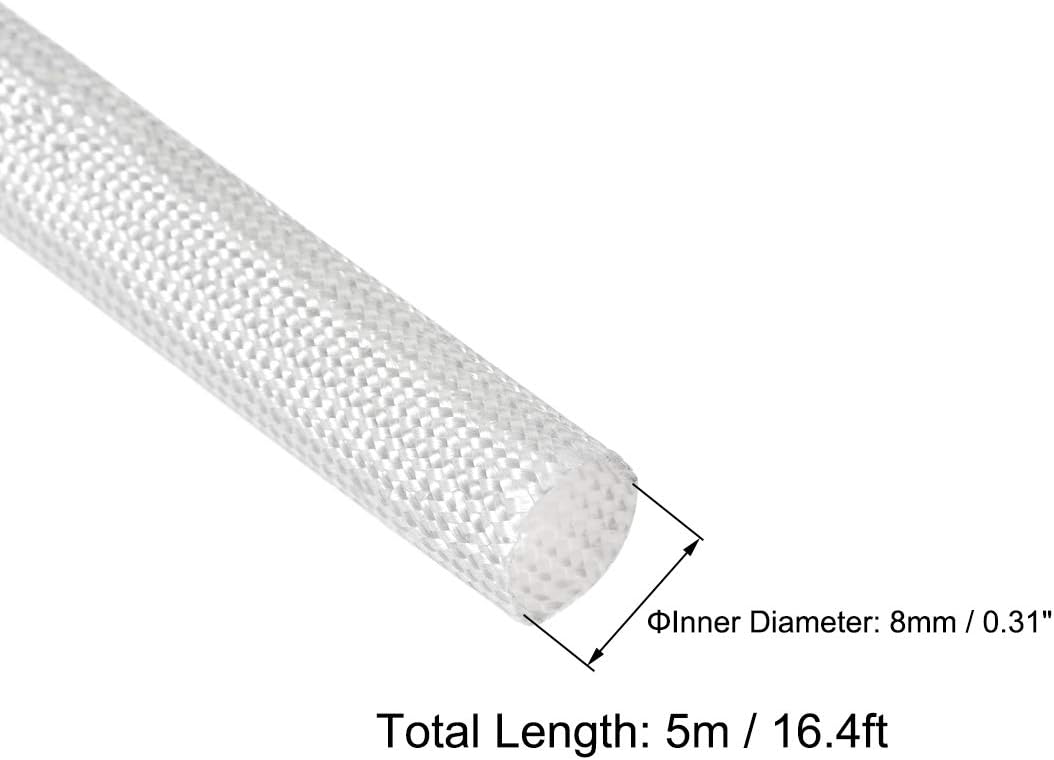

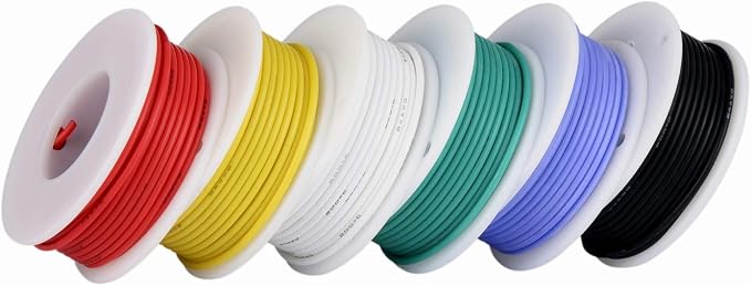

Here you go. You will need one each of the Amazon Items and two each of the plugs. If you want to source the plugs elsewhere, the Bosch numbers are:
Bosch - 1928403453
Bosch - 1928403736
Insulation Sleeve - Amazon Insulation Sleeve - Amazon
Wire - Amazon Wire - Amazon
4-way sealed Plug Bosch BSK Connector Kit for Bosch MAP Sensor
4 Way Sealed Receptacle Bosch BSK Connector Kit for Bosch MAP Sensor

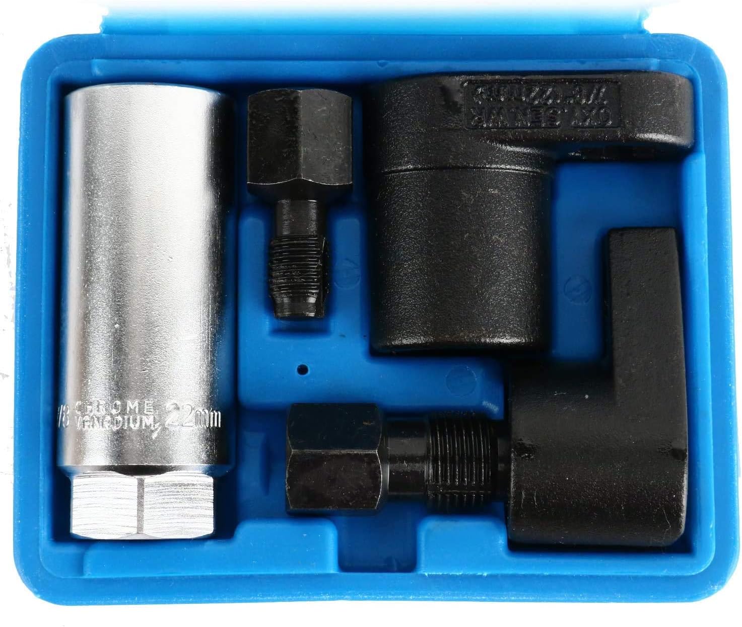

Yes they are. The 90 deg offsets come in two pieces. You screw the box section into the exhaust pipe, screw the sensor into the longer section, and then screw the two sections together. After you get the assembly aligned the way you want, you tighten the locking nut.

It is not difficult. You will have to remove the under-panel at the front of the engine and you will find the connectors mounted on the firewall. Additionally, you will need to snip some of the mounting zip ties to remove the existing harness. The job will be much easier if you have access to a 2 or 4 post lift. Below is a list of the items you will need from Amazon and Ballenger Motorsports bmotorsports.com. You may also need a terminal crimping tool. Let me know if you have any other questions.
https://www.bmotorsports.com/shop/pr...oducts_id/1625
https://www.bmotorsports.com/shop/product_info.php/cPath/109_136/products_id/3384​​​​​​​
https://www.amazon.com/dp/B07G744V5Z?psc=1&ref=ppx_pop_dt_b_product_details https://www.amazon.com/dp/B07G744V5Z?psc=1&ref=ppx_pop_dt_b_product_details
https://www.amazon.com/dp/B076QBZ6YY?psc=1&ref=ppx_pop_dt_b_product_details​​​​​​​ https://www.amazon.com/dp/B076QBZ6YY?psc=1&ref=ppx_pop_dt_b_product_details​​​​​​​
https://www.amazon.com/dp/B01JIFVVYG?psc=1&ref=ppx_pop_dt_b_product_details https://www.amazon.com/dp/B01JIFVVYG?psc=1&ref=ppx_pop_dt_b_product_details
