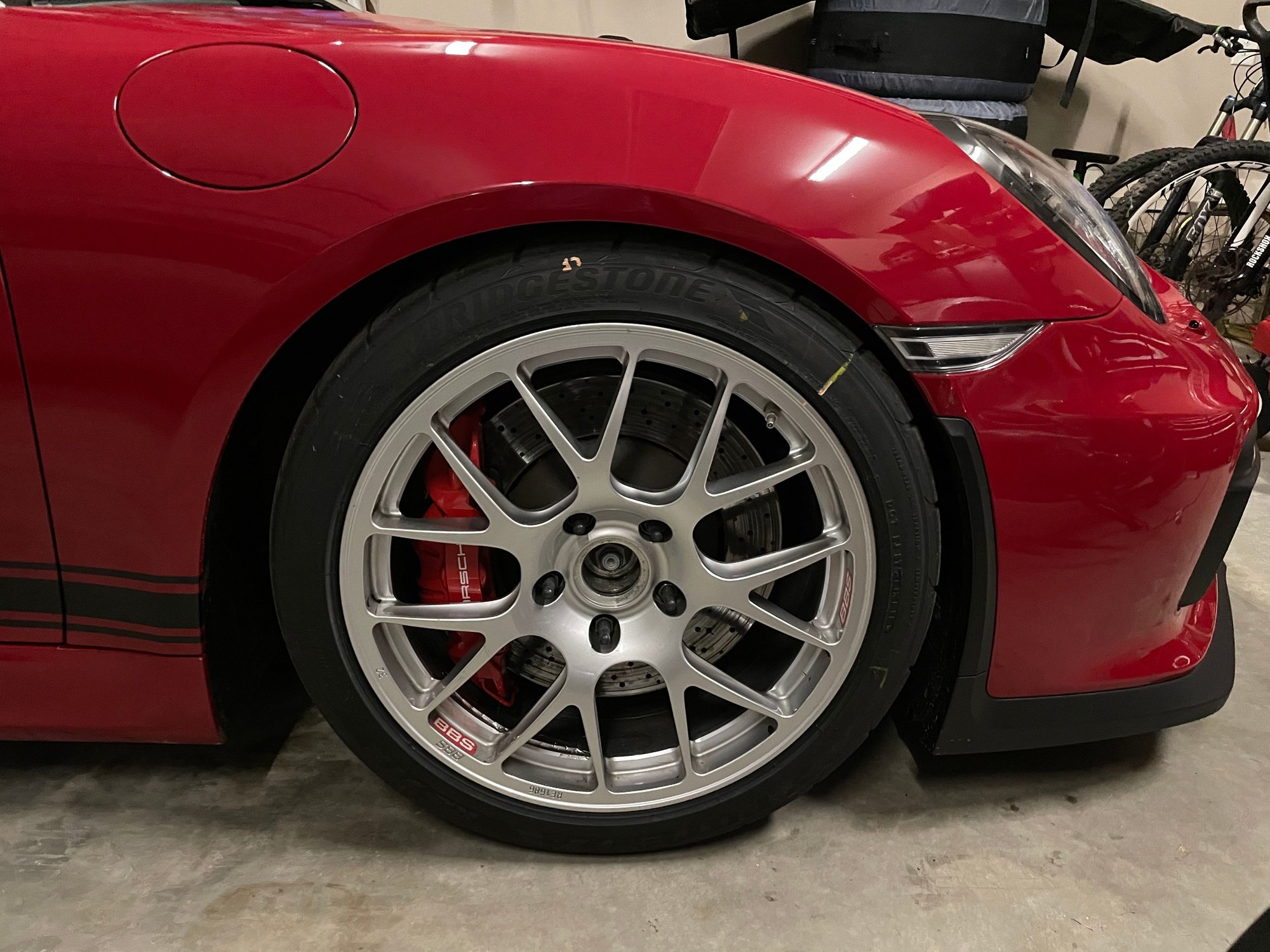

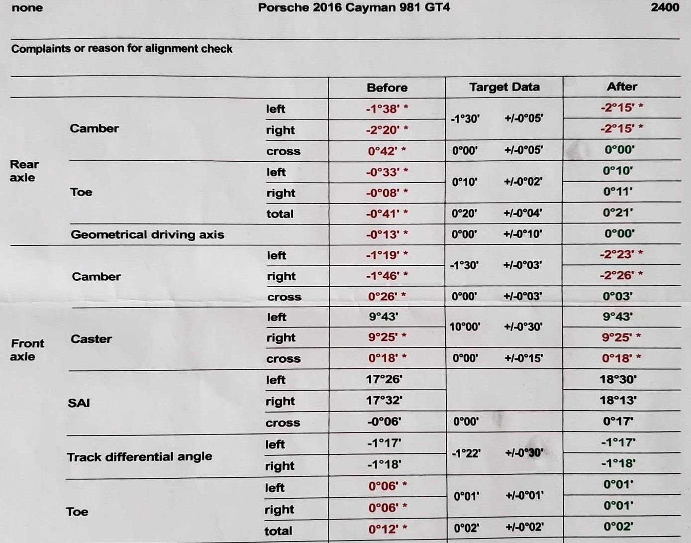

I just had some additional suspension parts installed, RSS thrust arms, caster pucks and LCA monoballs. Had the car aligned by the shop who did the install, and I’m afraid it doesn’t look right. Specifically the caster looks off. I was assuming my caster should be at 8.5-9ish. I spoke to the shop, and they assured me 11 degrees of caster is acceptable. I feel like I’m going to rub at the track under compression. Anyone have any pointers? I’m leaning towards getting my car realigned bu another shop.

I agree that you have too much caster but it may not rub. With the parts you had installed it should be easy to adjust correctly. Did you add rear toe links?

Looks to me like your shop is clueless on how to install/align the caster pucks. 10 will not rub but I'm not sure if 11+ will. Those wheels look way too much forward in the well. Not only that but that setup will also inhibit your turn-in on track. Look at this analogy from the motorcycle world: Sport vs chopper. Which one will be easier to turn.
That would be a redo for me.

Factory spec is 10° +/- .5°
9.5 - 10 looks a little pushed forward and with the caster pucks it should be easy to get within factory spec or whatever you prefer.
not sure where you got 10... I read the ‘factory spec’ is 8.5

It’s right on the sheet LOL. And of course the service manual
More helpfully this is what my car came with which includes 17mm front shims and 12mm rear shims (RSS rear toe links). Supposedly set up by a guy from Pfaff.
Note that these are in degrees and minutes. So 10° +/- 30’ == 9.5-10.5

Looks like they might have used the wrong hole in the caster puck. Definitely redo!
Btw, which BBS wheels are those? They look great.
strange my dealer said caster from factory was 8.5-9. Thanks for the info.
yeah that’s what I’m thinking too.
They are BBS monoblocks.
