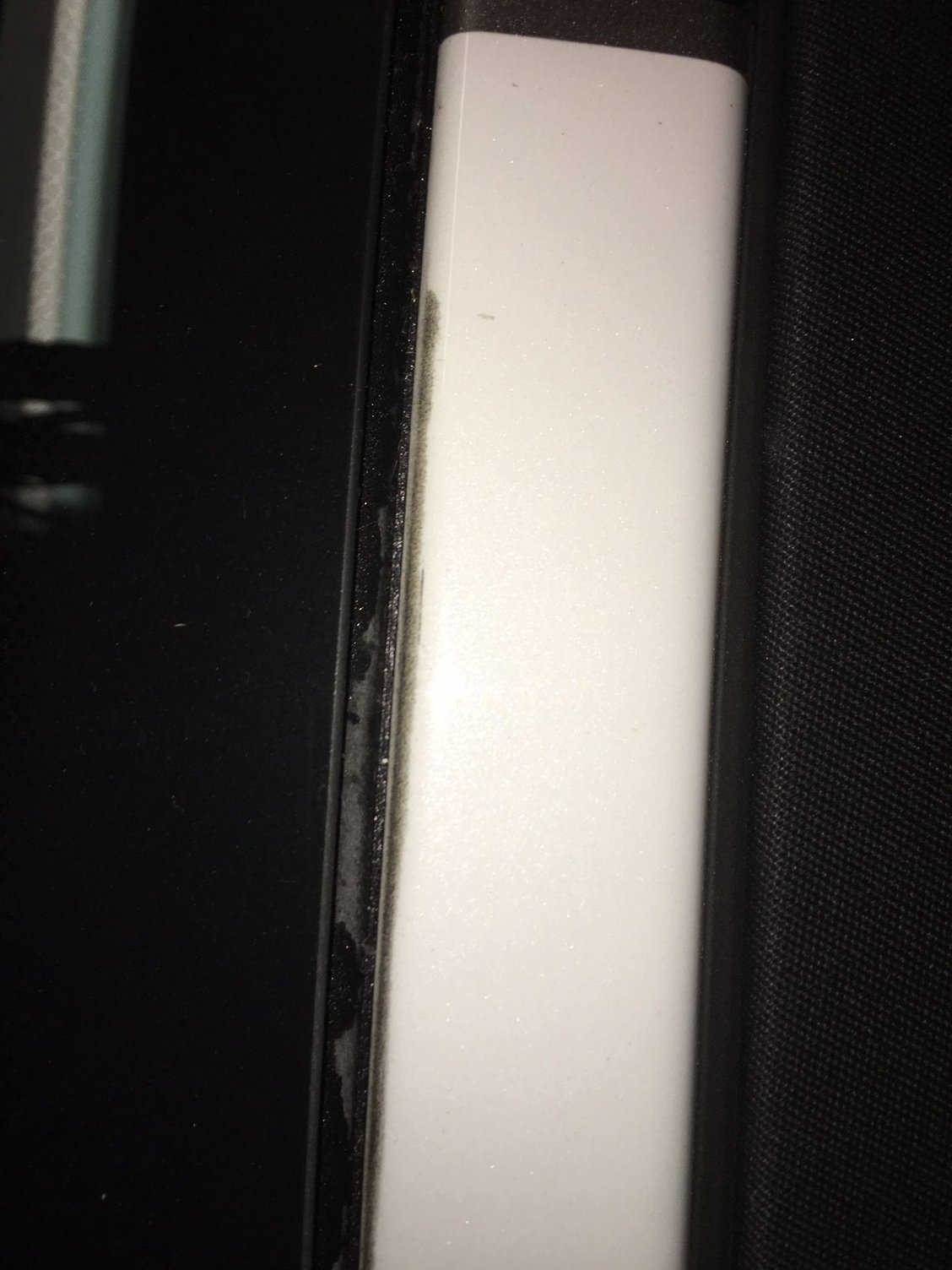

Old Apr 30, 2019 | 03:00 PM
SpyderSenseOC's Avatar
SpyderSenseOC
Joined: Dec 2017
Posts: 3,417
Likes: 1,417
From: Orange County, CA

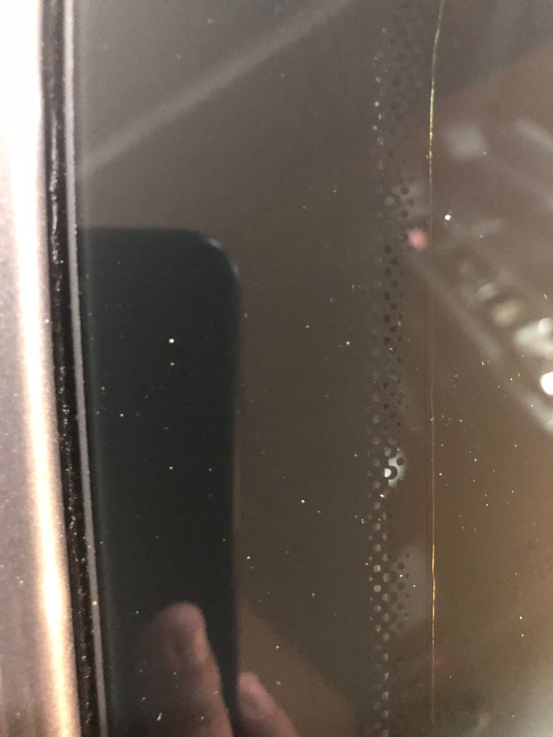

Old Apr 30, 2019 | 04:02 PM
john981's Avatar
john981
Joined: Oct 2018
Posts: 1,028
Likes: 357
This is mine after cleaning and touch up. Mine was never as bad as the picture in the last post. I had the car with one of the dealerships and they told me that they have never seen something like that and there is nothing they can do. Great Idea to call Porsche North America, I will just try it and see what they say.
