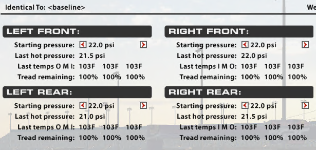

In addition, here's the setups:
BASELINE (that everybody has):
Updated VRS set that felt "ok" at Watkins (and I generally use this one to start with):
Still not ideal, but there's much more front grip than baseline. Essentially understeers everywhere you're not on the brakes... except at random times the rear wants to snap. Trimming out the rear wing doesn't seem to do much of anything at the nose.

Sorry...i wasn't aware we were starting with the baseline. I just reviewed the baseline and the one you're using. I went and played some last night and if you can send me an email i can email you that setup. I even downloaded another setup online but i didn't like it and went back to the one i was tinkering with last night.
My notes are as follows:
- you want as close to 46% bias as you can so that you can actually band-aid the understeer issue AND carry more brake pressure - otherwise we are fighting front lockup. i had the worst time sorting the brakes because i had the "brake assist" on and it kept releasing brake pressure every time it would get close to lock up. if you run that bias setting and use less brake pressure it should help some and you will see your theoretical lap time improving. as it stood the brakes sucked. I couldn't get it stopped to save my life. You should be able to get to the 200 marker or better in the bus stop in a car like this and i couldn't do it without almost wrecking every time until i adjusted the bias and turned off the assist.
- I think that you're going to find the happy balance on the front grip issue by tinkering with the tire pressures, camber and rear ride height. Something is creating an abundance of rear grip. I got it a lot better and am more than happy to send you my setup for you to try but i essentially played with the camber and then just kept raising the rear of the car.
- The aero is really only going to help under braking and any corner with more than 85+ mph min speed so at Daytona it's going to have an effect in the kink, the bus stop and a little bit in turn 6 but it's going to create more straightline speed trimming it out. but i don't know if it's enough because Daytona has long braking zones and if you can stop in a shorter distance sometimes it's more of a benefit than an additional 1mph. It may create 1 mph or 2 mph but if you have to roll 5 mph less through the bus stop then it's counterproductive. With the wing at 4 i think it's actually hurting you in the kink think because the car has so much rear grip it requires a tiny crack of the throttle if you aren't in exactly the right spot. I didn't get to try it below 4 but i can tonight. Every Cup car or Porsche track car is going to be the same way in the kink. the Clubsport makes 390hp and good grip and is barely flat through there. It can be done but it takes some conviction. On new tires on a grippy track it's a non-brainer but when the tires are worn and the track is slick, you can't just assume you can flat it UNLESS you're in a car with tons of downforce.
- the car makes more MPH than other GT3 cars even though it's not really a GT3 car like the GT3 R. i wonder if it's the reduced amount of aero relative to the other GT3 cars or what that makes the additional mph but i'm at 174mph at start/finish. truth be told, the MPH figures for all of these cars in the sim are wrong. you can't be doing these lap times and be down 5 - 7mph at start/finish - the DPs should be doing 195+. I think though that possibly just the rollout or the speedo is the issue.
Those are my notes from last night. Send me that email and i can send you my setup and you can see if you like it. At the end of the day we are relying on the software engineers to have the same exact understanding of these cars as we do. What works in real life may not work all the time in the simulator but just like in real life you have adjustments with a range of motion. Move them in singularity from one end of the spectrum to the next and see what works.
Yeah brake bias was one of the first things I figured out. The default 47.5% is almost impossible to drive. When the car was first released I dropped it down in the 43-44 range... which let the car stop, so long as you didn't turn the steering wheel. The more I drove it, the more I found that somewhere in the low 46's was about right. Any higher and you can't stop, any lower and you can't trail brake.
I assume they modeled (perhaps with questionable accuracy) whatever Michelins the Cup ships with? In the "real" car anyways - what's the usual optimal pressure? I think I've honed in on ~25psi hot.
Interesting thoughts on the aero, and not trying below 4. I'm not sure I can really tell much of any significant difference in balance between 1 and 5.
Does the real-life car really understeer as badly as it does in-sim?
