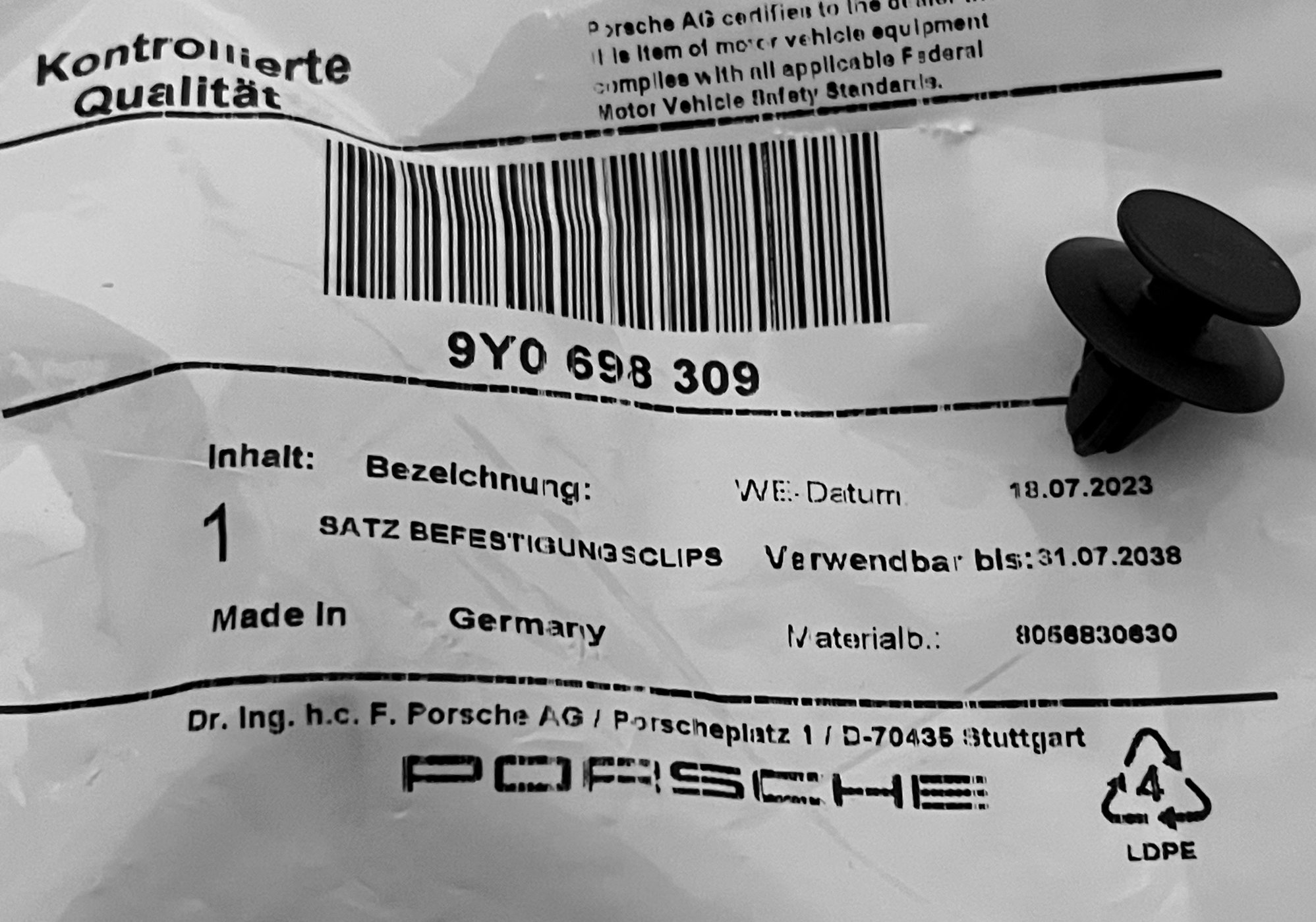

3/ This cover uses different clips than those in previous models (green). They can only be purchased as a complete repair kit.
4/ Assuming that all the oil is drained to a full fill to a maximum level of 100%, 9.5 liters of oil are needed.

Do you happen to have the part number for the repair kit?
Also, I believe it’s smart to have 10 quarts (9.42 liters) on hand for both 9YA and 9YB. Knowing these engines, what you don’t use will be asked for in 2000 miles.
Here is the repair kit. However the "repair kit" name is exaggerated. It is the set of only 3 clips but in Porsche price. Around $10 per small, one piece, plastic clip, $30 for the entire "kit" . Such a things possible only in Porsche.
