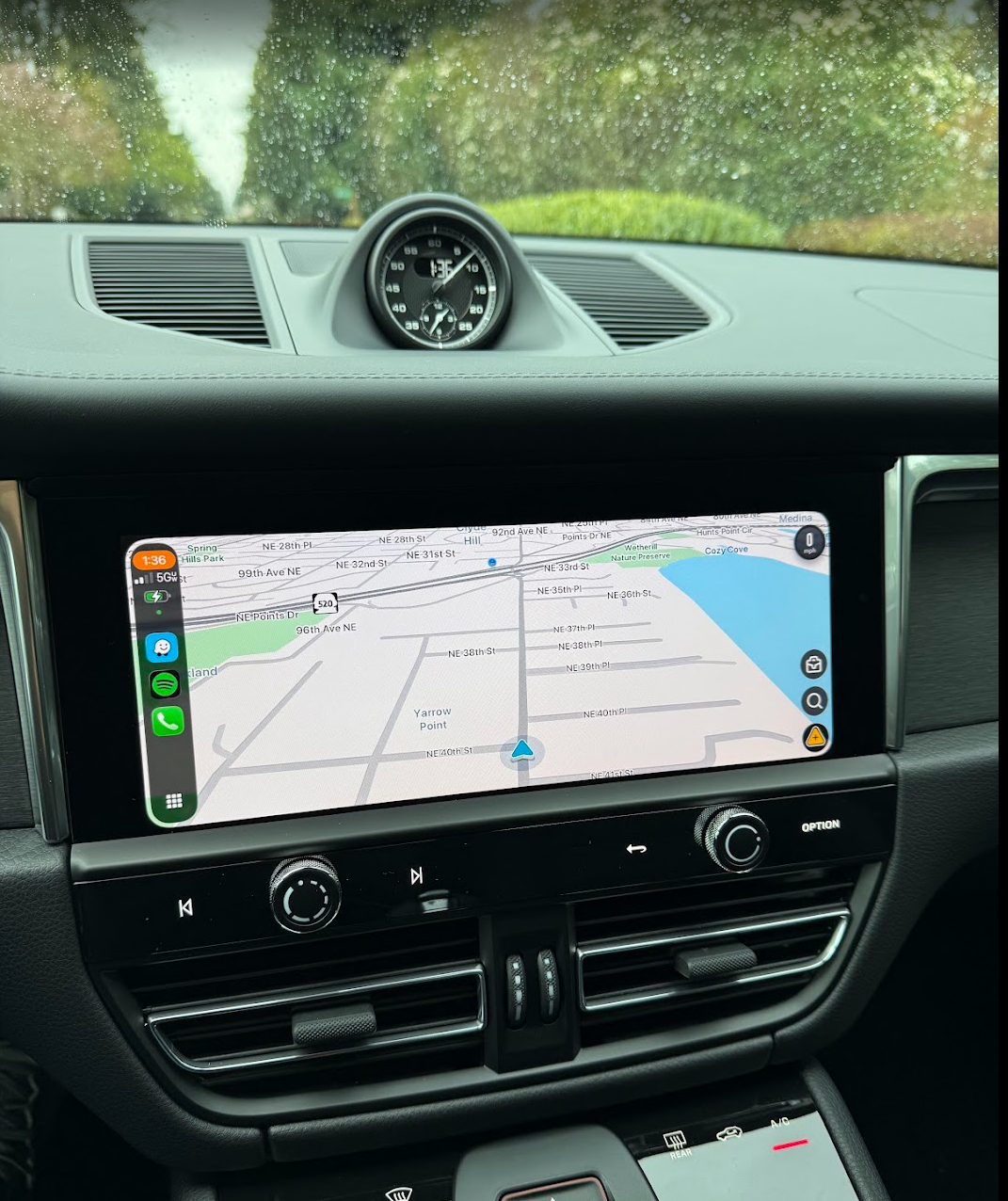

Huge thanks to @CarmineS and his crew of volunteers. Just did this mod to our newly acquired 2026 GTS. HUGE improvement (went with the full screen option). A scary 6 minutes, but so far so good. Thank you!
