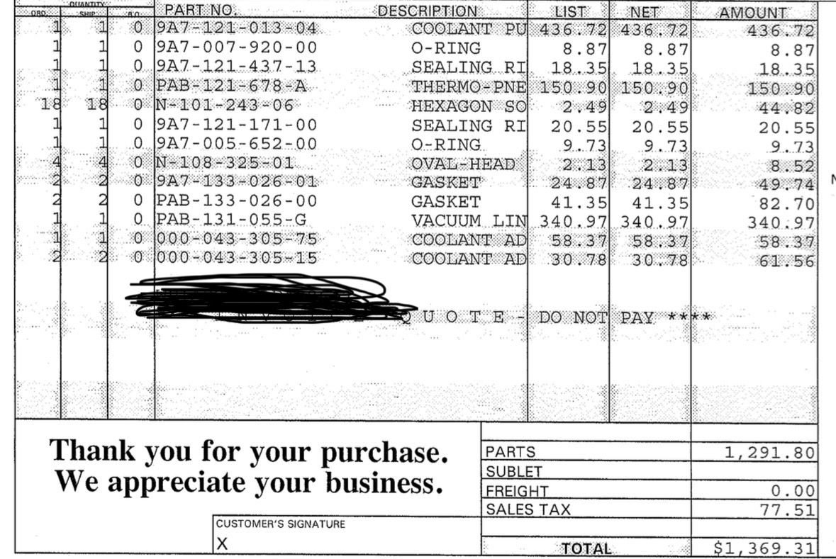

Pro forma invoice for parts and labor sent by SA as a quote if it was paid by the customer/not warranty.
$2270.50 labor
$1369.31 parts
$3639.81 total
Looks like 9 or 10 tech hours. Does not include vacuum pump replacement.
If caught early enough this looks like a <$2,000 DIY job doable over the weekend.
Catching it early means frequent reservoir level checks and close inspection of water pump and shutoff valve from above and below using a bright LED flashlight, looking for signs of dried coolant.

For giggles I looked up parts listed above:
9A7-121-013-04, water pump, $249, Sunset
PAB-121-678-A, valve, $86, Sunset
PAB-131-055-G, vacuum lines, $222, Porsche Chandler
Savings of $372 for the three listed parts, or 27% off the total parts bill.
In summary the water pump, valve and vacuum line job could be done ~$1,000 DIY in a weekend.
Cost is not bad. Challenge is the short lifespan of the pump and sensitivity of needing to keep an eye out for leaks.
