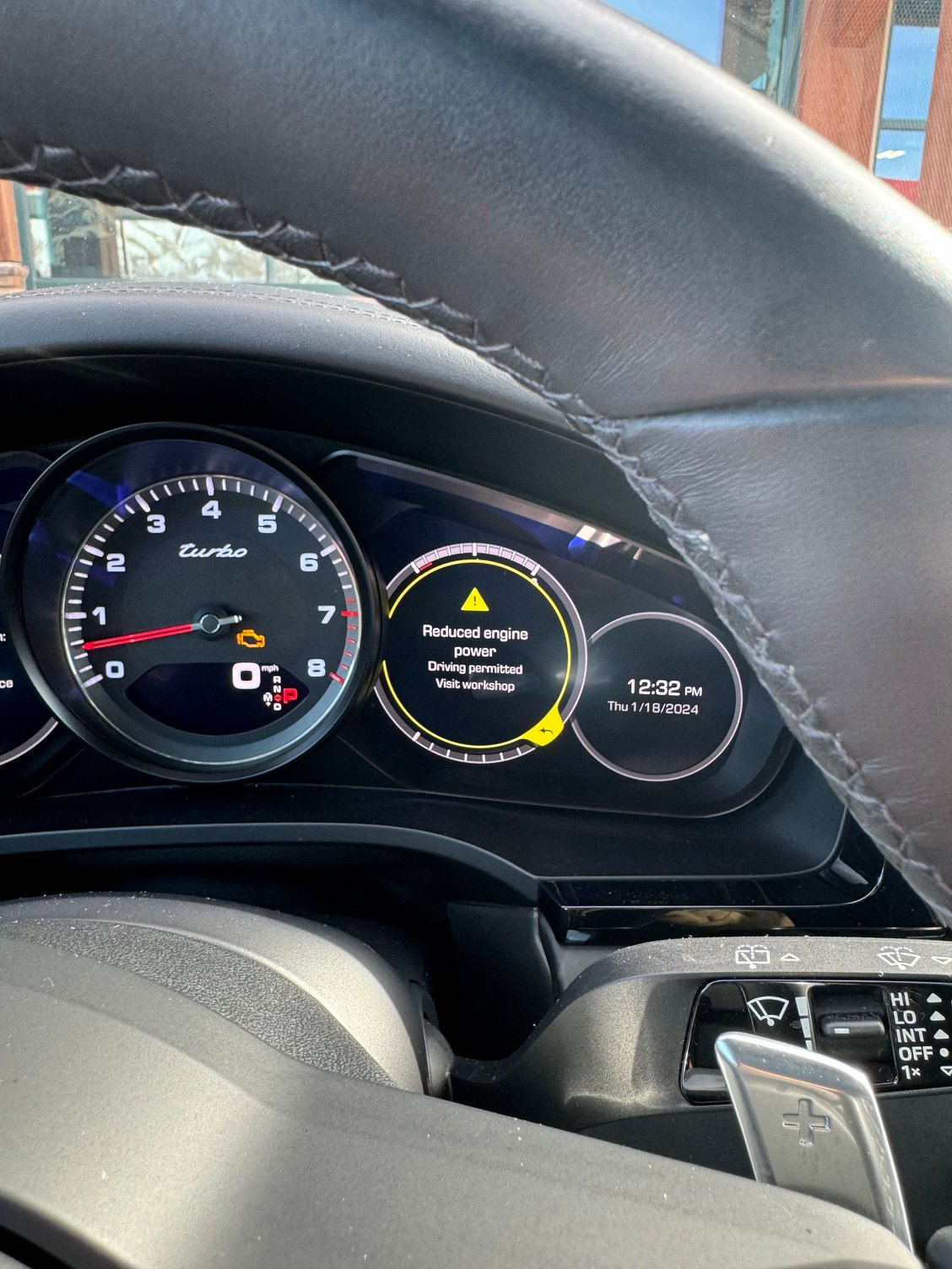

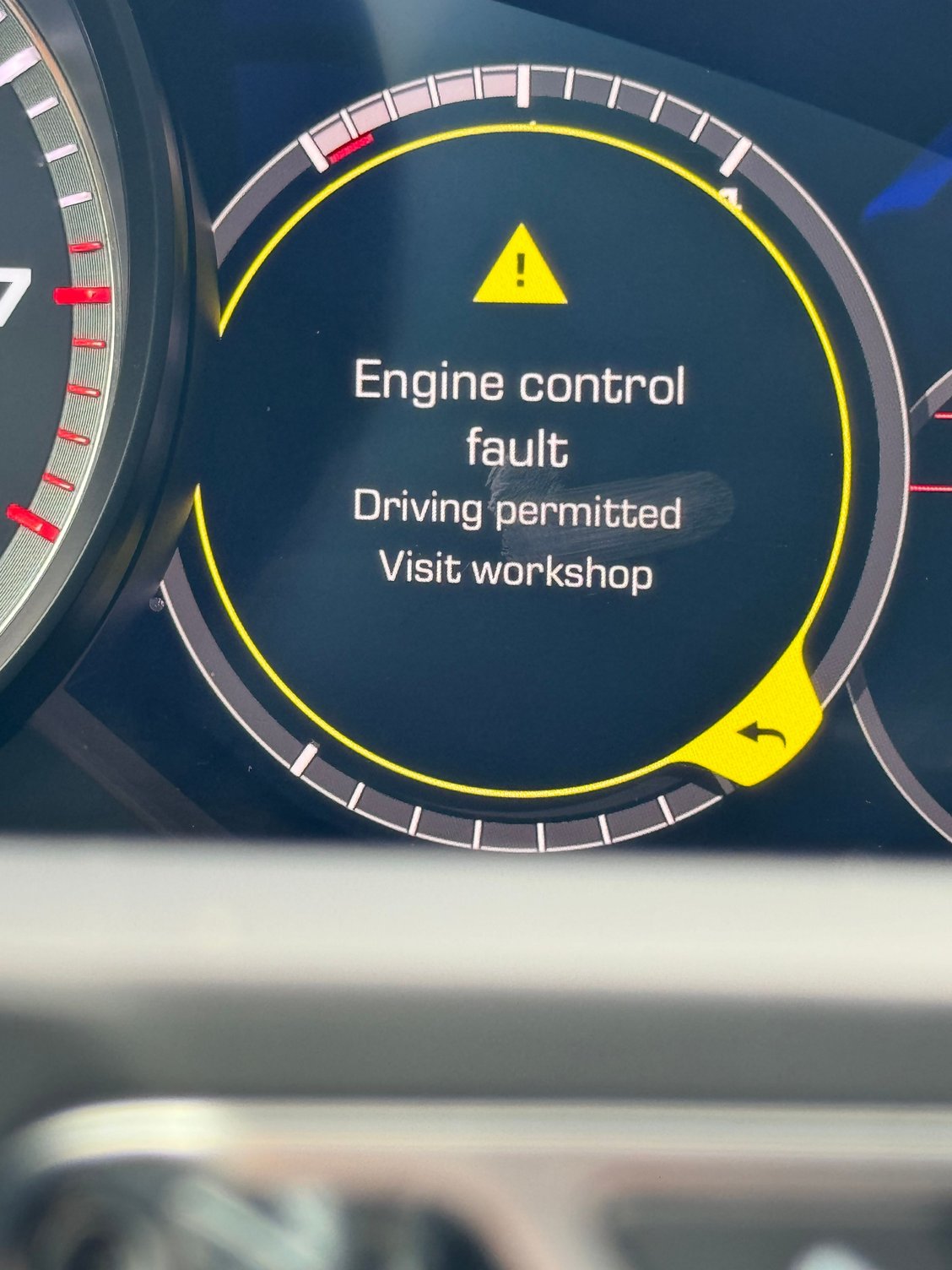

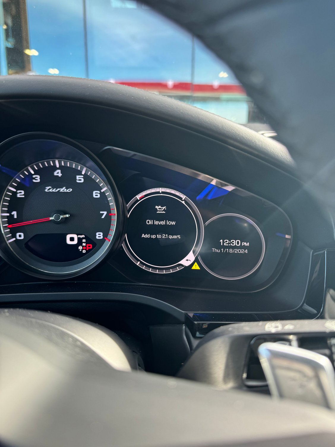

New here and new to Porsches. Looking for advice. I purchased my 2019 Cayenne Turbo on Tuesday and was driving it back home on Thursday when it threw a “Reduced Engine Power Permitted to Drive” code along with a “Low Oil Level Add 2.1 Quarts” code.
I called my dealer and added 2 quarts of Full Synthetic W30 (best they had at the gas station). This took out the “Low Oil Level code” but the other remained. After speaking with the dealership, I decided to drive the car home to Boise in limp mode for around 200 miles. I monitored engine and oil temps the whole way through - engine temp stayed at 194-7 the whole time, and oil temps reached 122 at the highest and then dropped. I was stuck in the middle of nowhere between Nevada and Oregon. It was the most excruciating drive of my life. I could barely do 30 on the uphill sections.
The next day I took the car to Porsche of Boise and they said they couldn’t even diagnose it without an appointment, and the earliest available is 01/29. Interestingly, I was able to drive the car pretty normally to Porsche of Boise, because it seemed to drive fine after a cold start but started vibrating above 2k rpm on the way back home. It seems the car is vibrating after warming up. I’m stumped. Later upon being advised by the dealer I purchased the vehicle from, I took it to Eurosport in Boise. Just as I was pulling up to their shop a new error message showed up “Engine Control Fault”. Eurosport also couldn’t check the car until Monday 01/22. I very slowly drive the car back home and parked it. I’ve barely put 700 miles on the car. It’s currently sitting in my garage and I am worried about what might be wrong with it. It’s also throwing the Start/Stop Error code, but I’m told that’s standard if the engine goes into limp mode.
Any insights or advice would be very welcome.

I get the low oil message on my Turbo twice every 10k miles. I drive in sport plus with high rpm’s 70% of the time though, its a bit annoying to have to go to the dealer every 4k miles for top up

I did make a couple of fast pulls right before the low engine oil showed up. But nothing major. I got excited about the new car.

I’d be pissed about the low oil fault - shows that the dealer doesn’t care enough to check such a basic item.
I’d be very concerned about the engine fault. I’m wondering about the history, especially if it was sold at a Porsche dealer without CPO.

Two quarts low, less than 7 days after you purchased it, is a big red flag in my view.
Something is wrong with this car. Obvious, but bears repeating. Do not take this car on a long journey until you know what is going on. Take it to AutoZone or Advance Auto, etc and have them scan codes for free, and post them here.

Just limped to O’Reilly’s and pulled codes.
P0305, P2279, P0300, P0308, P0307, P0306, P016A, P0305.
Seems like she’s misfiring on at least 4 cylinders. Plus there’s an intake leak. I’m stumped by the P016A.
The earliest a shop will take me is Monday/Tuesday at Eurosport, Boise. Porsche of Boise just turned me away without even pulling codes, gave me an appointment, and asked me to come back on 01/29. I’m very disappointed in that.

I got that same "Engine Control Fault -- Driving Permitted" warning on my Turbo GT while on a 500 mile trip. The problem was a defective exhaust sensor; cure was replacing it. In this mode, several features such as Cruise Control were unavailable. Check engine light went on, as well.
Good Luck.

Quote: . . . so I topped off with 2 quarts of Valvoline full synthetic w30. . .
Good news; it looks like Vavoline full synthetic is API-SP certified, meaning it is formulated to protect against LSPI. Regardless, you should still consider changing the oil, as it is the wrong spec and the wrong viscosity for your engine. I keep a quart or two of C40 spec oil on hand for top-offs. I carry a quart in my Cayenne when traveling, as it is generally only available at the dealership and Auto Zones.
