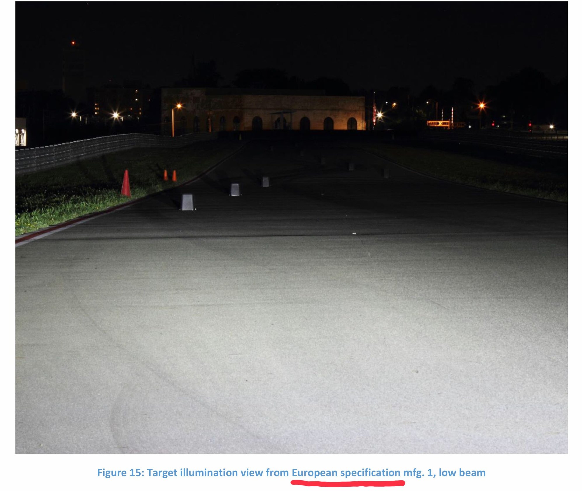

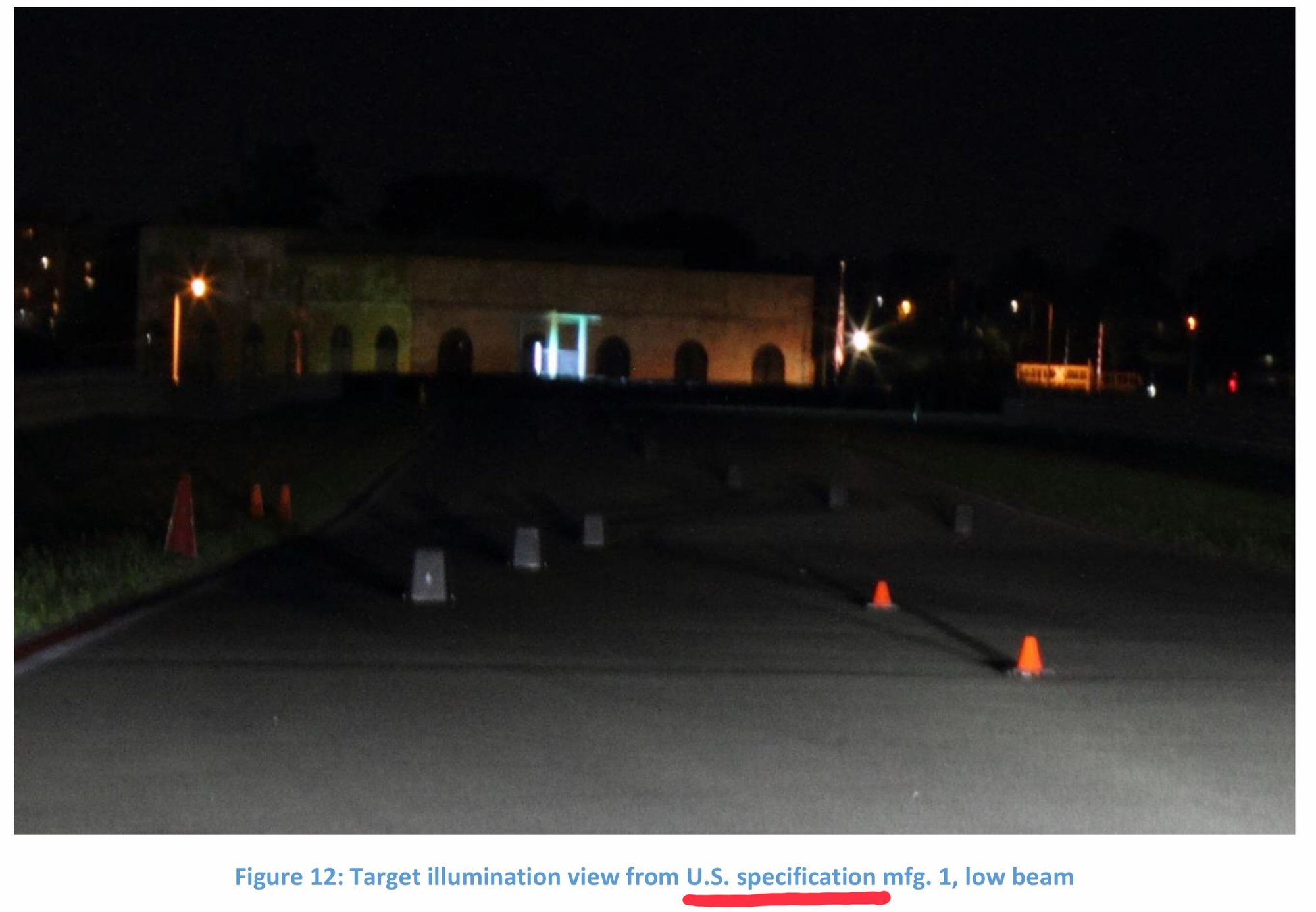

Indeed — European lighting standards (UNECE) allow over two times the light intensity from high beam headlight systems as compared to the U.S. The U.S. compliant systems allow a vehicle maximum of only 150,000 candela while European compliant systems allow a vehicle maximum of 430,000 candela.
However, US spec lights had equal or better perceived illumination on low beam, compared to EU lights. Read all about it in this comprehensive test entitled COMPARISON OF EUROPEAN AND U.S. SPECIFICATION AUTOMOTIVE HEADLAMP PERFORMANCE, available here:
https://www.aaa.com/AAA/common/AAR/f...SHeadlamps.pdf
