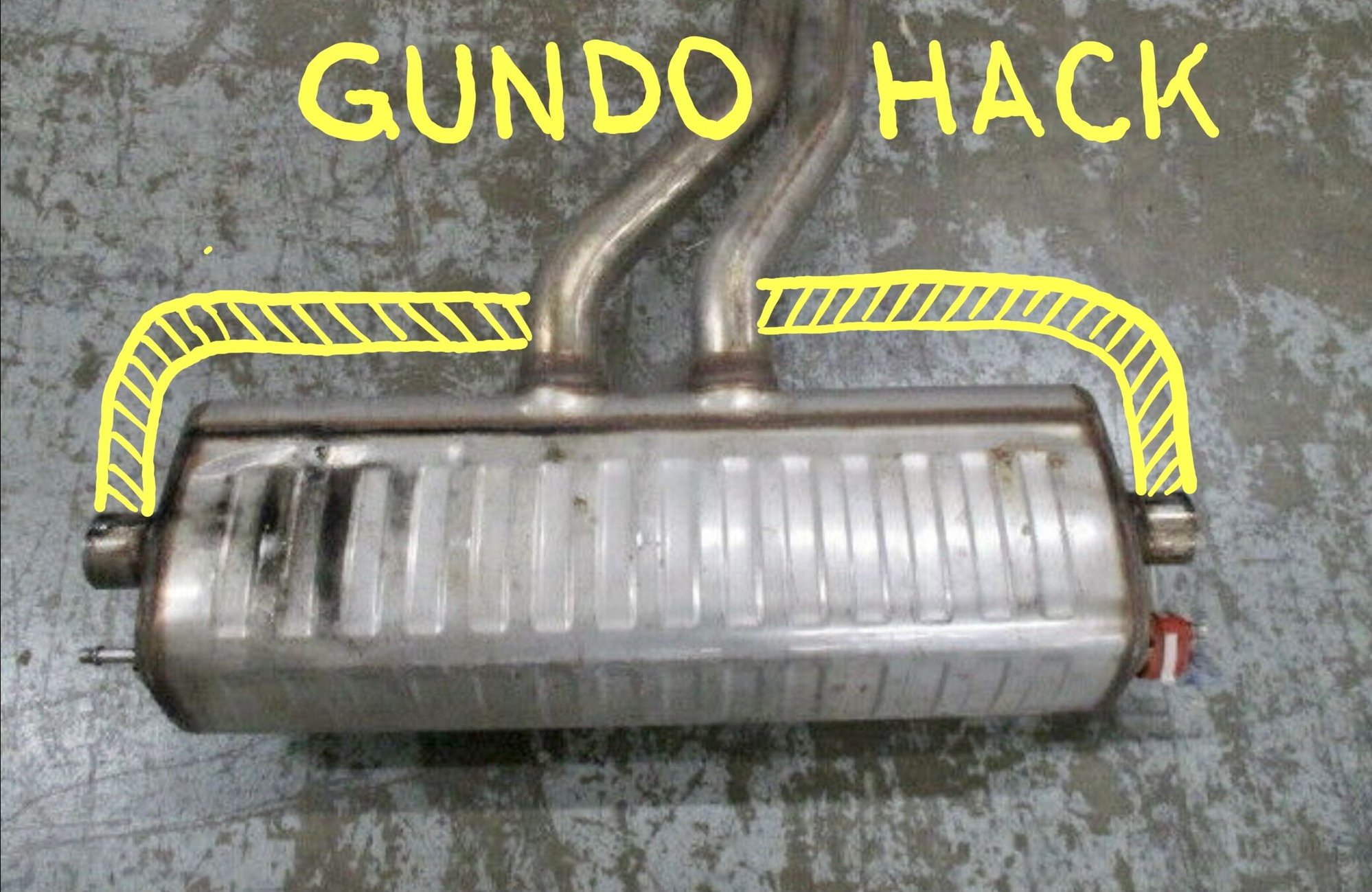

Check out the Gundo Hack muffler bypass. Here’s a thread from 6speed describing it. It’s a less than $100 DIY or about $200-300 at a muffler shop. Scroll to post #6
https://www.6speedonline.com/forums/...o-welding.html
Sound is subjective — you may or may not like it. Here’s a video: Scroll to 0:30 for description and then 5:10 for sound on couple acceleration runs.

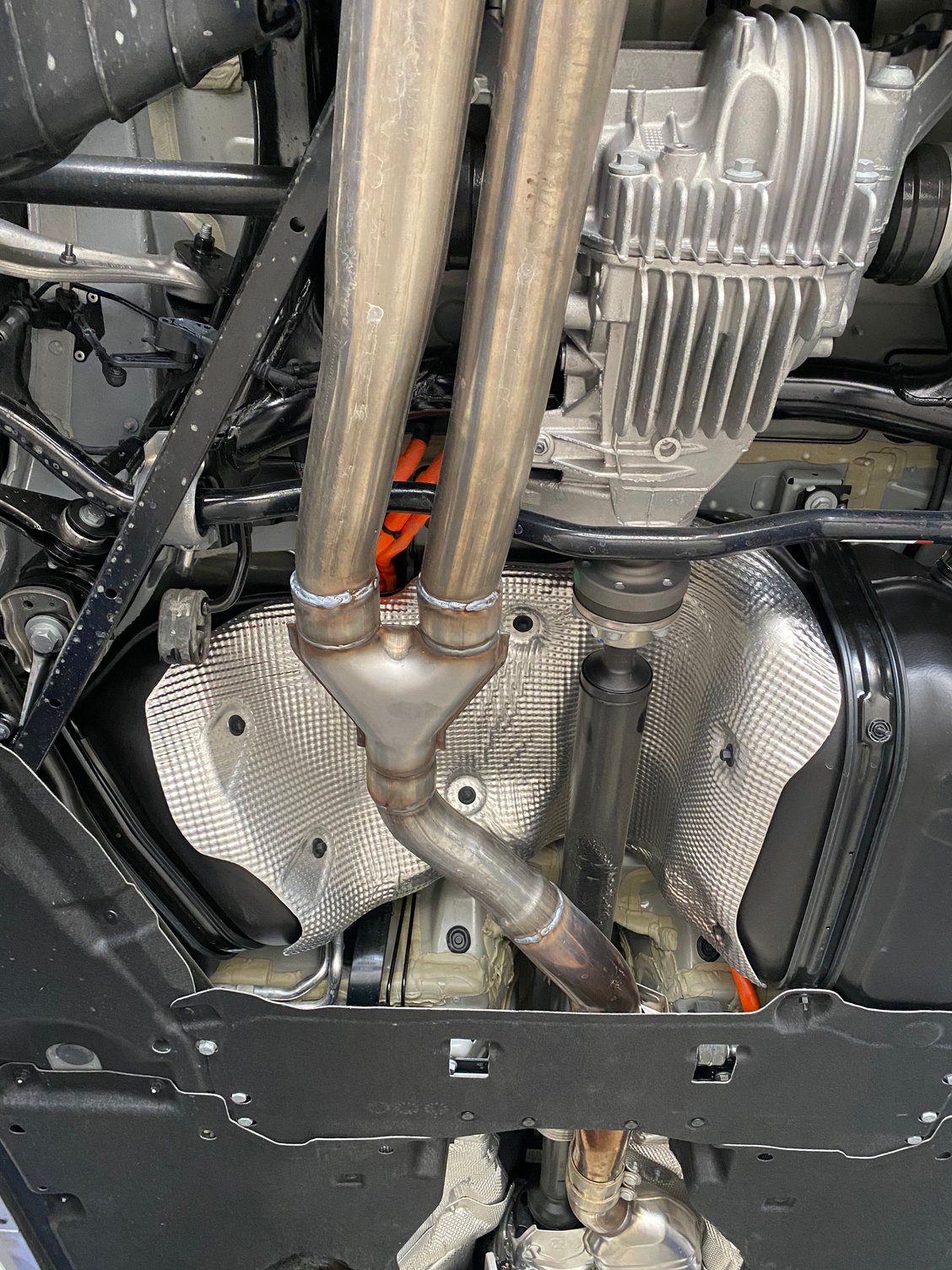

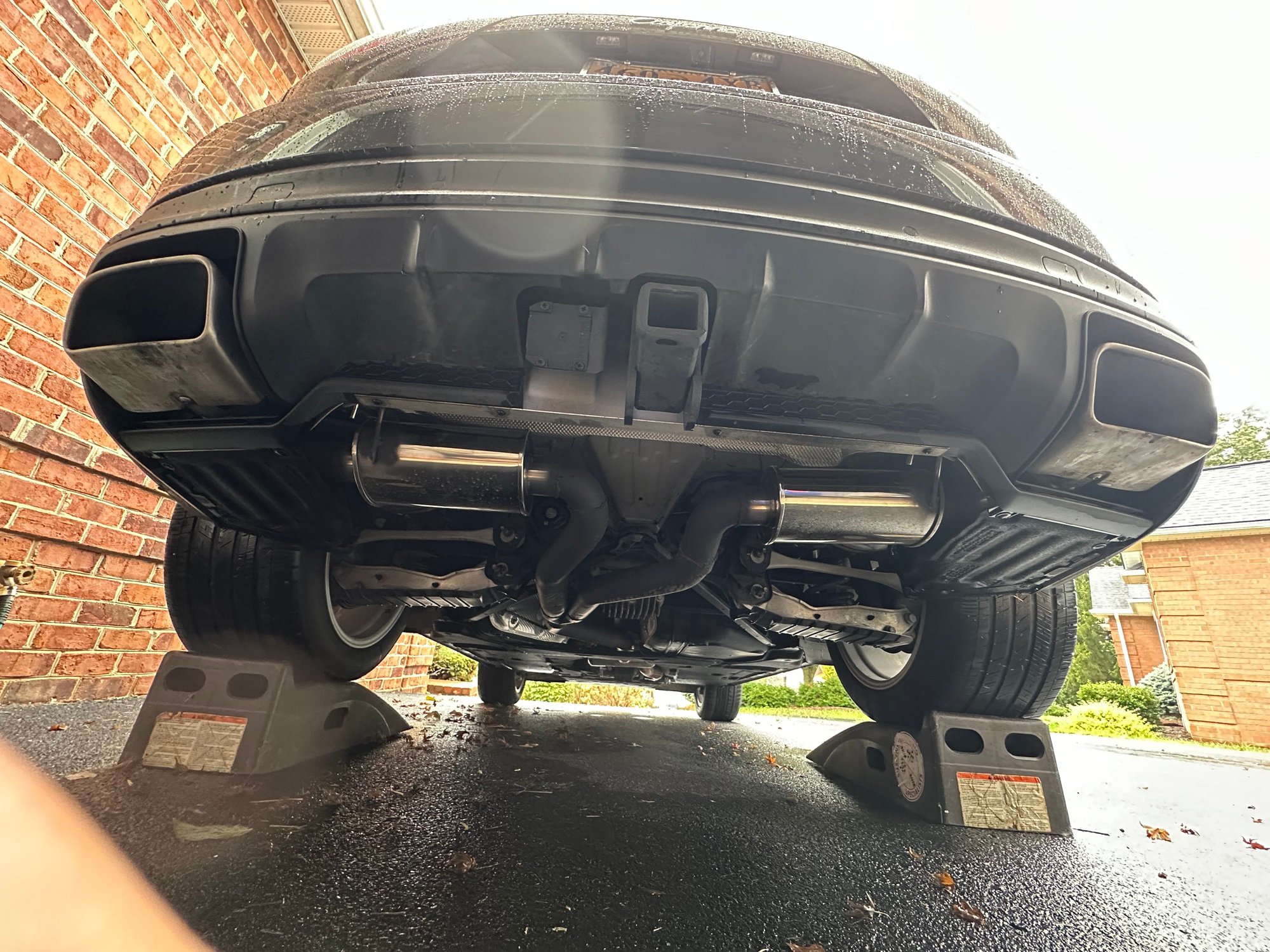

Don’t delete the second resonator as pictured above. It’s a straight through Helmholtz resonator, so it’s only job is to reduce drone. Deleting it will not add any meaningful sound just cabin resonance/drone and it also won’t add any power as it’s literally a straight through y-pipe.

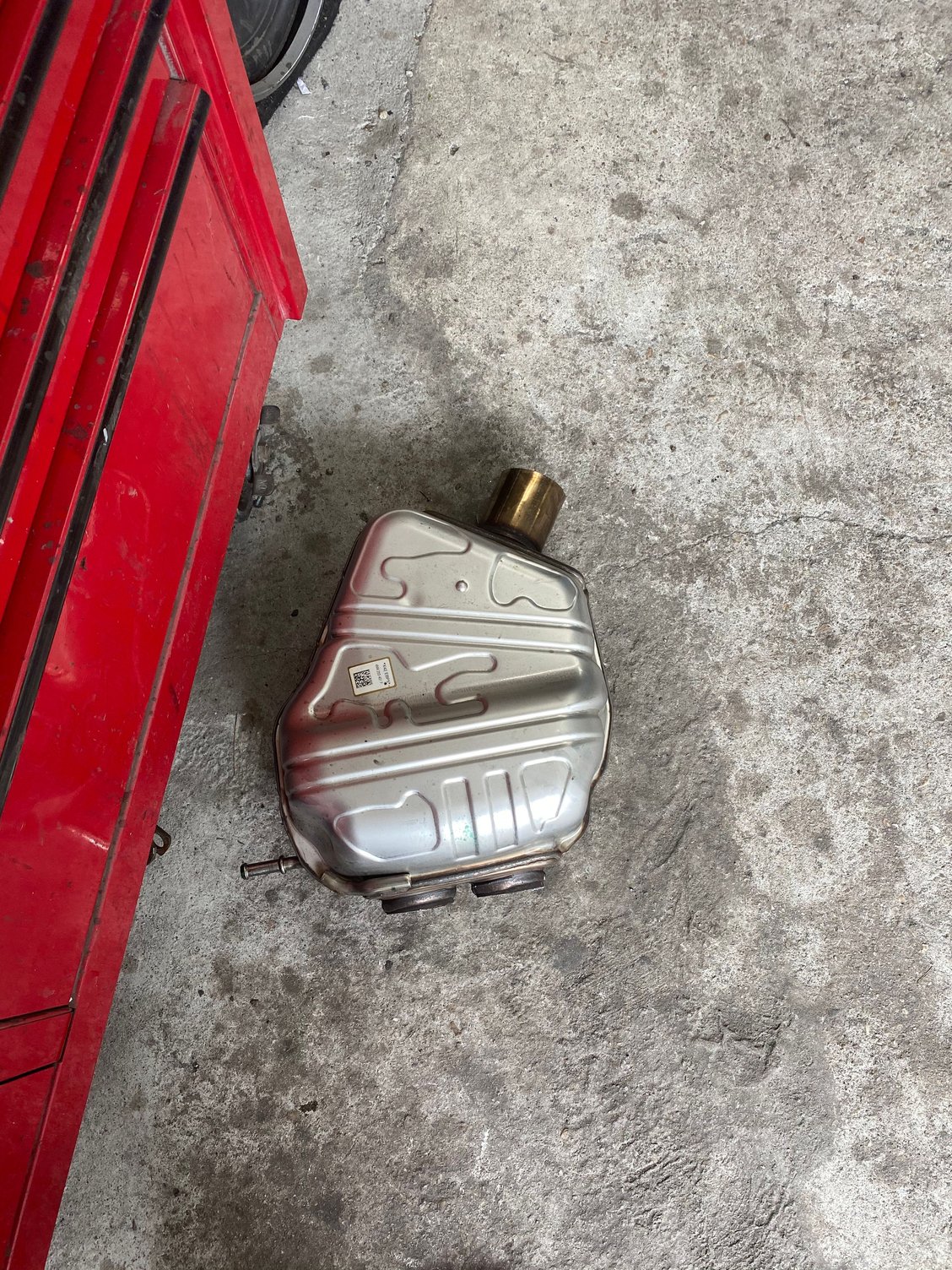

I deleted mine, and it was just a waste of money. But what I did do was remove my rear muffler and replace it with two vibrant ultra quiets. That made a significant difference.

The front resonator is straight through too, so don’t waste money deleting it if you’re doing it for flow.

Custom job. It’s only DIY if you can weld.
I replaced the front resonator with a 3” Vibrant Ultra Quiet resonator/muffler #1142 $138
I deleted the 2nd resonator and replaced it with a 3” to dual 2.5” merge collector. $60
I replaced the rear muffler with two Vibrant 2.5” Ultra Quiet resonator/mufflers #1141 $112 each
I didn’t want the shop to use a crush bender, so I bought a 3” 45* (Vibrant 13102) for where the 2nd resonator was, and two 2.5” 90* (Vibrant 1305) bends for the rear and made them reuse as much of the factory pipe as they could.
Total labor at my local muffler shop was $540.

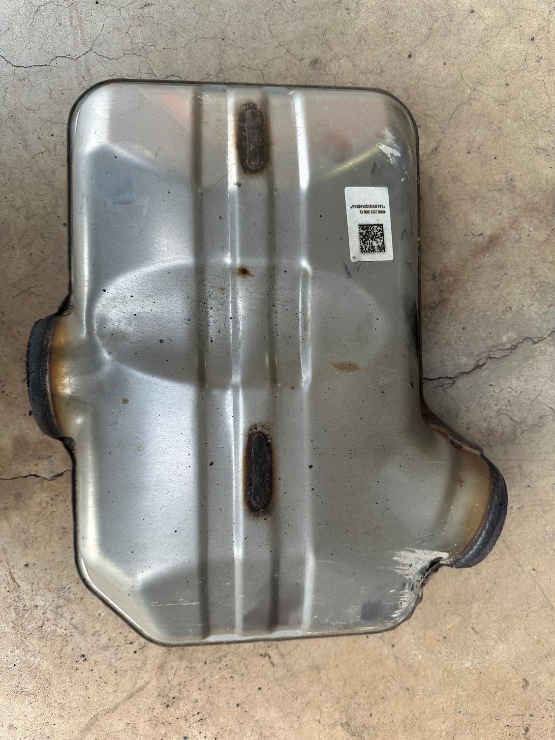

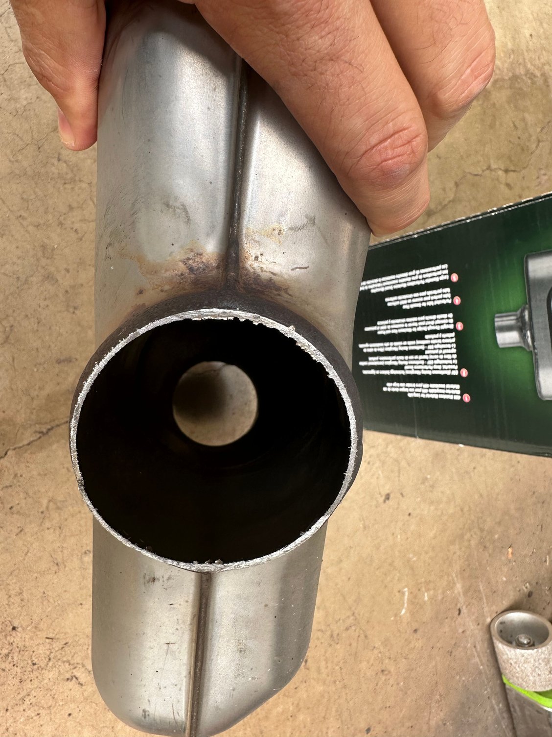

Hindsight being 20/20, I would leave the stock resonators exactly where they are and only replace the rear muffler. The stock resonators are built like tanks, and they are straight through hybrid Helmholtz/perforated core designs, so they do a ton to reduce drone with almost zero impact on exhaust flow.
