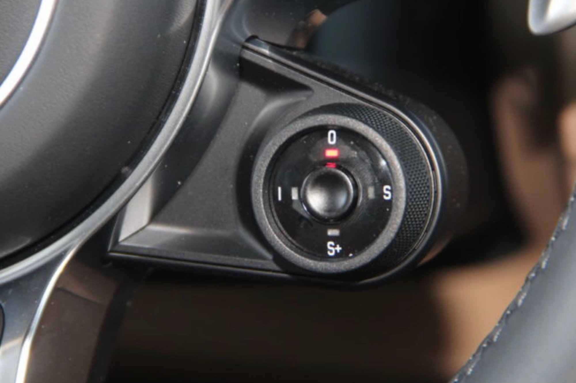

Launch Control, which Porsche calls Performance Start, is available on vehicles equipped with the Sport Chrono Package. You can easily see if you have Sport Chrono - you will have a Drive Mode switch on your steering wheel (pictured, below).

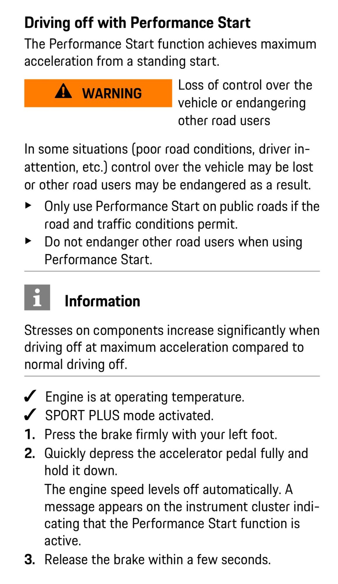

To activate Performance Start you must first switch to Sport+ mode and your engine should be warmed up. See below for details on the procedure.

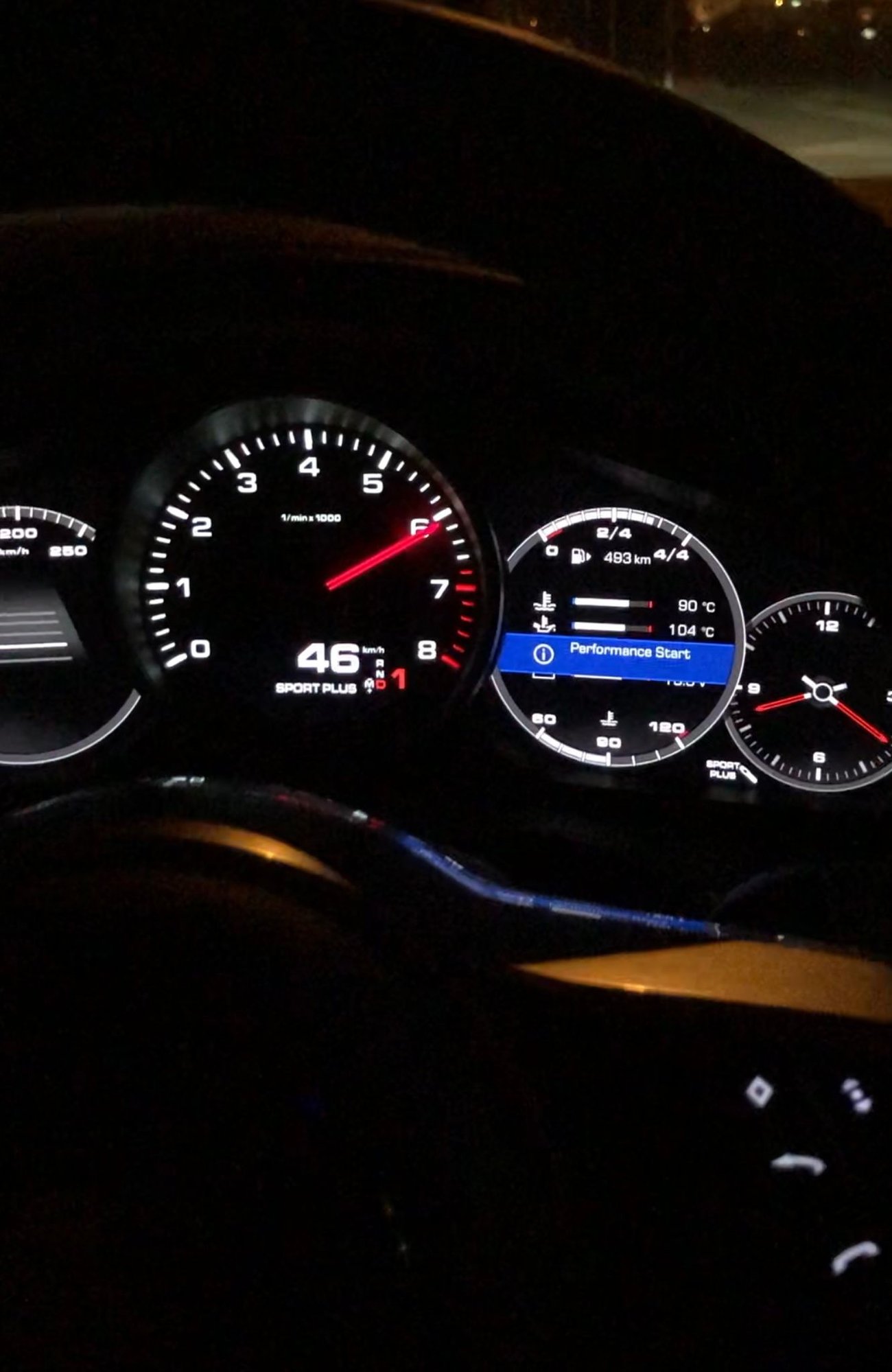

Once you press the accelerator to the floor, wait a second or two for the blue Performance Start message on the gauge as pictured. Then just release the brake and hang on. Have fun!

No worries, you can try again when you are ready. 😃 It sounds like you were slowly applying power. Next time, try pressing the gas pedal very quickly. The blue performance start message should appear in less than two seconds.

Finally Done ✅ 😊 thanks man 🌹🌹🌹🌹you are the best 😊😊😊
the key as you said to press the gas pedal fast 👍👍👍
