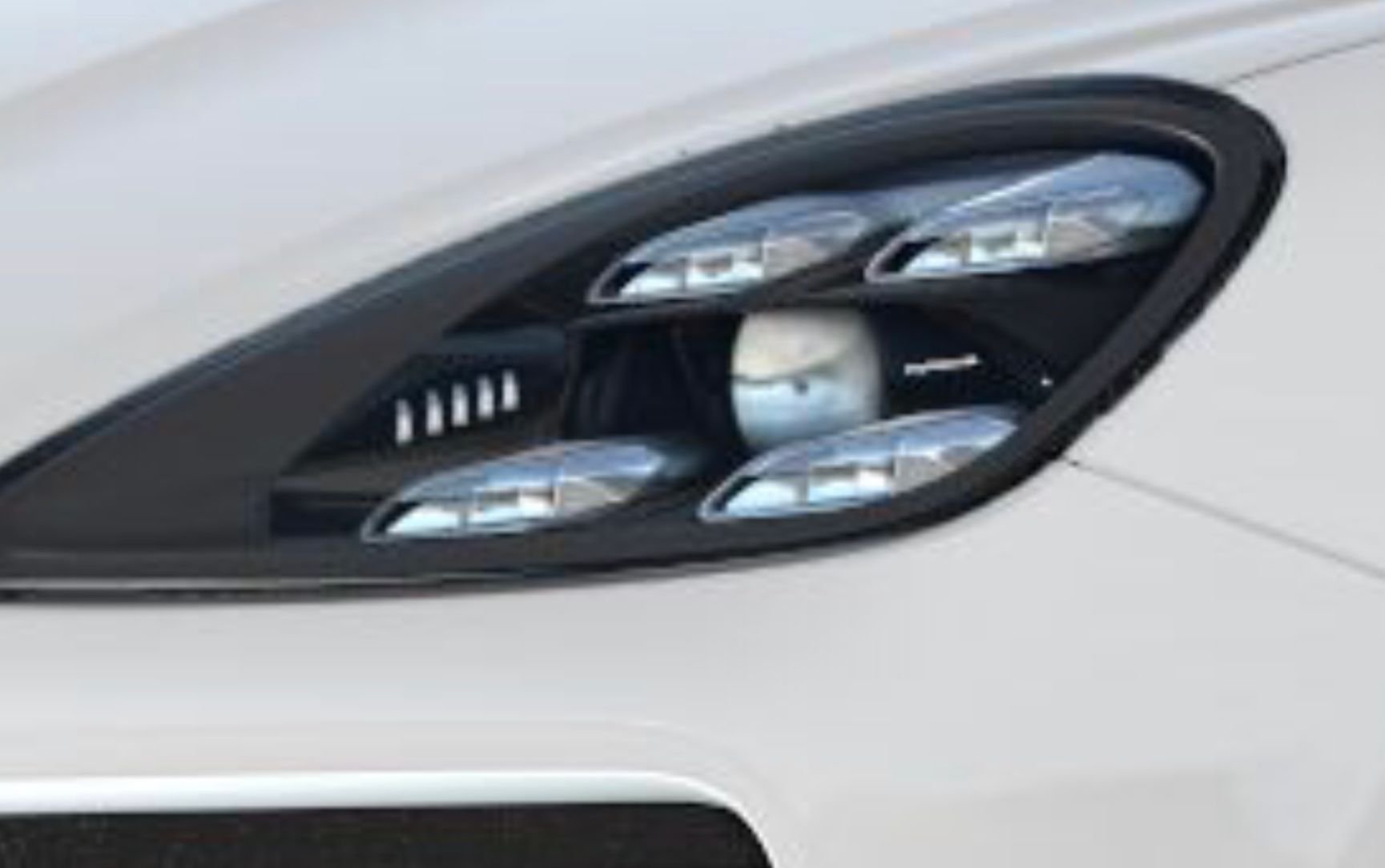

First, check that your Cayenne has the PDLS+ option. It is not standard equipment on the Base Cayenne. The PDLS+ headlights have a unique look as depicted in the picture, below. Second, determine if the PDLS+ is allowed in Kuwait. Not all countries allow the use of the active matrix feature (the +) of the PDLS+ lights. As Macanic posted above, our PDLS+ active matrix feature is disabled here in the USA. I looked online and couldn’t find if Kuwait allows them. If not, active matrix is deactivated on your Cayenne if it was delivered to Kuwait.

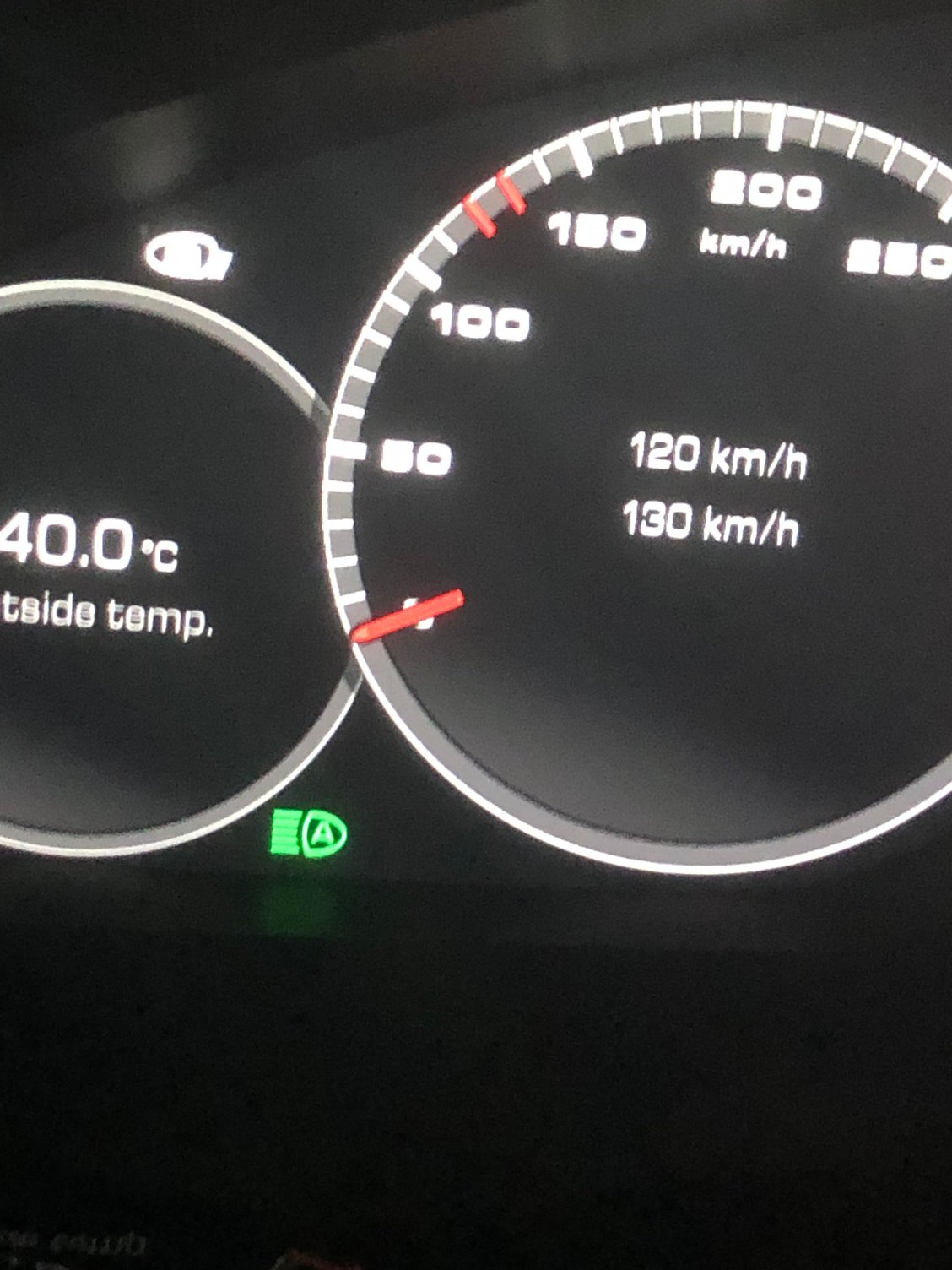

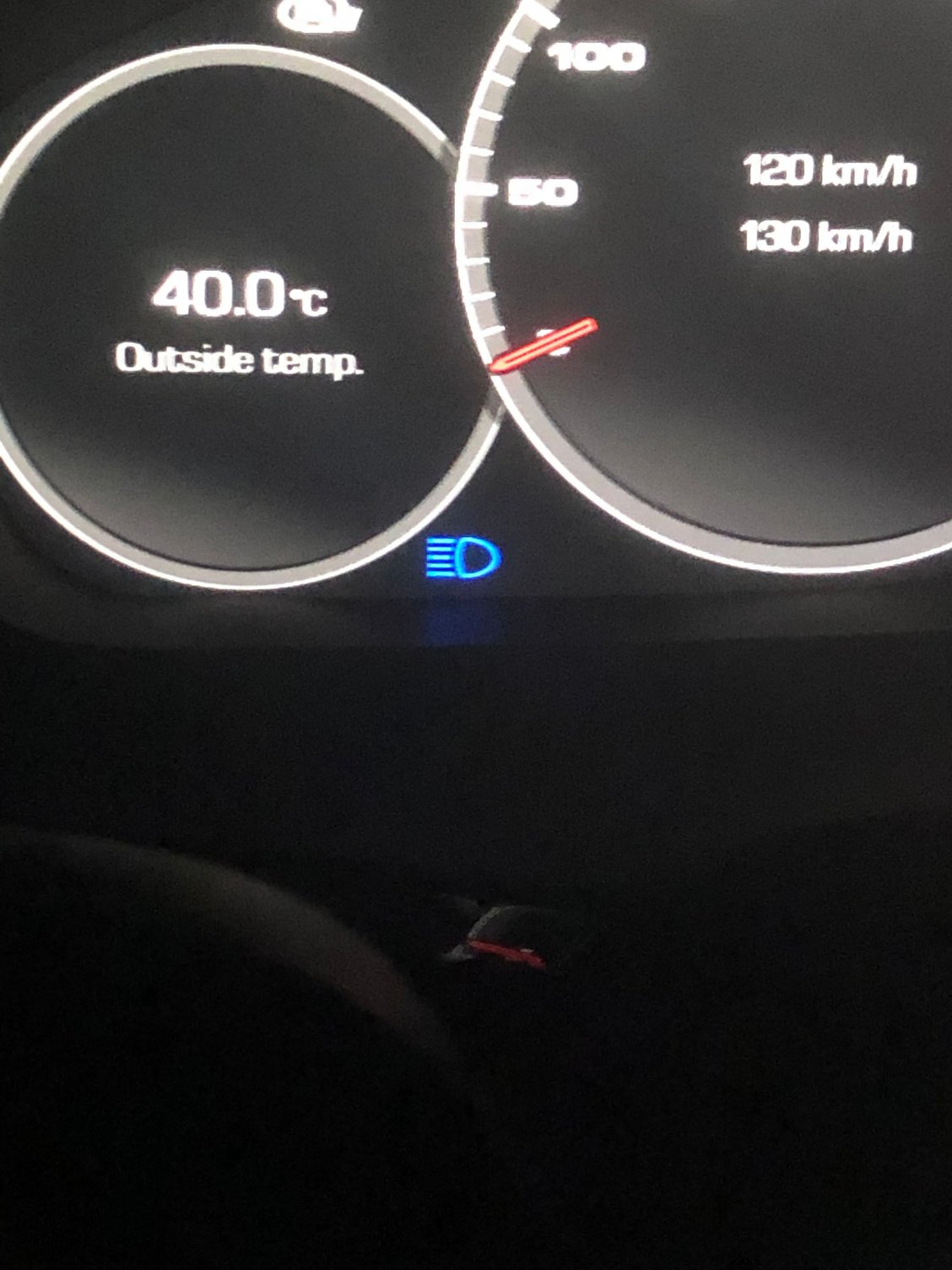

When I switch to high beam the icon of the high beam replace the Auto beam ,not like the video shown .? Does that means my pdls+not active ?

You should leave your headlights set to Auto (green icon with “A” in the middle). I always drive with mine set to Auto. The lights will be dimmed until the system detects a dark road with no vehicles. The system will then automatically set the lights to high beam. Your display will show both the green “Auto” icon and the blue high beam icon simultaneously as indicated in the screen grab from the video, below. When a car approaches you, the system will automatically dim select LEDs in your lights to form a dark spot just around the approaching car. When the car passes, the LEDs will again illuminate the entire roadway.
When you manually override the Auto setting and switch to high beams, you will not have the auto dimming feature active. This can be useful when you need more light in areas with streetlights.
