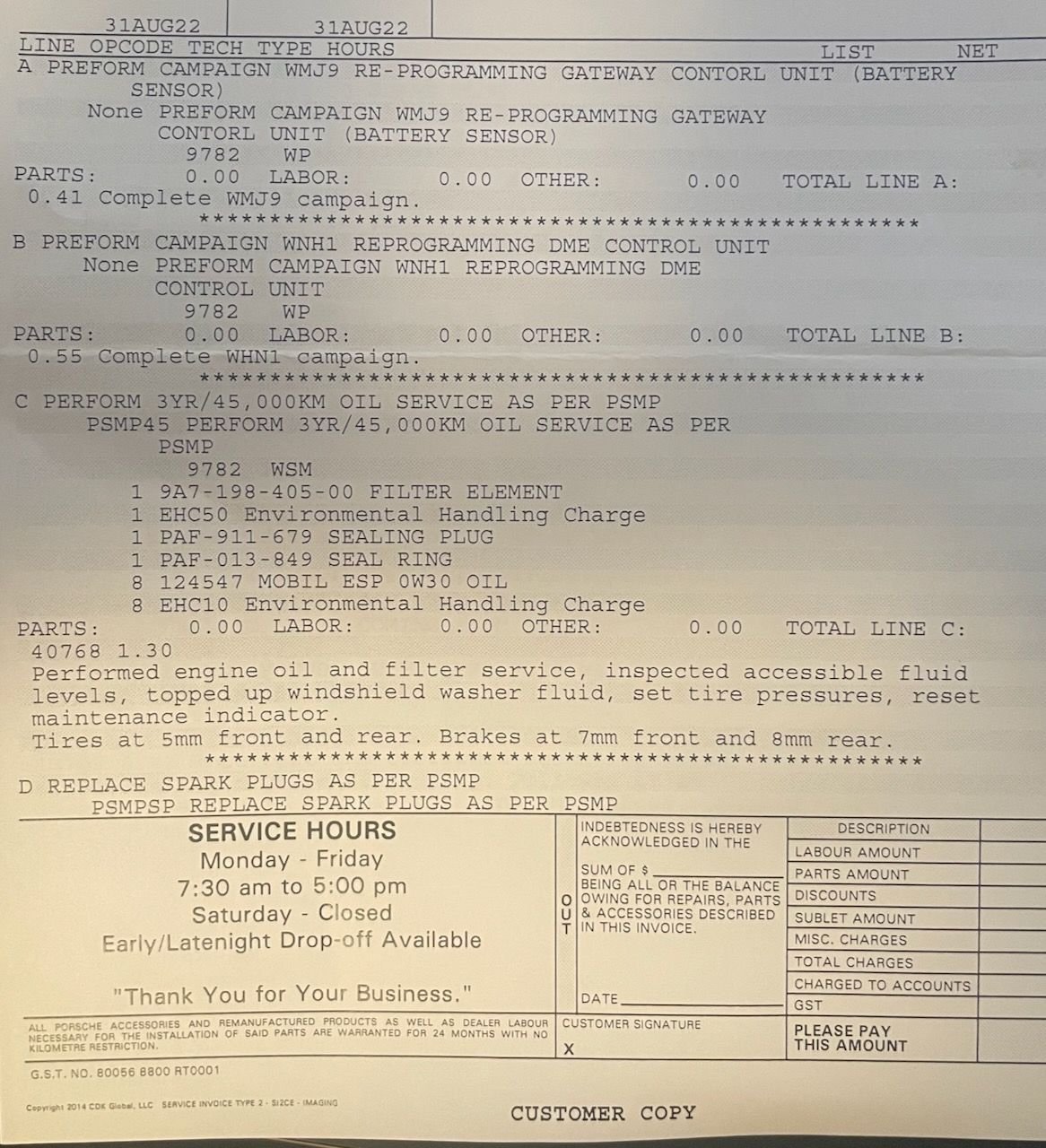

Hallelujah! I took my 2020 Cayenne S in for the 25k mile service today. The applied software updates fixed the obnoxious AS/S downshift issue. The difference is wild. The dealer also identified and remedied a squeaky exhaust flap that was an oddity. Very pleased.

The line item on the service invoice germane to this issue was the "Campaign WNH1 Reprogramming DME control unit". A quick search for WNH1 gives me nothing insightful.
I've never run across WNH1 and like you turned up nothing with a search. Maybe Schnave can find something out? :-)

Service invoice dets
