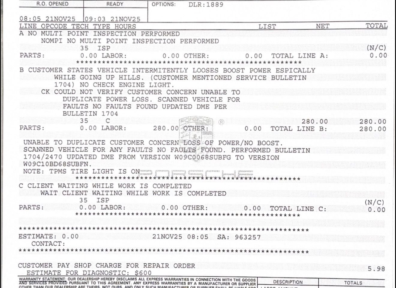

I called two local dealerships and both said they want to run diagnostics first and then - if needed - will update the software.. for $680. I'm going to keep calling around, but SoCal is a special place.
I just dealt with this at two CT dealerships. First was insistent on full diagnostic at ~$650 and would not accept that there is significant community evidence and a TSB to simply check the software version and update.
Initially, I had similar stance from the second dealer but they compromised with me to charge the time to perform the update after being very persistent about the community experience around this issue, the existence of the TSB, and harping on the "previous bad experience" I had at the first (competing) dealership. Of course, they were "unable to confirm issue" despite my videos, but my software was in fact out of date and the update made a significant and positive change. I paid for 1 hour of work ~$305 total.
I have some more details in this thread https://rennlist.com/forums/cayenne-...o-issue-3.html

for reference in case it helps anyone's cause:
Note: Loss of boost is typically when vehicle is very warm, like 1 hour+ of highway driving. There is almost no way a tech will be able to verify the issue on a test drive.
car was warm from having just driven it there and arranging "while you wait" service appointment
i also disagree with you, this problem manifested at any engine temp.
