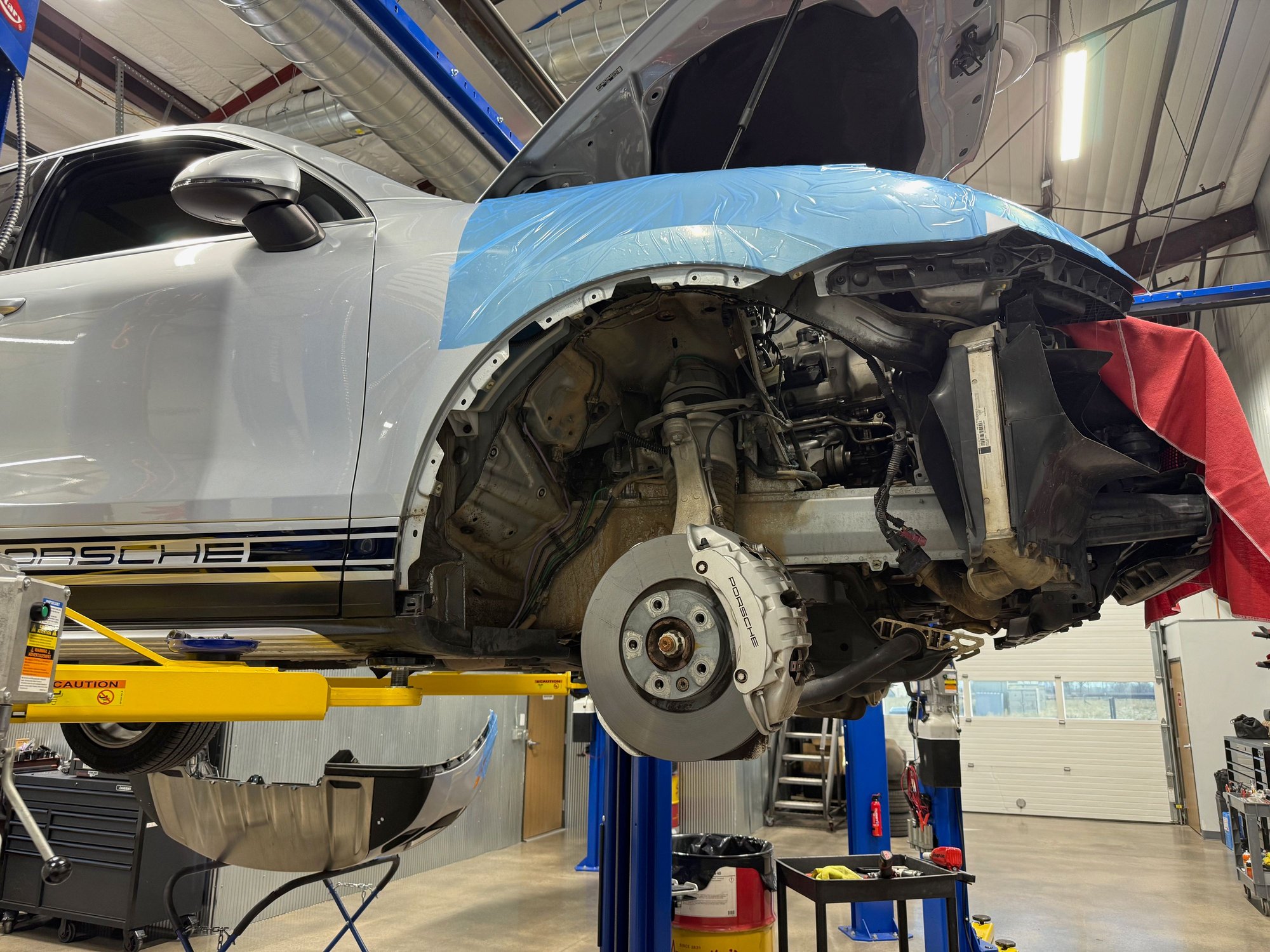

Well, it's a work in progress. The exterior is done -- paint correction, PPF, and side decal. But the engine has several oil leaks, as is typical for these vehicles.
I'm really excited for the finished product, but make no mistake. Addressing the deferred maintenance plus the off-road mods will cost more than I paid for the vehicle itself. I knew that going in, and I'm totally fine with it.

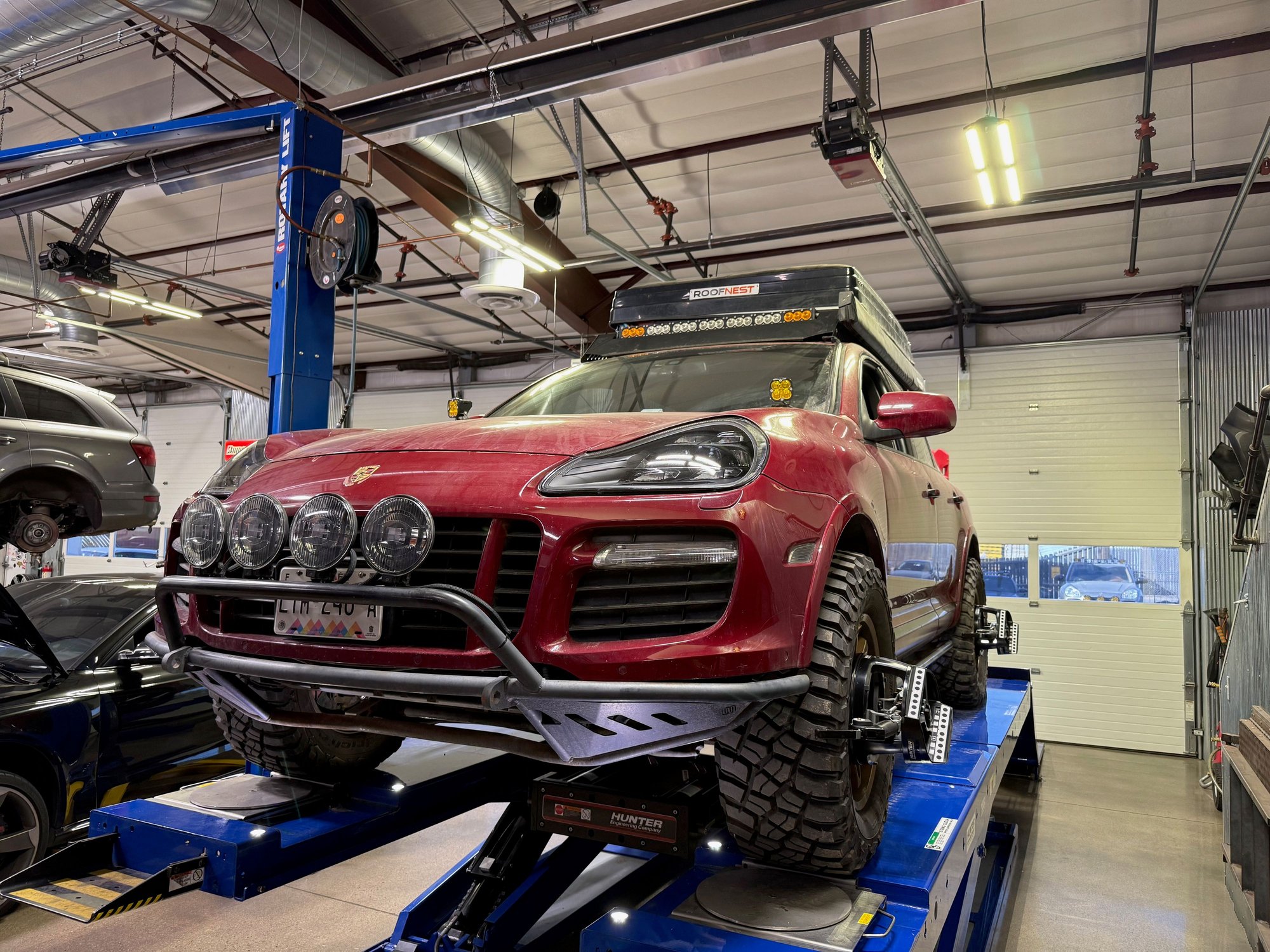

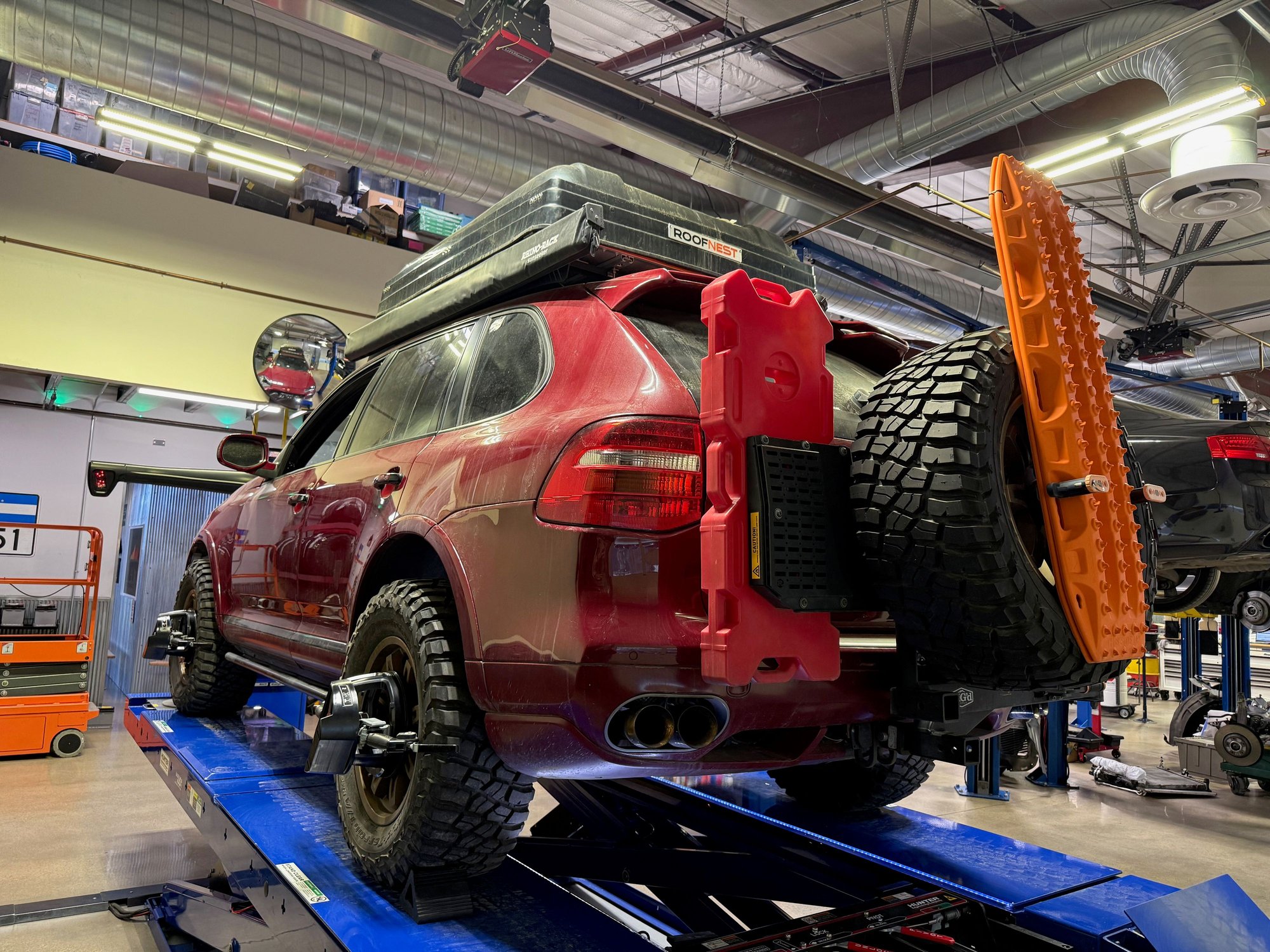

These photos will give you a sense of what's possible with off-road build Cayenne. This owner drove his Cayenne up from Mexico to have it serviced here in Denver. That should tell you something about their reputation.
They are ripping out some previous mods that simply didn't hold up, and replacing them with their own product.

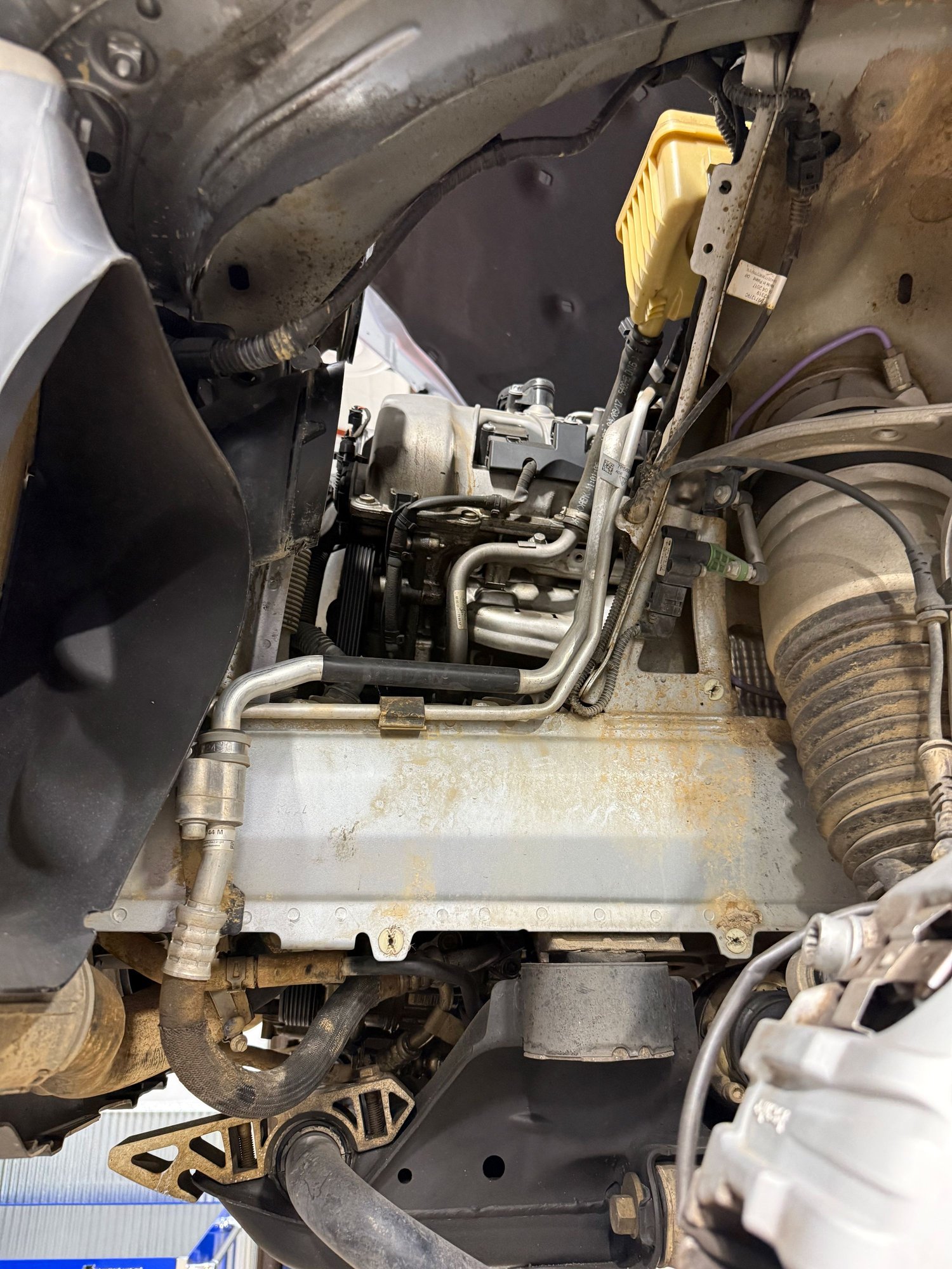

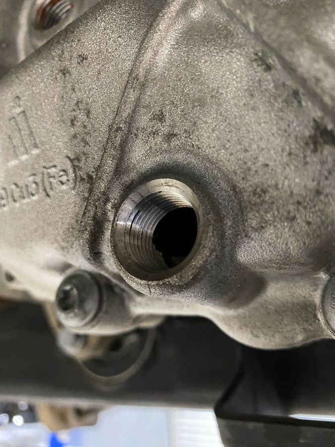

I posted this in another thread, I'll add it here too. Looking for a used Porsche? Well, caveat emptor (buyer beware)!
The transfer case was replaced by Porsche of North Huston in June of 2022 at 32,000 miles, but they did a ^%*# job of it. Looks like they over tightened the plug and cracked the transfer case housing. So, it's getting replaced *again* at 50,000 miles. Even when you have the service records and it's been serviced at a dealership, there's no guarantee... My shop reached out to the dealership, and they refused to do anything about it. They said "out of warranty" (which it is), but they did poor work and wouldn't stand behind it.
You've all been warned.
