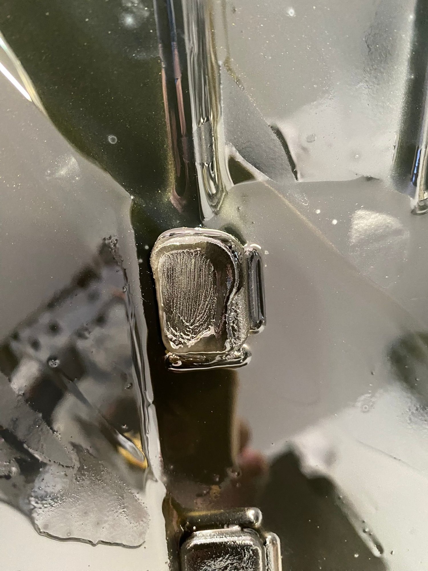

Goo on the pan magnets:

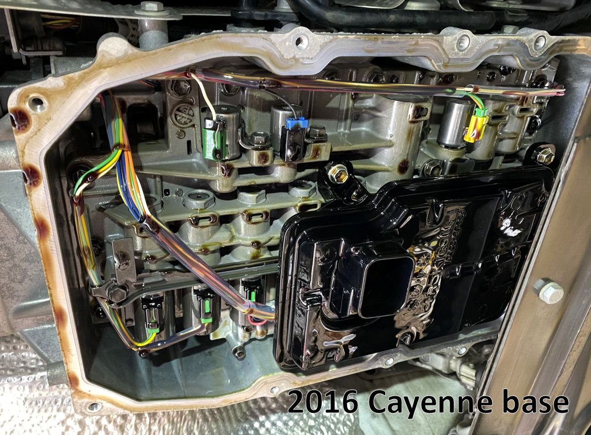

Pan removed:

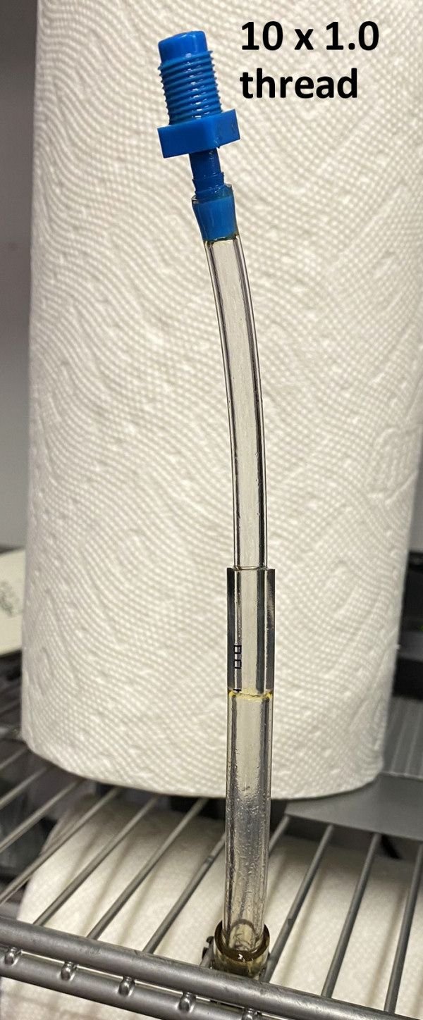

Cleaned up pan. The drain/fill hole is where a plastic insert is installed that sets the proper fluid level, at a specified fluid temperature. I was measuring the pan temperature (instead of using a scanner to get temp off the CAN bus), and it went up fairly quickly (engine idling) so I put the drain plug in and had to turn the engine off and let it cool a bit to continue the drain sequence.

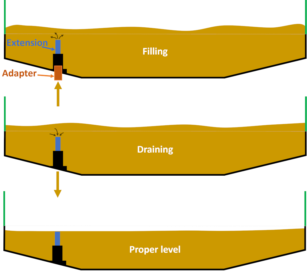

It's a bit confusing but I think you have it correct. There is a plastic 'extension' already installed in the pan. You remove the extension (blue) so all/most of the fluid drains out. Then you reinstall it before/during filling. In addition to the extension you need an adapter (orange) to allow fluid to be pushed up into the pan. The adapter mates the hose (with fluid) to the 10 x 1 threads in the pan. See the cartoon below - it should help.
When fluid stops coming out, it has reached the top of the extension and is the proper level (assuming temperature is correct). I just did a transmission oil change on an IS 350 and it used the same procedure except they have distinct fill/drain and drain-to-level fittings.

Not sure what "it" is in this context. If you are referring to the extension, it is removed from the outside. A hex goes up inside the drain hole and is inserted into the blue extension to remove it. Here's a cartoon of approximately what it looks like in a cutaway view.
