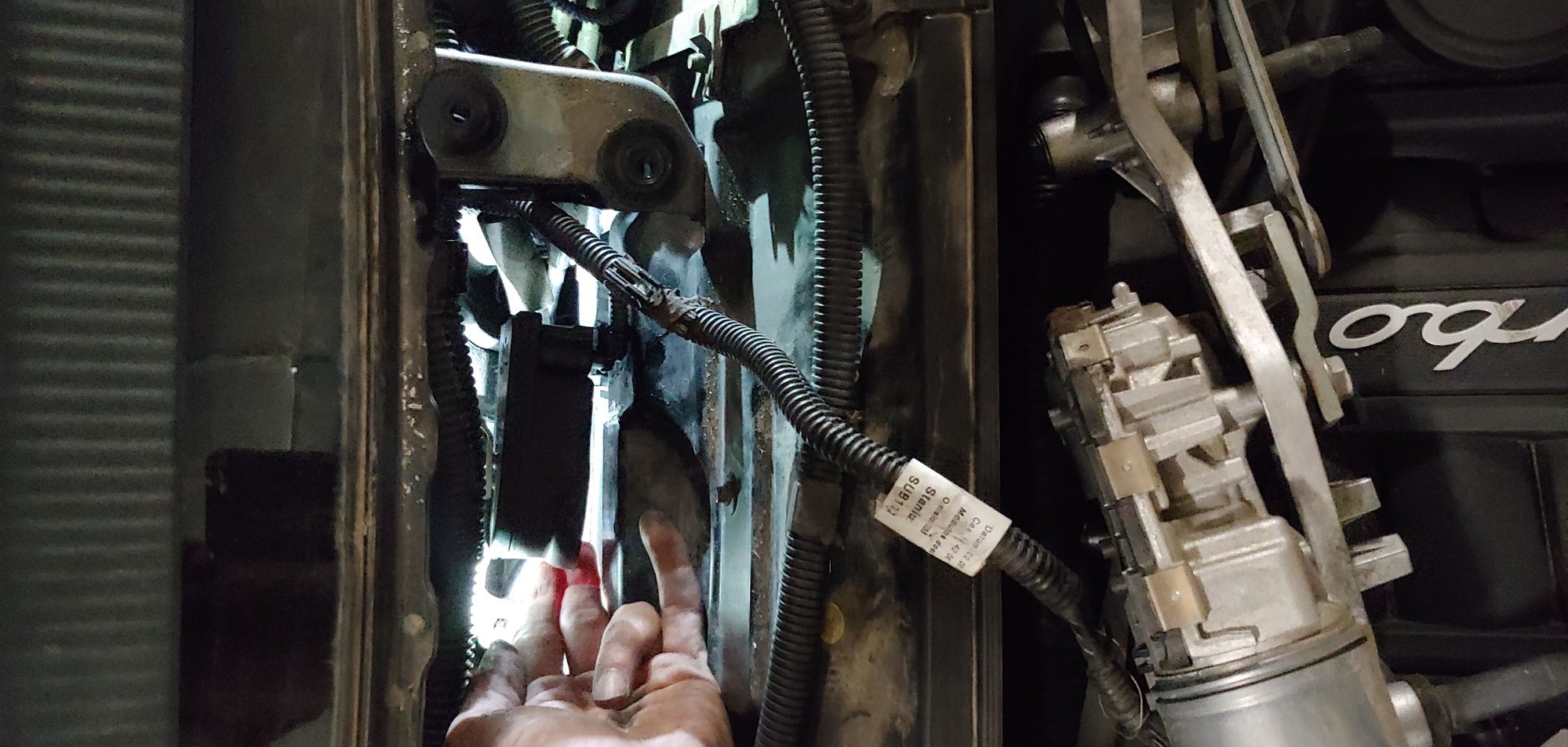

Got my 2011 CS (105K miles) back in August and like has been noted here, was surprised the 'chirp chirp' was barely audible. Not having owned a Porsche before I figured maybe that's normal. My alarm was working fine until a month ago. It started doing the flashers thing either immediately, or maybe after a minute or two when activating the alarm. Got a siren module on eBay from a parted out Cayenne (74K miles) for $40 . The new part number is 1K0951605C. Thanks to the very nice write-ups and DIY articles here from Rennlisters, got the siren module installed and works like a charm, and the 'chirp chirp' is much louder.

I ended up replacing my Faulty Alarm Siren on 958 Turbo, its a bit of a pain to get to, but not something you can't do in 2 hours. When I locked the doors the flashers would go off. Only way to stop it was to leave a door open and unlocked.
Make sure you have the tool that pops out the wiper arms
Must remove the wiper motor assembly 5 bolts in total

So I can also confirm, I have a 2011 CTT and the hazards started coming on when locking, I should have realized it was coming based on this thread, because over the last months I sometimes wasn’t getting an alarm chirp when I locked it. Anyway, I changed the siren and it’s back to normal. Total cost $34 for a used part. It took me about 3 hours to do, and there’s no programming needed, just plug it in and it fixes it.
I wouldn’t call it hard, but it isn’t pleasant either. The thing is jammed in there pretty good with wiring harnesses and stuff around it. Like others, I found it MUCH easier to remove the 2 10mm nuts and take the bracket away from the firewall so I could more easily get to the 13mm nut on the siren itself. there are tons of YouTube videos on how to pull wiper arms, I just used a universal puller tool, not a “wiper specific” tool and it worked fine.The plastic cover to the area is a pain in the butt to get out, but like others say just pull up straight on the corner to get it going. It’s tightly fit in a channel along the bottom of the windshield, that’s what’s so hard to break out. I did put the hood back further by disconnecting the strut. All in all, not the worst job, just a bit tight and annoying around the siren module. Oh, and I think for me the toughest part was the single star bolt on the wiper motor bracket on the drivers side. It was awkward with the hood location to get in there easily with the normal tools I have, but they are not on very tight, so it could be worse.
