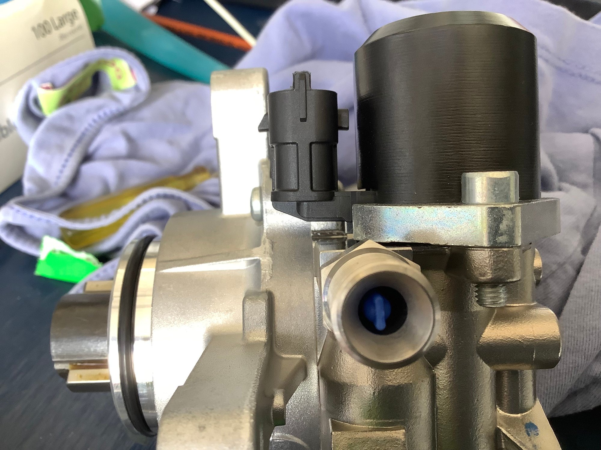

Help, what is this little blue internal plastic part? Do I remove it before installation? Can’t seem to find any information on it. It is in the low pressure fuel connection of my new OEM HPFP. Cheers!

leave it!!

Originally Posted by garrett376
leave it!!
Thanks I did.
