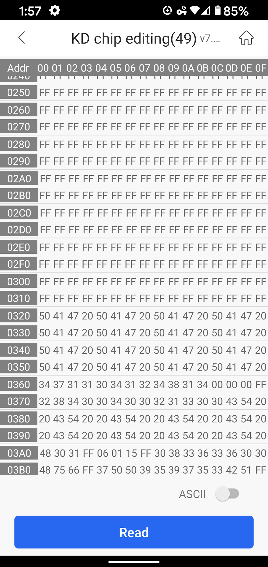

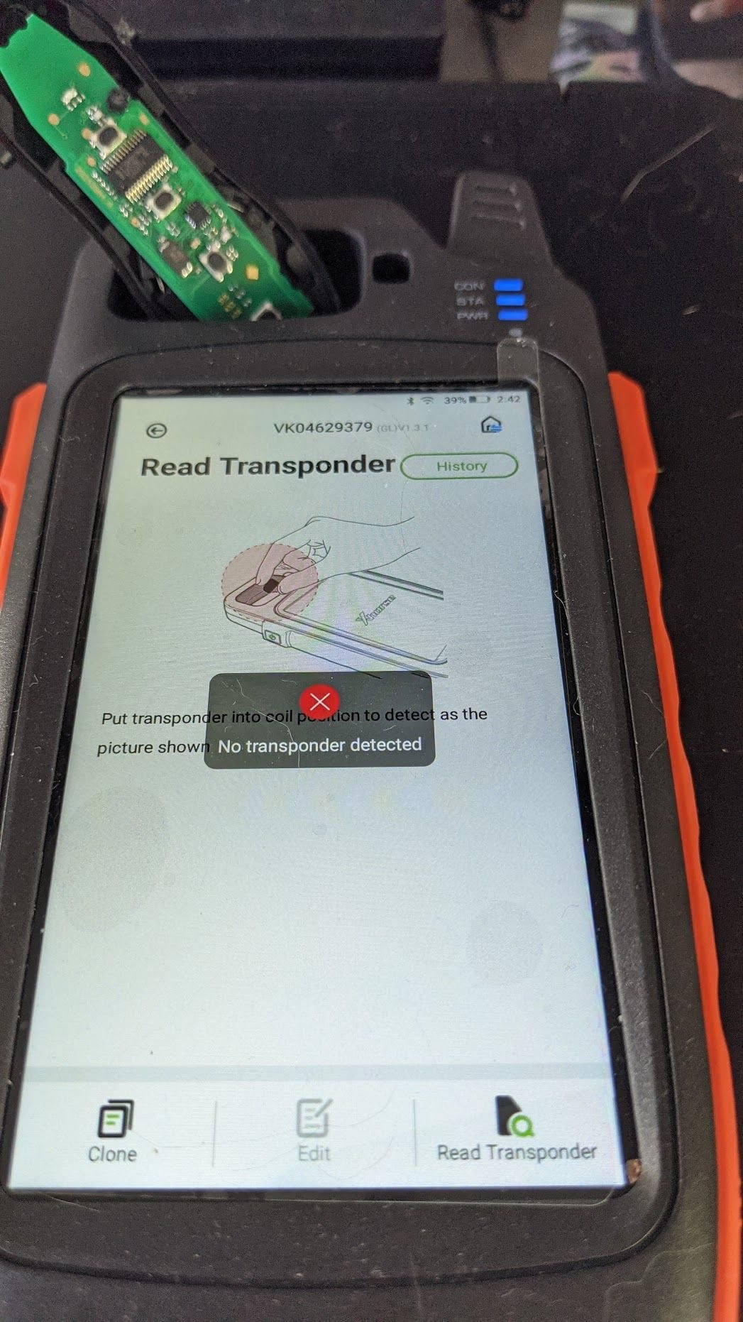

I purchased a BQ key off ebay that's supposedly for cars with enter and drive. it came locked but I was able to clear it with the KeyDIY unit. I have so far been unable to use the Darkhorse key programmer to do anything but read keys and give some general info.
If you travel down this road again, save the money and go with the cheaper KeyDIY unit. Also, just an FYI if you try to use the KeyDIY cables with the darkhorse unit, it bricks your key.
Here's a picture of the ebay key. The system board is not a clone of the Porshe key, and it's a pile of junk by the way. it fell apart when I took the sides off. I'd probably do a hard pass on them in the future.
Clear ebay key. Easy as pie.
Cleared keys eeprom in ASCII
Could these dumps contain the programming key for the Dealer to use to program them? That's what I'm going to try to figure out. First I'm going to see if my dealer is willing to program a cleared real key and present him with the two key choices and ask about the enter and drive keys.
eBay key. Might work but junk.
ebay key has a very weak transceiver you can only get a good read when you put the key part in the reader. The Porsche keys will read in either direction.
Locked BQ key.
it has the eeprom info of a BM key so I'm going to assume this key will only work with cars that do not have enter and drive.
