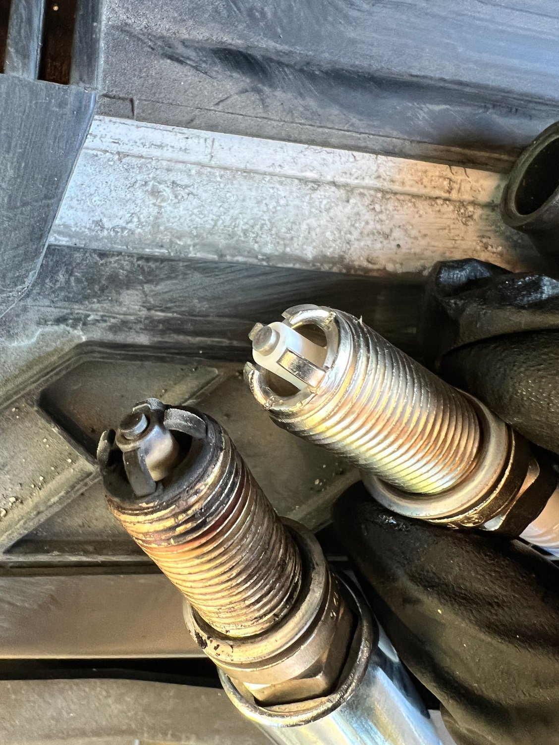

Hi,
I recently bought a 2013 GTS with similar issues: CEL, PSM failues, auto start/stop deactivated.
I replaced all coil packs with BERU and spark plugs with bosch. So far after the replacement, I have driven ~30 miles only in 3 different days and all is good.
Here's a ppicture of old vs new spark plugs, but I don't know how many miles were on the old spark plugs.
old vs new
old spark plug

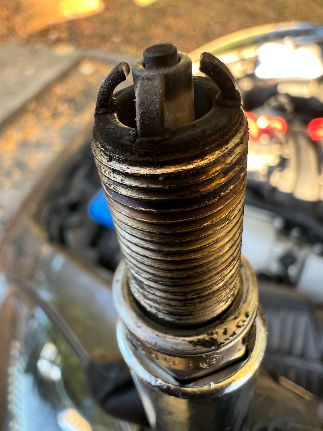

First CEL I got was P0303 Misfire cylinder 3. I replaced all 8 plugs - I suspect the plugs I pulled out were stock but not 100% sure.
old spark plugs
Car drove fine for a while, still had a few things on the TLC list, including eventually coils.

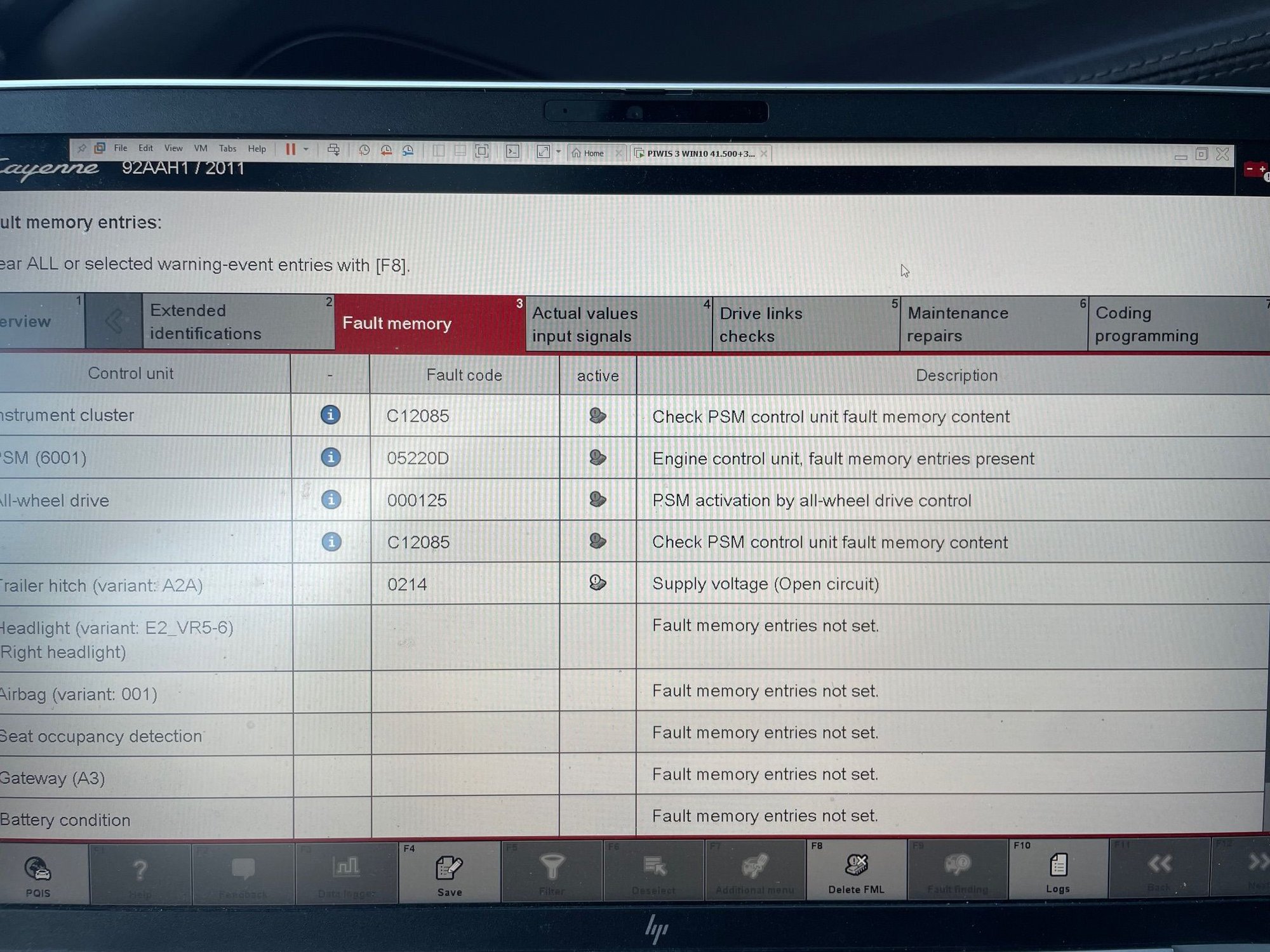

Hello, I am possibly facing the same issue as you all experienced.... But am eager to know how to use PIWIS 3 for this, I tried hard but I have no clue how to deal with PIWIS..... I am a former e46 owner used to use diagnostic tools a lot . But I really can't deal with this PIWIS.
Car is 958 Cayenne S ´11 and my symptoms are:
Long crank
PSM light
disabled start stop
rought idle (Skoda fabia owners would not consider it as rough )
yellow CEL light (not every time)
so I got myself an PIWIS 3 diagnosis with the help of this topic https://rennlist.com/forums/997-foru...only-75-a.html but really can't deal with it.
Just because I know, that our engines eat coils and spark plugs like hell, I assume that this is my problem too, but how do I actually confirm it with PIWIS? I tried every module "fault finding" but did not get any relevant answer. I did not start engine tho. Can somebody help me please? How do I find misfire logs?
