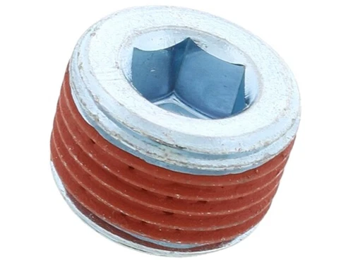

Some say use a sealant on the threads. I'm just going on what google says (and doesn't bottom out). Makes sense.
S-TEC Transfer Case Plug 95530111501 Porsche Cayenne Macan

I used new plugs which came with thread sealant. Now that I think about it, when I removed the plugs, the fill plug had to 'crack loose', but the drain plug just backed out without an initial crack.
