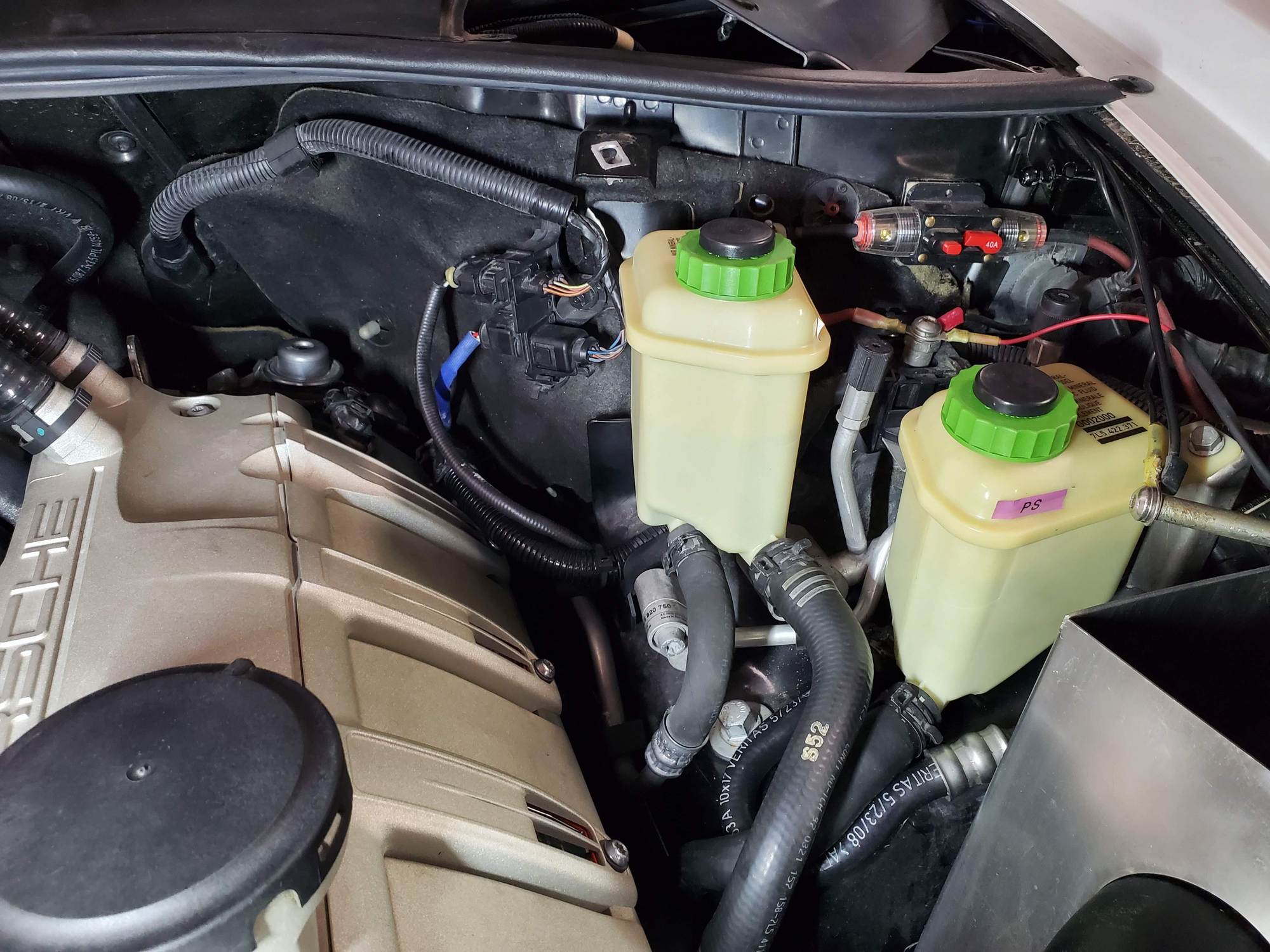

Either the air level system or the PDCC system can throw that code. First thing I'd check is the fluid level in the PDCC reservoir. You'll need to remove the driver's side beauty cover in the engine bay to see that 2nd reservoir that's behind the one for the power steering that looks identical. Those 2 reservoirs feed a tandem hydraulic pump that can be damaged if one of those reservoirs runs dry and it's a really expensive pump.
